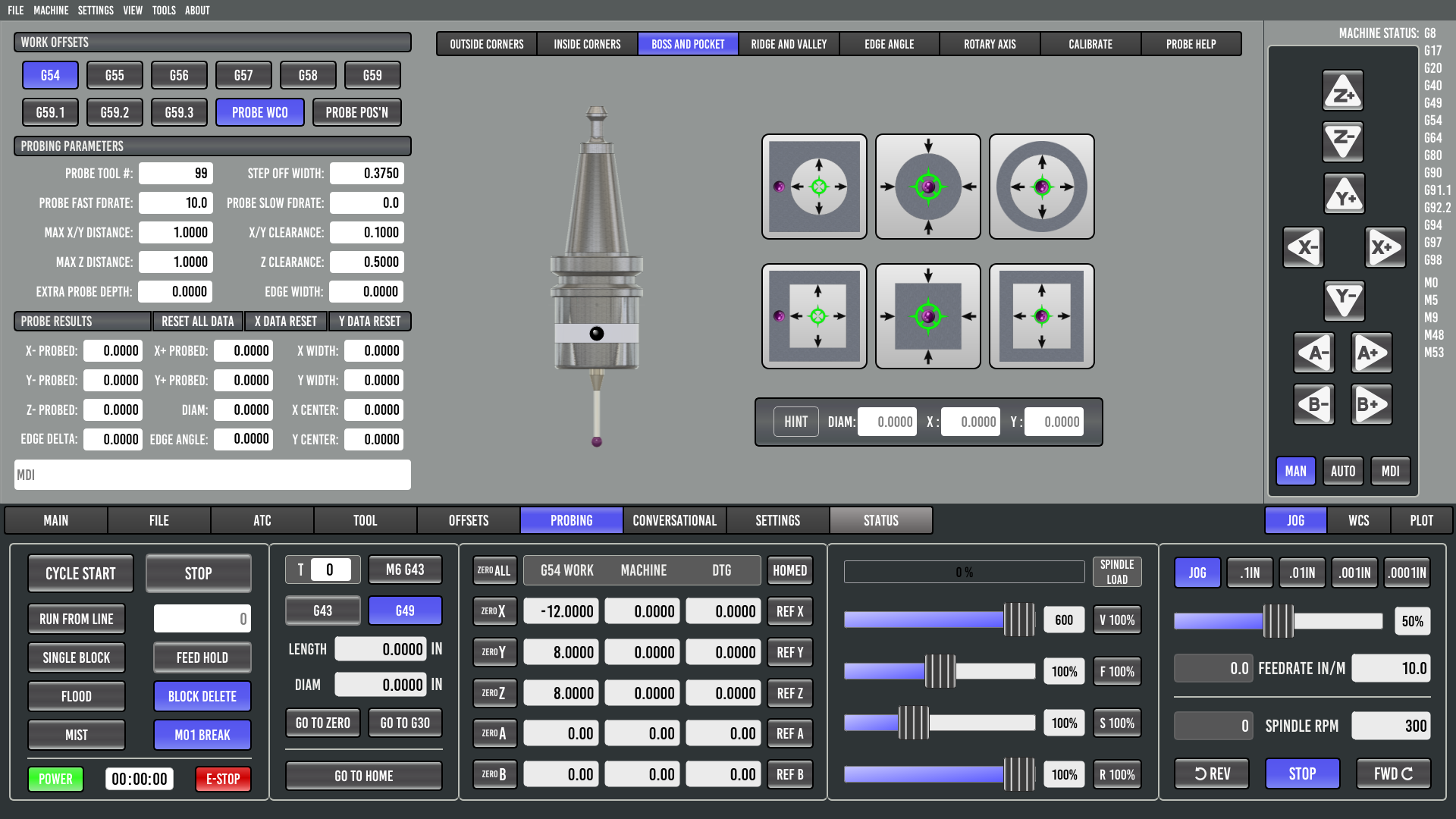

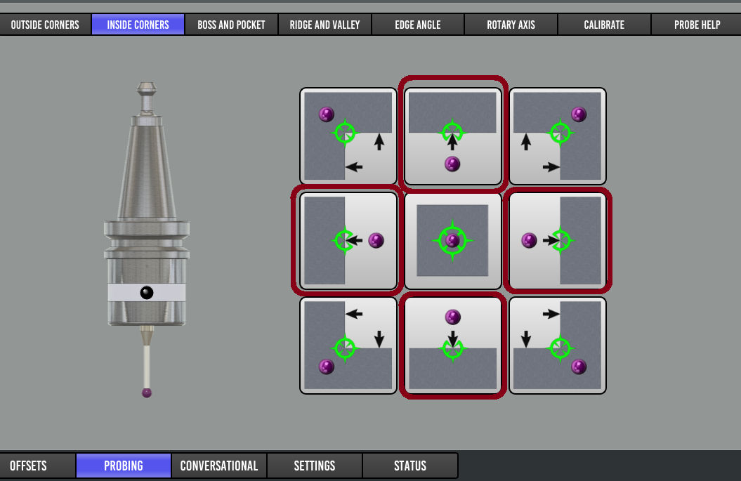

If you are trying to find the inside corner you can simply use an x and y probing function. The all in one routines are designed for simplest in all 3 axis, but for 2 wall touches only the just hit the prove x+ or x- and same for y. It's a basic go left or right or fwd or back, probe and step back.
The hole center I agree I need to add a none z, start from hole center routine, and it's on my running list of things to get to. In the interim you can also modify the subroutines to suit your requirements.
Also note the "probe wco" and "probe pos'n" buttons, I use this frequently when I want a hole center for X and Y but want to use the parallel top as my Z work height offset. I'll set to probe wco and use a Z probe on the parallel, the pot my part in the vise and set to probe pos'n to find a hole center, then manually zero the dro for X and Y.

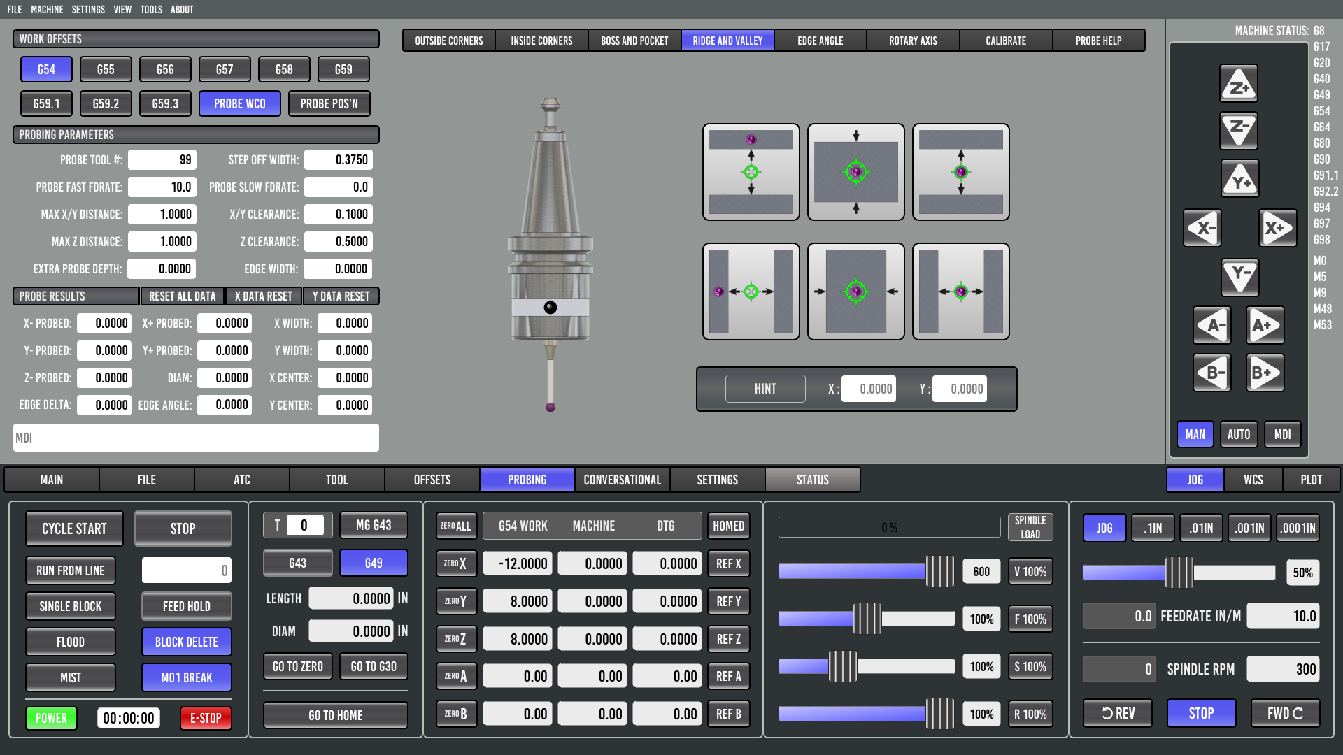

I had some time last night and have added some new multi-touch probing routines based on the feedback, they probe on a single plane only in Z and they are for probing circular pockets (holes), rectangular pockets, and valleys in X and valleys in Y. i have not had a chance to test them yet and they have not yet been merged in to the lastest PB Master. once i have a moment to physically test them i will merge and they will be available.

all the edge probes are available without z, they are on the second page, they are just straight probe moves in a direction x, y, x-, y-
trying to traverse a boss when it has no idea where it is in space in relation to the work piece top is a crash waiting to happen. the z probe in those situation defines the traverse plane. simple probing in one direction is easy and safe enough and probing inside something where it needs no z move such as what was just added is also fairly safe. i'm not keen on adding anything where the user can forget or enter a bad parameter and potentially cause a probe crash.
I have been using a variation of these probe routines now for almost 10 years and can say without doubt they will do about anything you need for 2.5D probing. once you use the machine for a while you will find your go to probe setups that you use the most often and will setup your work in fusion or whatever cam software you use for those scenarios and it become old hat and is very efficient. for me it is typically back left corner, rect boss, circle boss, hole center, and the valleys. those are used probably 99% of the time for work coordinate offsetting. the hint method allows for really fast probing so its not moving around blind at 6ipm having to find points to make safe moves and taking 3 or more minutes to complete a routine. it really shows when you are loading large stock and using the center probe routines. try it on a ui that has to carefully find its way around a part when your part is 20" x 10" and you will fall asleep waiting for it to finish. here is an example:
