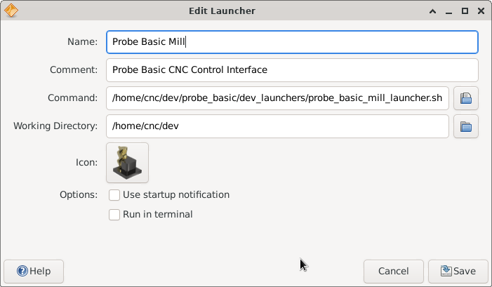

- Retrofit
- Posts: 16
16 Mar 2023 14:18 #266854
by Retrofit
Replied by Retrofit on topic How to modify Probe Basic UI
Hello
i reinstaled all , debian , linuxcnc , probe basic development install , the issue is the same , when I doubleclick the mill or lathe icon , do nothing.
The qtpyvcp icons fromdesktop can be launched.
I atach a sreenshot with the expanded launcher edit.
Thanx for help
Denis

- Lcvette
- Posts: 1682
- Thank you received: 784
18 Mar 2023 15:29 #267028
by Lcvette
Replied by Lcvette on topic How to modify Probe Basic UI
there were some path errors that got missed during our toml poetry package build conversion, they have been corrected, please delete you existing dev directory and try reinstalling, the changes should now allow for a fully functioning dev installation with the launchers working as expected!
Thanks,
Chris
Thanks,
Chris
- Retrofit
- Posts: 16
18 Mar 2023 19:06 #267037
by Retrofit
hello
I do the things that you tell , now is work fine.
i have 2 pc , one with dev install , and another with machine install.
Thanx a lot for helping.
denis
