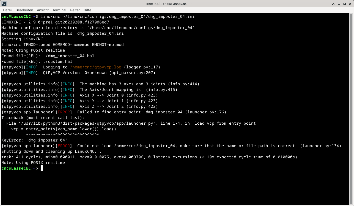

Thank you for your reply,
I did that already but forgot about it since I didnt know what to do with it...
It says the name or file path could be wrong, but how could linuxcnc load it in the first place?
What kind of file is linuxcnc trying to load hier (/home/cnc/dmg_imposter_04)?
I inspected the launcher.py file, but really dont know what do do with that.

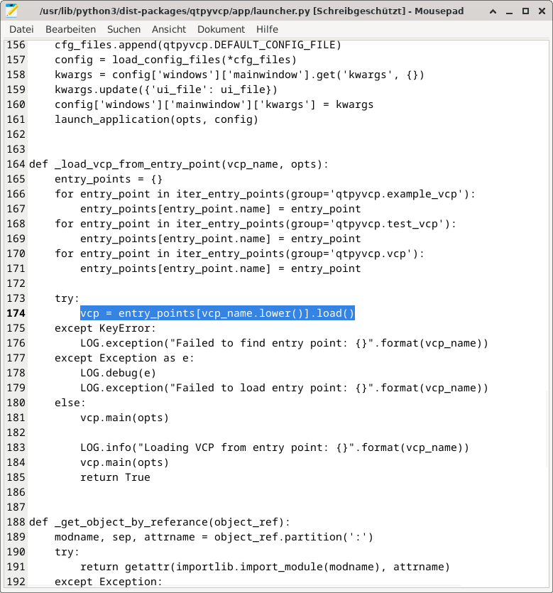

I wonder if there is a problem with the fact that the launcher is converting the filename to lowercase before loading it?
What files are in the dmg_imposter_04 directory?

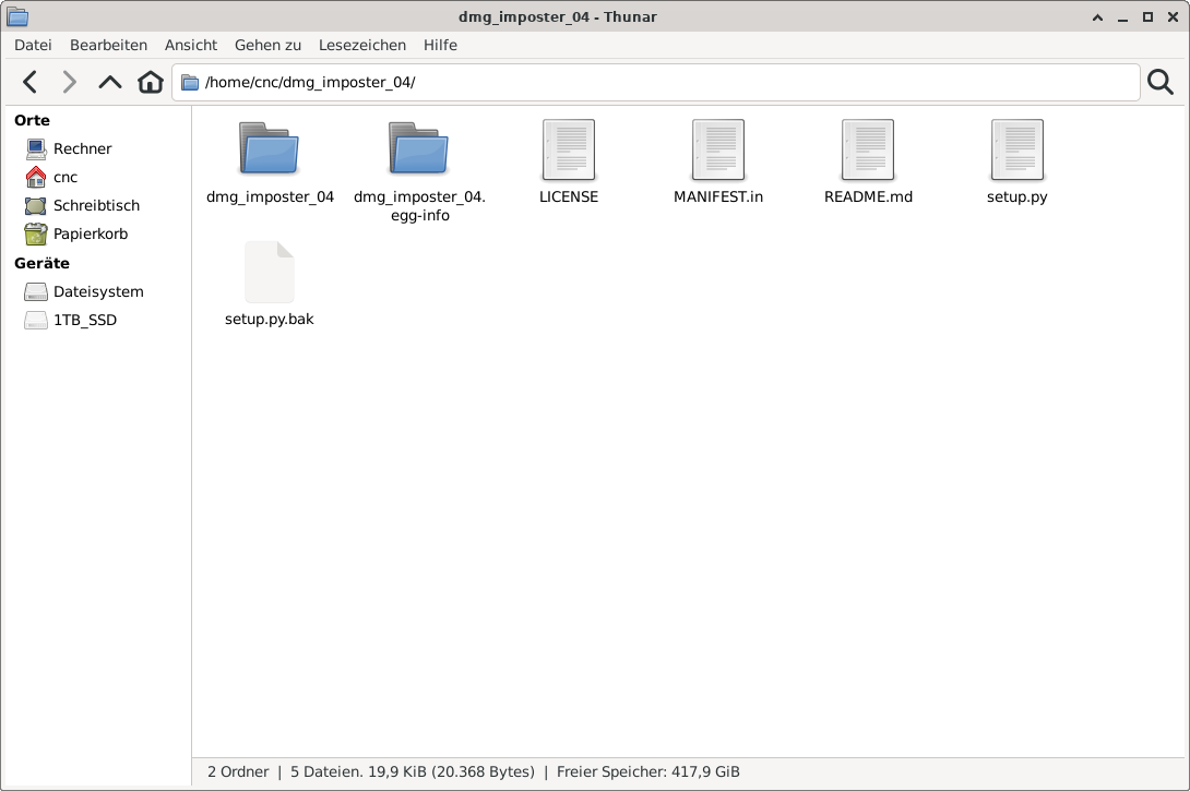

Files inside:
LICENSE
MANIFEST.in
README.md
setup.py
steup.py.bak
/home/cnc/dmg_imposter_04/dmg_imposter_04/
config.yml
config.yml.bak
_init_.py
_init_.py.bak
mainwindow.py
/home/cnc/dmg_imposter_04/dmg_imposter_04/resources/
resources.qrc
/home/cnc/dmg_imposter_04/dmg_imposter_04/ui/
mainwindow.ui
style.qss
/home/cnc/dmg_imposter_04/dmg_imposter_04.egg-info/
dependency_links.txt
entry_point.txt
PKG-INFO
SOURCES.txt
top_level.txt
/home/cnc/linuxcnc/configs/dmg_imposter_04/
custom.hal
dmg_imposter_04.hal
dmg_imposter_04.ini
dmg_imposter_04.ini.bak
linuxcnc.var
linuxcnc.var.bak
postgui.hal
README
sim_hardware.hal
tool.tbl
These are all files i could find.
Thank you for your time!
