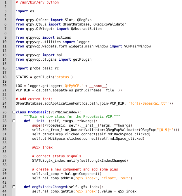

- DauntlessA
- Posts: 24
- Thank you received: 5
23 Jul 2023 02:16 - 23 Jul 2023 23:15 #276048
by DauntlessA
Replied by DauntlessA on topic Creating custom HAL pin in QtPyVCP
Thanks so much for the help! Somehow managed to not spot www.qtpyvcp.com/hal.html.
I'm using probe_basic, so I've added your example to my probe_basic.py.
I still can't see the qtpyvcp.g5x_index pin under Hal Show, and I can't add it to a signal in my custom_postgui.hal file. Have I missed anything?
Last edit: 23 Jul 2023 23:15 by DauntlessA. Reason: Removed code insert due to excessive length and the fact it wasn't correct, adding nothing to the post. Correct code posted below.
- DauntlessA
- Posts: 24

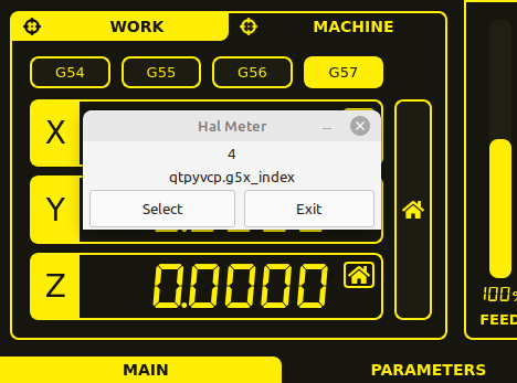

23 Jul 2023 23:13 - 23 Jul 2023 23:47 #276114
by DauntlessA
Solved, the issue was with indentation, and using tabs instead of spaces. The following worked!
Thank you, this should be very useful!
I've got a bit more work to do as g5x_index currently initialises with a value of 0 (indicating G53) and it would be preferable if it initialised with a value indicating the active work coordinate system (which is persistent across restarts in my case). This means that initialising with the stored value could be an option (although there may be simpler ways).
Last edit: 23 Jul 2023 23:47 by DauntlessA. Reason: Discussing followup without cluttering thread
