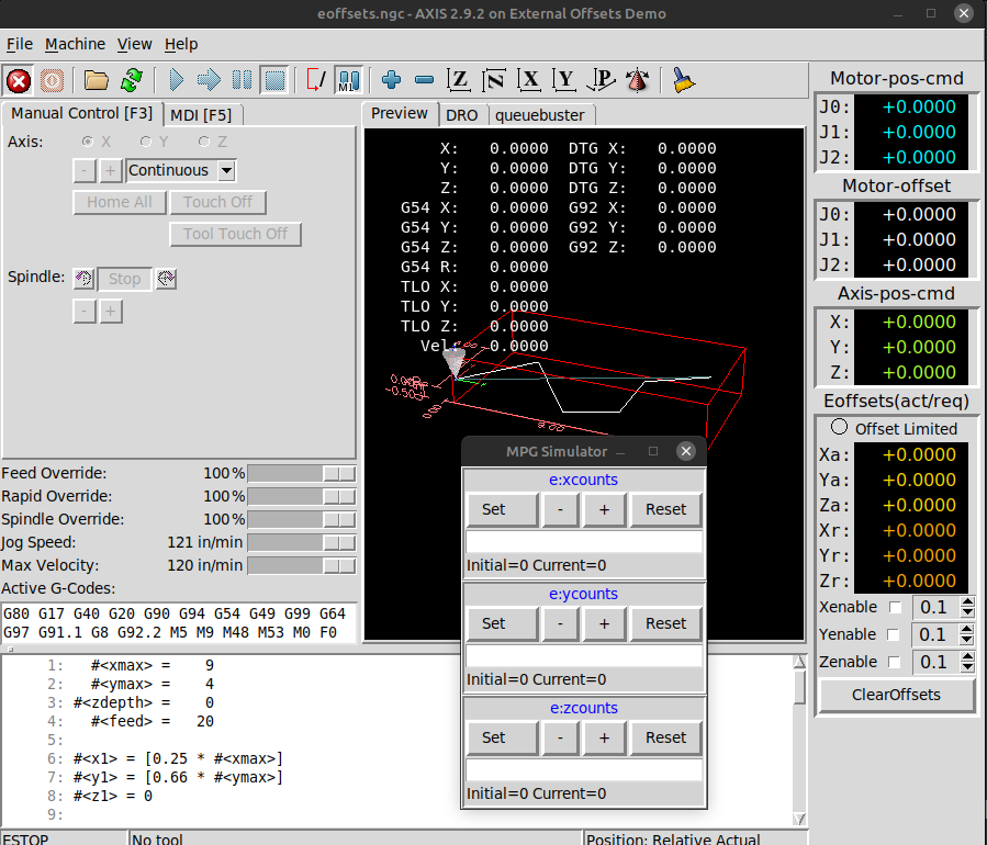

Hello everyone!
I am very inexperienced in this field and I am attempting to develop a project. The basic premise is that I want to deposit material from a cnc machine fitted with an extruder on its end effector onto a free standing object. As the object is free standing, it may occasionally inadvertently move causing the predetermined toolpath (original g-code) to deposit material in the incorrect position. As a remedy, I am working to add cameras which can track the object being operated on and any movement will be tracked and it will automatically adjust the toolpath so that it does correctly print regardless of toolpath. I currently use mach4 to operate the machine and as such, I am struggling to determine how I can in real time, adjust the inputted g-code. I came across linuxcnc and QtPyVCP which from my own understanding, enables custom applications. Can anyone give me a sense of direction as to whether something like this can be implemented on this application? Thanks!

May be the 'external offsets' feature could be of interest. This will let you superimpose offsets to any axis through hal pins (ie outside of GCode) while the program is executed. LinuxCNC plasma applications use this to regulate the torch height on the sheet metal.

This is very interesting. Would I need additional controllers or components to enable this external offset feature or could I run this directly from LinuxCNC? Has this type of feature been explored on multiple axes simultaneously? Thanks for the response!

No need for additional controllers but you would likely need to write a custom hal component to get your machine vision results into hal.
There is a simulation configuration 'configs/sim/axis/external_offsets/eoffsets' with external offsets for X,Y,Z axes (this will also run on a non-real time installation):
