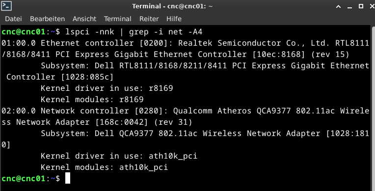

- Posts: 18115
- Thank you received: 5334
24 Oct 2024 13:51 #313085
Replied by PCW on topic Unexpected realtime delay on task 0 with period 1000000
rtt min/avg/max/mdev = 0.044/0.061/9.253/0.062 ms
The 9.253 ms is the issue
I suspect you have Realtek Ethernet hardware so need to install the DKMS driver

- Jensner
- Posts: 151
- Thank you received: 28
24 Oct 2024 15:52 - 24 Oct 2024 17:44 #313102
by Jensner
Replied by Jensner on topic Unexpected realtime delay on task 0 with period 1000000
Last edit: 24 Oct 2024 17:44 by Jensner.
