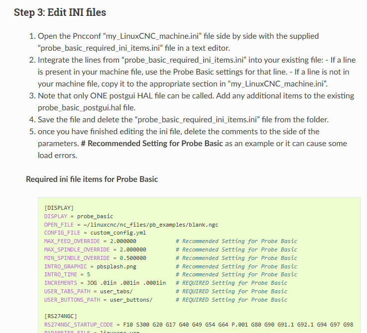

I'm working on getting PB installed. I went with the Dev version waiting for the rack toolchange updates to come through.
I'm pretty sure I did all the config stuff per the documentation page properly. I did it twice now as the first time I used my config that I had run QTDragon so when I got errors I figured I would start with a fresh axis only setup just in case.
So after going through the setup and config process, editing the files, etc, when I went to start up PB by clicking on my machines launcher it gave an error CANNOT FIND FILE FOR:custom.hal which was removed per instructions.
In the ini I added the lines in the instructions but it doesn't say to remove HALFILE = custom.hal so I didn't.
I can add custom.hal file back in or comment out that halfile line and restarting it will load to the next set of errors.
Next error I got was
FileNotFoundError: [Errno 2] No such file or directory: '/home/shopbot/linuxcnc/configs/Shopbot/linuxcnc.var'
So I changed file probe_basic.var to linuxcnc.var assuming that's all that was needed.
At this point it loads to the PB screen and a pop up with this error comes up.
[/code]
Traceback (most recent call last):File "/usr/bin/probe_basic", line 8, in sys.exit(main())^^^^^^File "/usr/lib/python3/dist-packages/probe_basic/__init__.py", line 20, in mainqtpyvcp.run_vcp(opts, VCP_CONFIG_FILE)File "/usr/lib/python3/dist-packages/qtpyvcp/__init__.py", line 26, in run_vcprun(*args, **kwargs)File "/usr/lib/python3/dist-packages/qtpyvcp/app/__init__.py", line 129, in runlaunch_application(opts, config)File "/usr/lib/python3/dist-packages/qtpyvcp/app/launcher.py", line 78, in launch_applicationloadWindows(config['windows'])File "/usr/lib/python3/dist-packages/qtpyvcp/app/launcher.py", line 230, in loadWindowswindow = _initialize_object_from_dict(window_dict)^^^^^^^^^^^^^^^^^^^^^^^^^^^^^^^^^^^^^^^^^File "/usr/lib/python3/dist-packages/qtpyvcp/app/launcher.py", line 210, in _initialize_object_from_dictreturn obj(*args, **kwargs)^^^^^^^^^^^^^^^^^^^^File "/usr/lib/python3/dist-packages/probe_basic/probe_basic.py", line 53, in __init__self.load_user_tabs()File "/usr/lib/python3/dist-packages/probe_basic/probe_basic.py", line 87, in load_user_tabsuser_tab_folders = os.listdir(user_tabs_path)^^^^^^^^^^^^^^^^^^^^^^^^^^FileNotFoundError: [Errno 2]
No such file or directory: 'user_tabs/ # REQUIRED Setting for Probe Basic'
User tabs is in the folder so I'm not sure what to do here.

- Lcvette
- Posts: 1682
- Thank you received: 784
12 Feb 2025 22:07 - 12 Feb 2025 22:09 #321413
by Lcvette
Replied by Lcvette on topic Setting up Probe Basic on my machine questions and issues
JOG is required but metric increments can be used I'll
Try commenting out the usertabs ini setting
Delete custom Hall file in ini

- yoshimitsuspeed
- Posts: 98
13 Feb 2025 14:20 #321478
by yoshimitsuspeed
Replied by yoshimitsuspeed on topic Setting up Probe Basic on my machine questions and issues
Ah progress. I commented out usertabs and relaunch it does the same for
raise IOError('The specified POSTGUI_HALFILE does not exist: %s' %
OSError: The specified POSTGUI_HALFILE does not exist: /home/shopbot/linuxcnc/configs/Shopbot/probe_basic_postgui.hal # ONLY 1 postgui hal file can be called at launch
Then between your comment being included in the error and then I noticed in Geany they were not red like other comments I tried deleting the # recommended/required comment after the lines that were throwing errors and the errors went away.
- yoshimitsuspeed
- Posts: 98
13 Feb 2025 14:59 #321480
by yoshimitsuspeed
After removing # comments throwing errors PB still wouldn't switch the power on so I went and deleted all the # comments on lines after code and now it seems to be working properly.
I am used to code that accepts comments after code lines like that so I figured it would be best to keep it in there for reference but it didn't work till I deleted them all.
I suppose I could have tried putting them above or below if I cared enough. I assume that would work.
