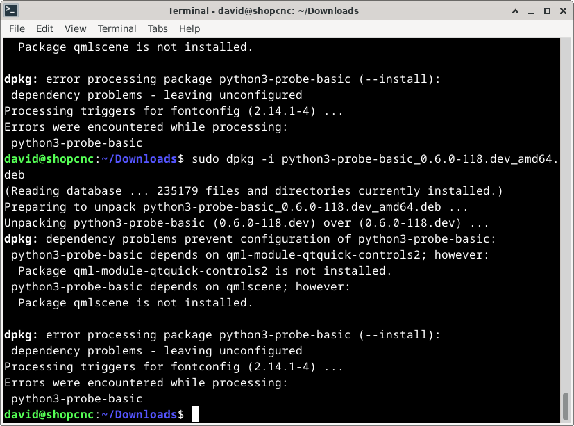

Well I tried again with a fresh LCNC install and I got almost all the way through the Probe Basic install.
Got this error on the last installation command: sudo dpkg -i python3-probe-basic_0.6.0-118.dev_amd64.deb
I looked for the application and found it but not a debian version.
Surely something is wrong with the instructions if I'm having this many issues.
Last edit: 19 Oct 2025 01:49 by DavidR8. Reason: clarity

19 Oct 2025 16:05 #336712
by Lcvette
Replied by Lcvette on topic New Probe Basic install - error during install.
Are you trying to install a dev work station or just a machine control? If a machine control, use the apt installation.
kcjengr.github.io/probe_basic/stable_quick_start_apt.html
The following user(s) said Thank You: DavidR8
- Lcvette
- Posts: 1682
- Thank you received: 784
19 Oct 2025 16:12 - 19 Oct 2025 16:15 #336714
by Lcvette
When you see errors like the missing dependency shown in the top line of your screen shot, those are what stop the installation from proceeding. While installing, if you encounter those, you can auto install them by running:
sudo apt --fix-broken install
which will gather all of the missing dependencies on your system and install them.
Last edit: 19 Oct 2025 16:15 by Lcvette.
