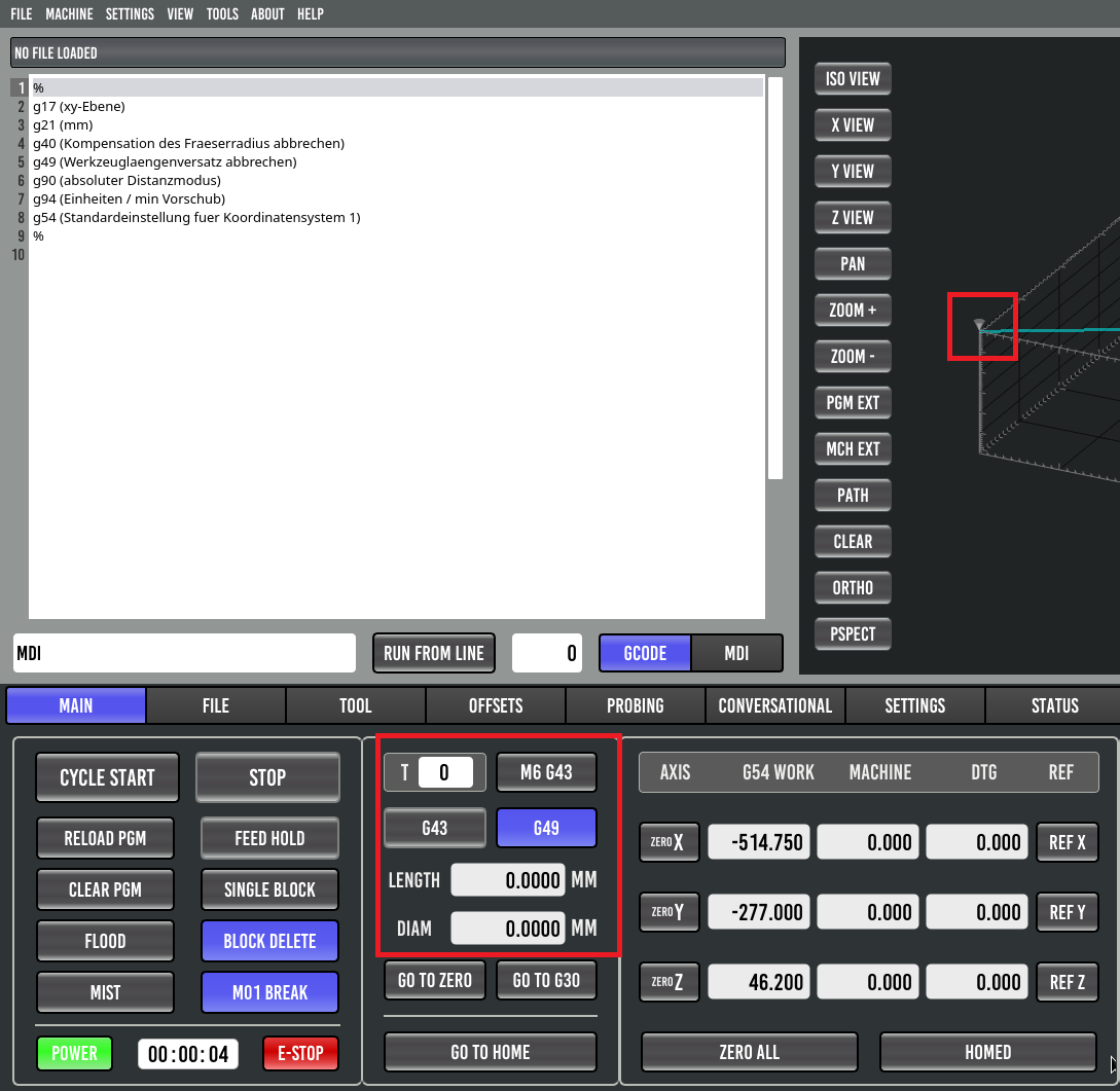

Hello forum
I've set up a new control PC and switched to EtherCAT. I'm using Leadshine EL8 components. Everything works perfectly except for the missing Tool cone.
If I have no tools loaded, the tool cone is displayed correctly.
When I have loaded a tool, the tool cone is missing..
Despite reviewing the installation instructions multiple times, I cannot find the error.

you have no tool length to draw the tool stored in your tool table. vtk draws an actual tool to display not a cone. the cone represents a point when no tool is loaded when tool is loaded the stored diameter and length draws the tool. try adding a tool length and you will see the tool.

Hi Lcvette
Thank you so much for your help, it works perfectly. Thanks also for all the work you do here every day, helping out beginners like me. Fantastic!
