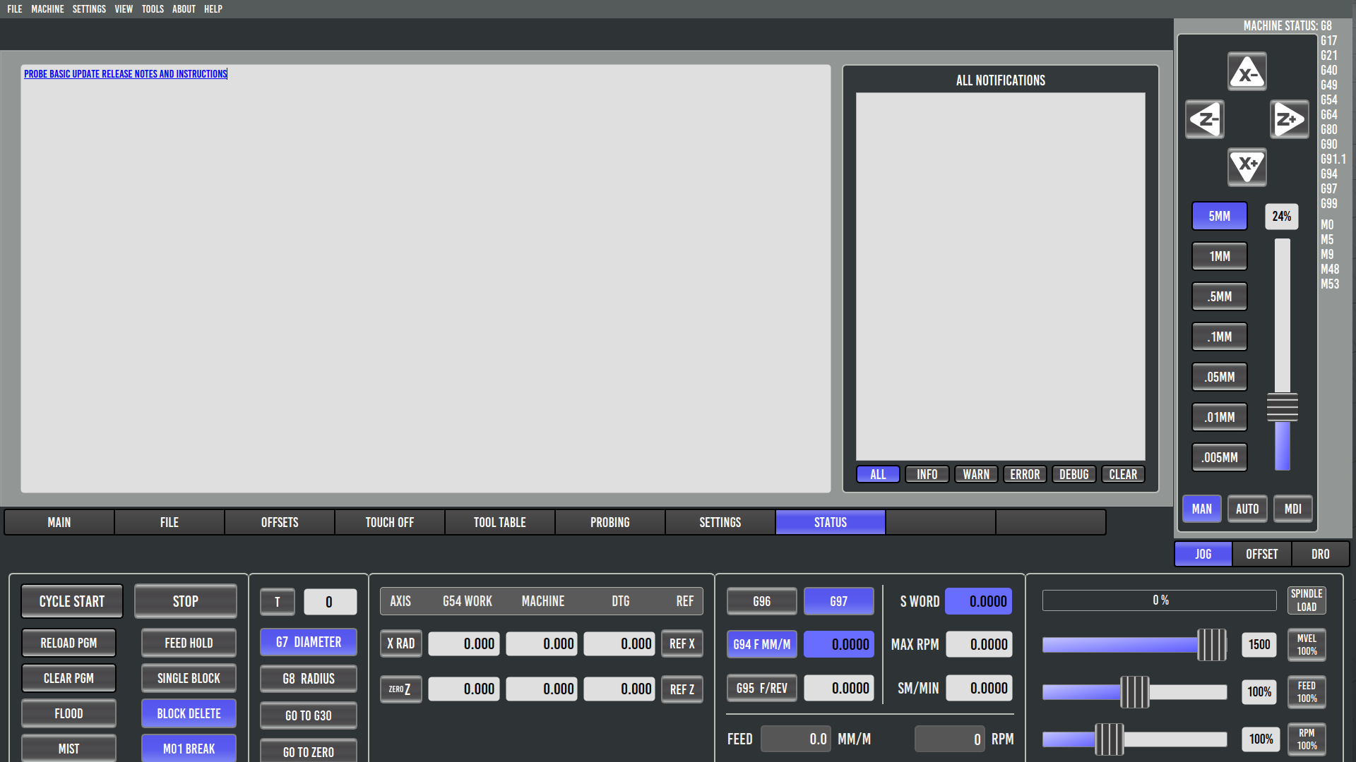

I've been using Probe Basic for quite a while, both for my mill and lathe, always with a parallel port until now. I've just finished migrating both machines to Mesa.The mill is up and running fine, but the lathe is giving me some trouble after moving to Mesa and Debian Trixie. I'm running the dev version of Probe Basic, and the problem is that not all widgets show up.The sim config displays everything correctly, but as soon as I load my own config, some widgets are just missing. I've been around the Probe Basic file structure long enough to feel comfortable with it, but there's clearly something I'm overlooking.

too many jog increments no more than 4 should be used + jog

Solved! In the old configuration, I had those 7 increments and it displayed correctly. I'm not sure if it's something related to the Trixie version. Thanks a lot!

Lathe was always laid out for 4 + jog and Mill for 3+ jog for best fitment, if you had 7 i can't imagine it looked very good, probably all smooshed up with no space. We fixed some formatting issues and that one was one I think where it wouldn't smoosh them together. But not it pushes the screen off the bottom.. so we are to the docs a recommended limit count.

Now it has let me set it to 5 + Jog, and it displays correctly.
