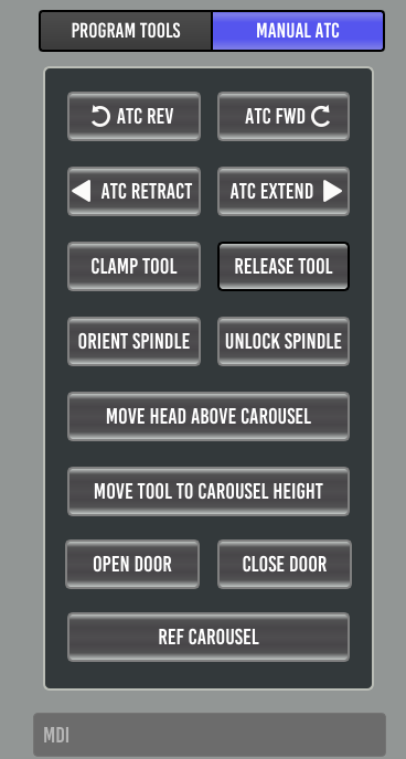

Trying to get all the user buttons, ATC buttons, user tabs, etc to show up and I'm struggling. PB starts up ok.
Edited INI file:
Copied all the template folders to my config folder.
Edited the copied template UI files slightly so I could see if 'my' versions were loading, but left them named 'template_user_nnn..."
Started PB and no user main/sidebar tabs were present. User button area was empty/blank, as was the ATC user button area.

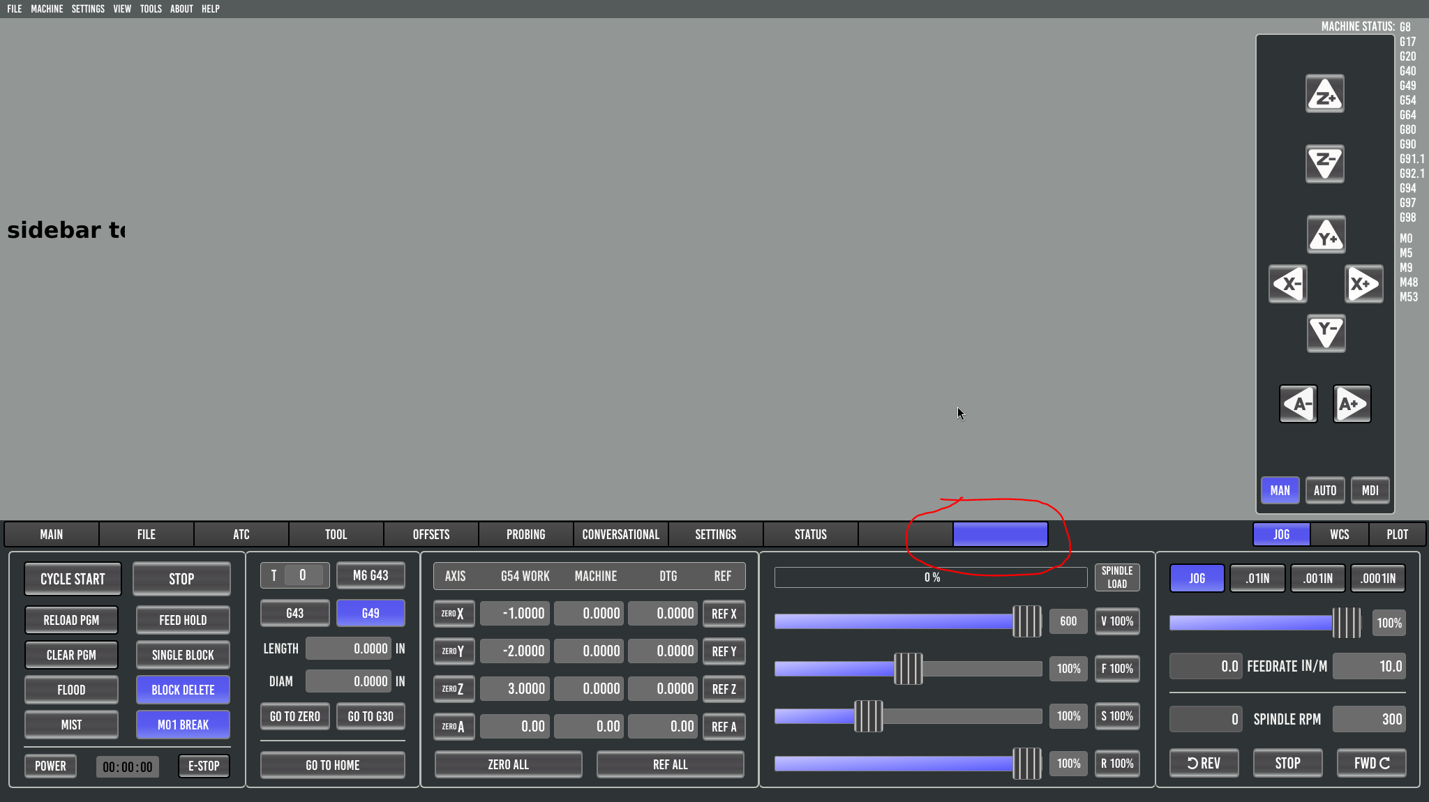

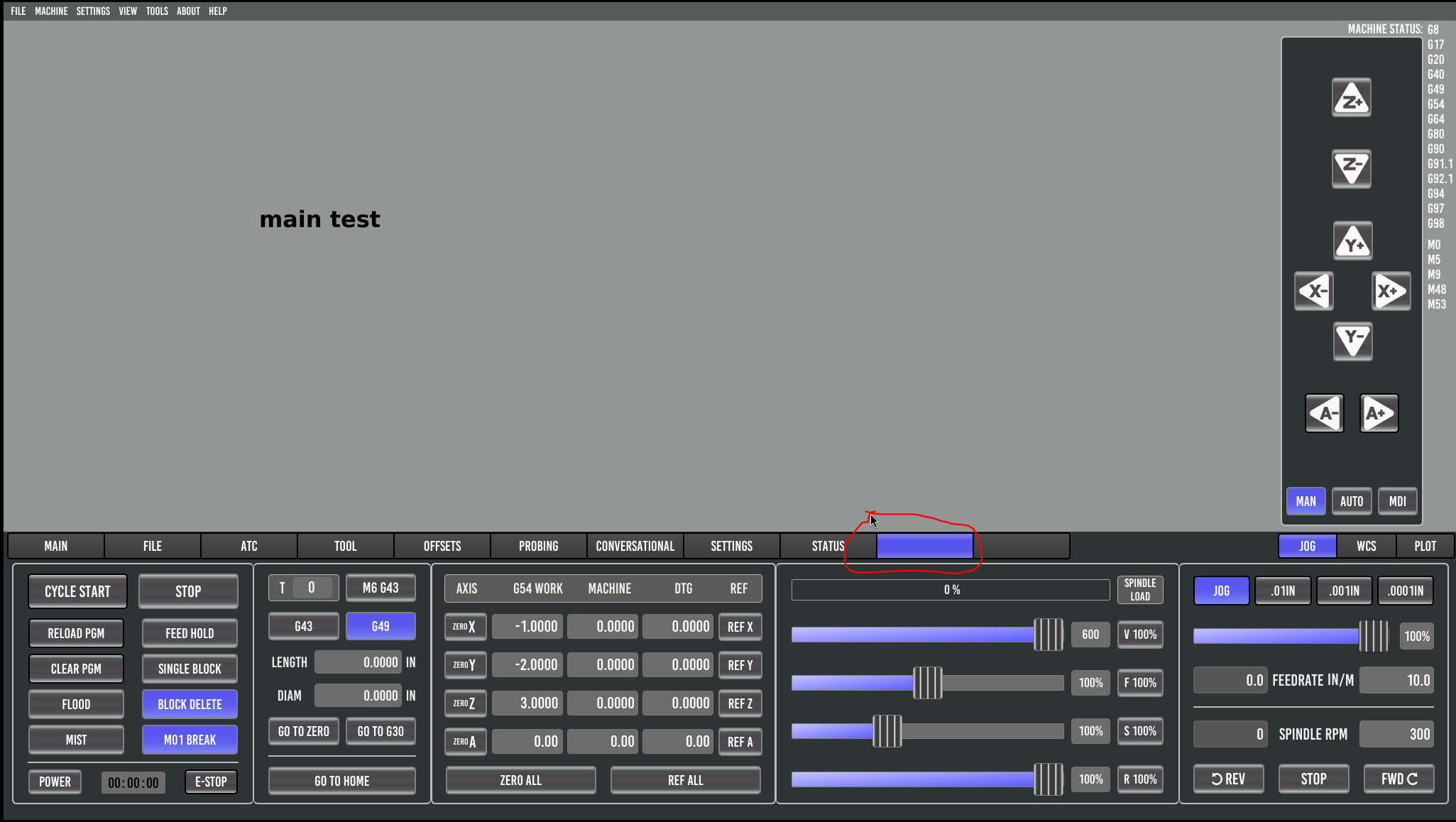

Got things working, badly.
Turns out the sub-folders have to be named the same as the .ui files.
And the user_atc_buttons MUST remain 'template_user_atc_buttons' as that seems to be hard-coded somewhere - maybe in probe_basic.py
Next problems:
Next problems:
- Sidebar tab is appearing in the main window
- Neither user tabs (main or sidebar) are labeled
- Unlogic

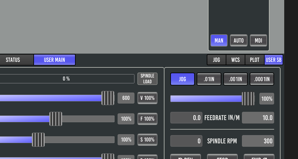

I made a post regarding this thread in the QtPyVCP channel on Matrix and got a reply that it seems to be a bug in the latest version.
- Lcvette
- Posts: 1683
- Thank you received: 782
2 months 1 week ago #349031
by Lcvette
Replied by Lcvette on topic Probe Basic - user tabs/buttons/etc not appearing
I think i have this resolved now and will be pushing out shortly today was a porting breakage that got missed one some other fixes.the object name user_main and user_sb this property determine the name displayed in the ui for the tab button text. so if you name it spumco_sb it will display SPUMCO SB in the ui.

2 months 1 week ago #349032
by Lcvette
tested here on sim and everything is now working as it should be again! thanks for bringing it up to my attention both of you!

2 months 1 week ago #349034
by spumco
Replied by spumco on topic Probe Basic - user tabs/buttons/etc not appearing
That did the trick, thanks.
