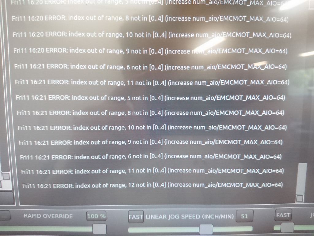

I'm currently struggling with getting calibration working. There are 3 rows of fields at the bottom of the probe gui. The rows starting with "clear x", "clear y", "clear all" buttons. Are these meant to display the calibration values? They are all 0's for me.
I've been running the calibration routine for an internal diameter. It does not populate those rows. I've found www.linuxcnc.org/docs/devel/html/gui/qtv...ets.html#_basicprobe which states:
And the link in my last post says:
So I have those lines in my qtdragon_postgui.hal. Am I meant to customize them for my setup in any way? If so, I don't understand what I need to do.
Initially I was getting an error and the calibration routing would not run. The error was 'NameError: global name "ngc" is not defined'. I fixed(?) that by changing "ngc" to "sub" in line 274 of basic_probe.py (under def cal_btn_clicked)
Now the cal routine runs, but does not populate those 3 rows. It also gives me lots of errors in status window. See attached photo.

- Posts: 18118
- Thank you received: 5336
11 Sep 2020 15:36 #181790
Replied by PCW on topic hal setup for probe
The error message is telling you what to fix...
you need to increase the number of AIO pins
man motion
man motion

11 Sep 2020 15:55 #181794
by lllars
Replied by lllars on topic hal setup for probe
Oh duh. Now that you mention it I even remember reading that instruction and deciding to ignore it because I wasn't sure if it applied to my hardware (7i95 btw).
So Thanks! That fixed most of the error messages. I am still getting one though: "Unknown oword number", and the 3 rows still are not populated
