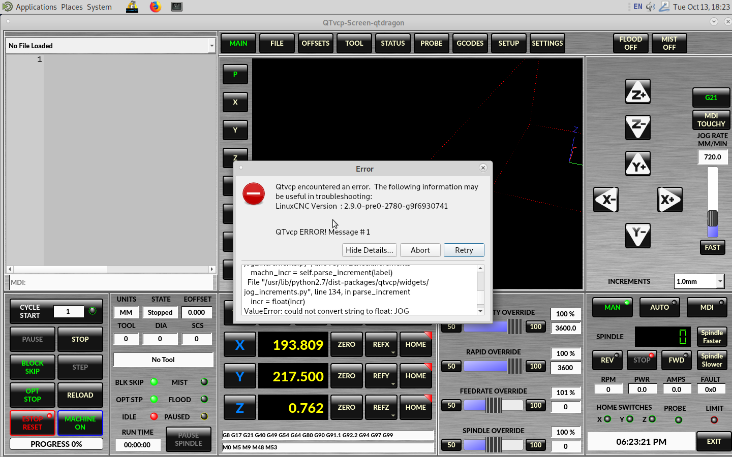

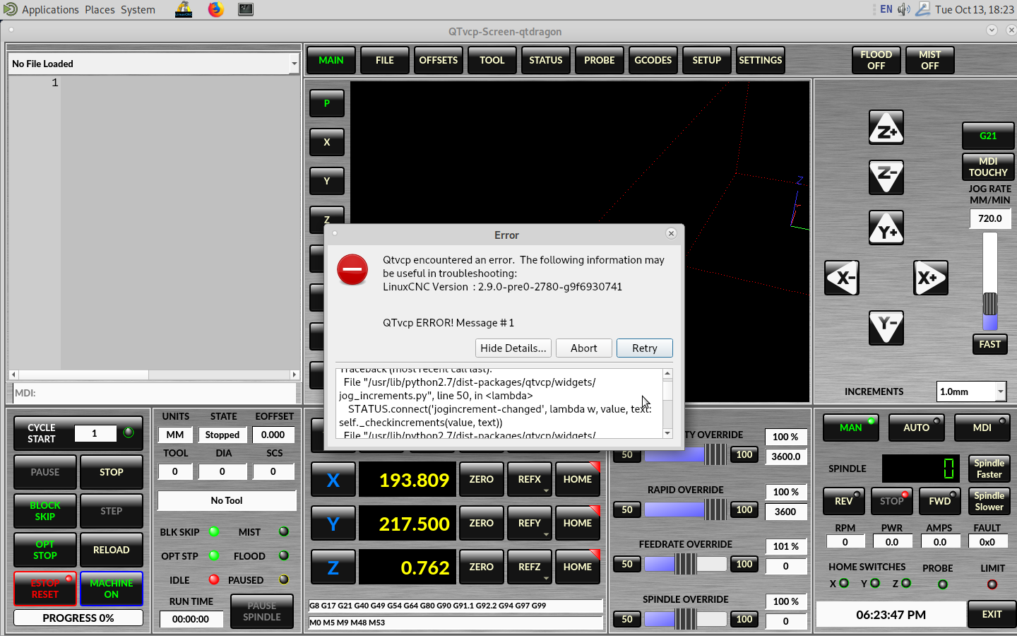

- keyboard
- Posts: 55
- Thank you received: 4
12 Oct 2020 17:56 #185891
by keyboard
Yes, having the same issues.
Also in JOG , when one switches from continuous to increments, a error box pops up, but clicking retry seems to work. but the error popping up is annoying.

13 Oct 2020 17:35 - 13 Oct 2020 17:38 #186036
by keyboard
Replied by keyboard on topic qtdragon tool table issues
In JOG , when one switches from continuous to increments, a error box pops up, but clicking retry seems to work

- Posts: 7368
- Thank you received: 2181
13 Oct 2020 23:42 #186062
Replied by cmorley on topic qtdragon tool table issues
Can you post your config files?
