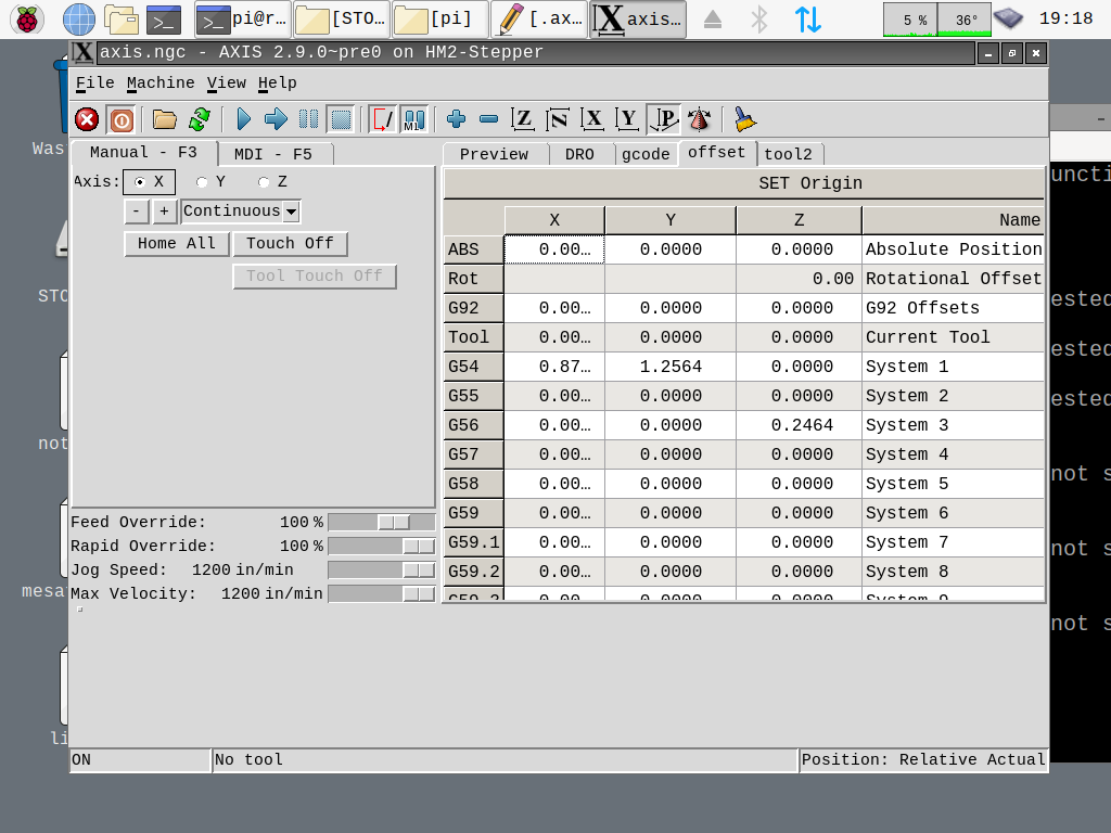

panels? no, I cannot get panels to embed the way pyvcp or glade panels embed to the right side. I do, use qtvcp tabs though, and loading a stand alone qtvcp window also seems to work with axis. some of the widgets seem to work independently enough with axis, but like cmo said, they arent well tested. here is one tab I use regularly, but still need to polish its behavior in regards to key binding and setting focus. other wise it appears to work well, , feel free to test it out. you can change the size in the UI file if its too small for your window
EMBED_TAB_NAME= offset
EMBED_TAB_COMMAND= qtvcp -d -c qtvcp_embed -x {XID} offset

08 Dec 2020 20:57 #191444
Replied by Todd Zuercher on topic Can Qtvcp add a panel to Axis?
I like your offset tab.
