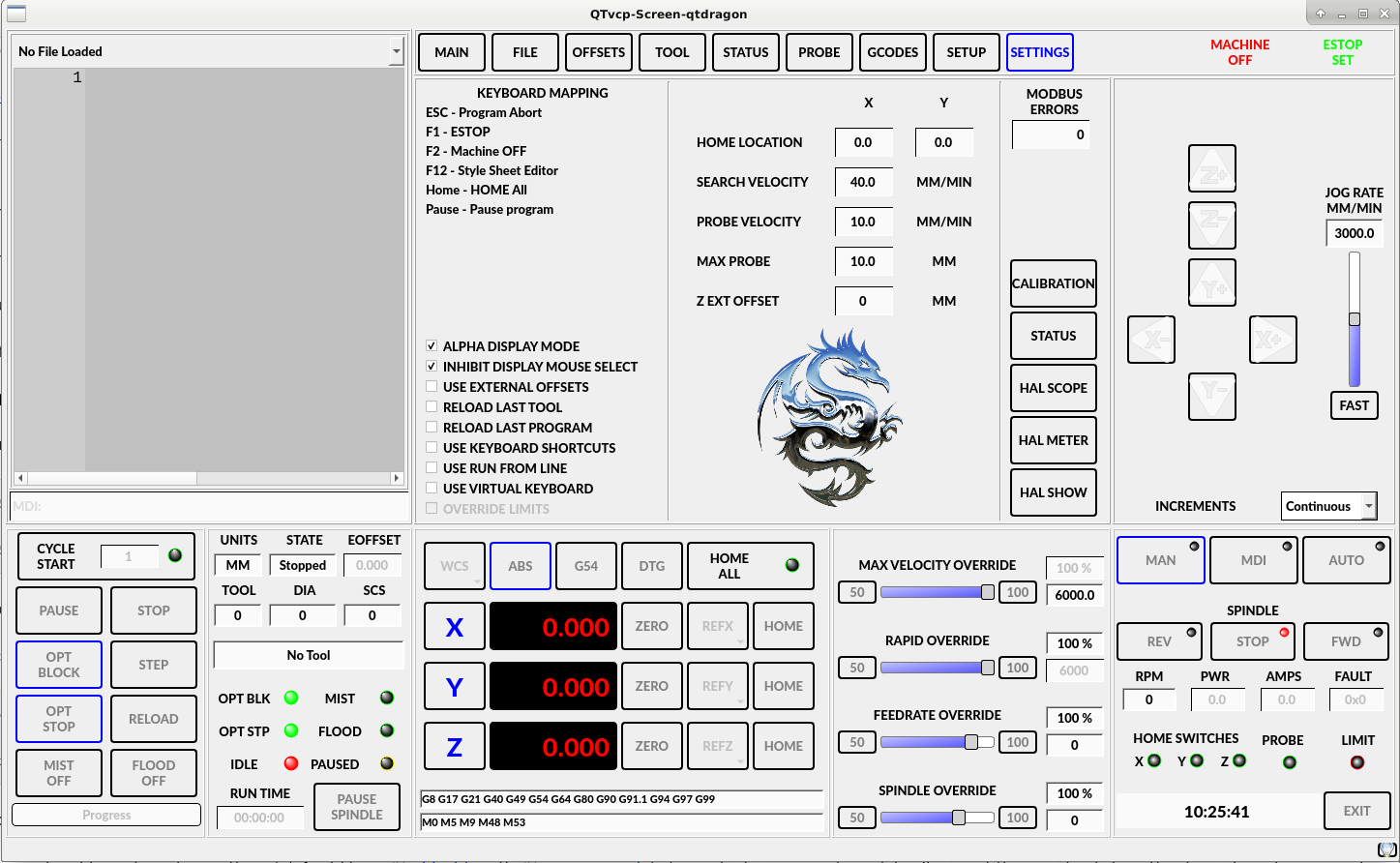

Hi again,
Is it possible to include a cam view tab in QTdragon? Or better, has anybody done it? I am not a developer...

Hi Jim,
is it possible that I have an outdated version? I installed the 2.8.1 Version of LinuxCNC on Buster RTAI as described in the documentation.
I don't see the option to enable the camera...
Also it looks to me that something may be wrong with the styles of my installation. The buttons for jogging are barely visible.
A screenshot is attached.
Thank you for your help!

06 Jan 2021 22:19 #194300
by persei8
Replied by persei8 on topic QTdragon and camera
Yeah, that is really old. Have you done an update/upgrade? You should have the latest linuxcnc 2.8 installed and then run the qtdragon sim configuration.
I have 2.9 installed so I can't even open the 2.8 sim configs to verify anything.
- Posts: 7360
- Thank you received: 2173
06 Jan 2021 22:32 #194303
Replied by cmorley on topic QTdragon and camera
That looks right for 2.8.1 I don't believe it got the camera tab before release.
The color style can be change by pressing F12 and opening and applying a new style.
A camera tab can can be added to a custom screen.

06 Jan 2021 23:01 #194305
by persei8
If you want to try out the latest version, which has the camera interface, you can download the files from github.com/persei802/QtDragon. Keep in mind, this is in active development and will change from time to time.
Jim
Jim
- Posts: 7360
06 Jan 2021 23:56 #194308
Jim ... Are you sure they will work in 2.8.1? I kinda doubt it
If all you want is basic Cam window (zoom cross hair circle) add this file in your configuration folder
Chris
Chris

06 Jan 2021 23:59 #194309
by persei8
I guess I forgot to mention you would have to install 2.9 as well.
- Posts: 7360
07 Jan 2021 00:00 #194310
or uncompress this file in your config folder (might be easier)
