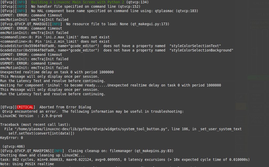

After updating yesterday evening, I started randomly getting this error on startup:
Here is the terminal info from when it happens:
I am unsure what the cause is, or if it's a QTVCP problem, but as it pointed to a QTVCP widget, I figured I'd point it out here. Apologies if it was already reported. I do believe user robertspark also saw it forum.linuxcnc.org/plasmac/38521-gui-for...mac?start=150#194659
But for me, it is definitely the #1 error message when it happens.
Thanks!
File "/home/plasma/linuxcnc-dev/lib/python/qtvcp/widgets/system_tool_button.py", line 106, in _set_user_system_text
self.setText(convert[int(data)])
KeyError: 0Here is the terminal info from when it happens:

Replied by cmorley on topic Error on startup
The error message is a red herring, unfortunately.
This is not a consistent error on start up?
Isee lts of error messages from the Motion component indicating something is hanging early in the process.
you running 2.8 or master?

Replied by andypugh on topic Error on startup
I think that "ini.z.maxlimit does not exist" is probably the real problem.
At a guess a HAL file is referencing those pins before the module that creates them is loaded. I am not sure which module creates them, though. I would have guessed motion, but they are not in the manpage

I think that's a fairly accurate guess. the maxlimit errors mostly shows up in SIM, but I have seen it once or twice on a live table. It always felt like a timing thing, so maybe we need to delve a little deeper into the order the modules are loaded.
Replied by snowgoer540 on topic Error on startup

I have not seen that error before.
ini.z.max_limit is netted by the handler file as the fourth command of the initialized function. Quick testing has shown that there is no difference whether it is the first or last command.
If I rename it to the wrong pin number then I get the following:but I dont see these messages which are in the first post.or further down:
<commandline>:0: Pin 'ini.z.max_limits' does not exist
<commandline>:0: Pin 'ini.z.min_limits' does not existUSRMOT: ERROR: command timeout
emcMotionInit: emcTrajInit failedwaiting for component 'inihal' to become ready......Please Log in or Create an account to join the conversation.

In the ini file, if I change:to a non existing path:I get this error in terminal:plus this error from qtvcp:so I don't think it is a qtvcp error, just qtvcp's reaction to not being able to load correctly because of some other pre-existing issue.
SUBROUTINE_PATH = ./:./qtplasmac:../../nc_files/subroutinesSUBROUTINE_PATH = ./:./wqtplasmac:../../nc_files/subroutinesemc/task/emctask.cc 69: interp_error: File not open
File not open
emc/task/emctaskmain.cc 3070: can't initialize interpreterTraceback (most recent call last):
File "/home/phill/git/linuxcnc-dev/lib/python/qtvcp/widgets/system_tool_button.py", line 106, in _set_user_system_text
KeyError: 0
