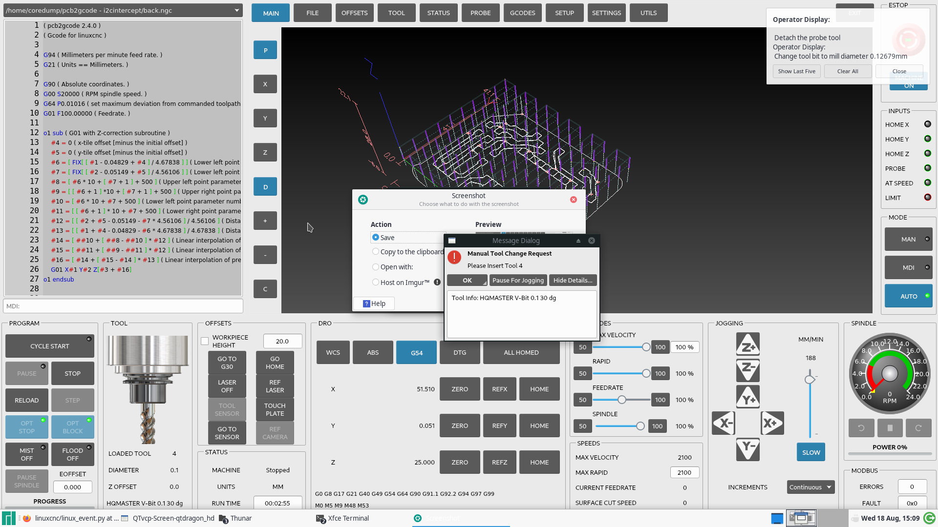

I tried another run today and I got the same problem. I am attaching the screenshots from what happened, and I tried to pay more attention to see if I could see anything different. I am a dumbass and took a screenshot with the screenshot app on screen, but behind it it's the 'spindle speed CW CCW' screen. It pops up without me doing anything, together with the 'manual tool change request', and I didn't click the pause for jogging button.This is what the machine status log has:
And that happened on this part of the code (I could see the red/yellow line jumping around on the code window:
Wed18 15:04 Started program from line 1
Wed18 15:04 Attach the probe tool
Wed18 15:07 Detach the probe tool
Wed18 15:08 Change tool bit to mill diameter 0.12679mm
Wed18 15:08 tool change paused for jogging; launched run-from-line
Wed18 15:08 Run timer stopped at 00:02:55
Wed18 15:08 Tool 4: HQMASTER V-Bit 0.1 30 dgAnd that happened on this part of the code (I could see the red/yellow line jumping around on the code window:
G0 Z5.000 ( Move Z to safe height )
(PROBECLOSE) ( Close the probe log file )
( Probing has ended, each Z-coordinate will be corrected with a bilinear interpolation )
(MSG, Detach the probe tool)
M0 ( Temporary machine stop. )
G00 Z25.00000 (Retract to tool change height)
T4
M5 (Spindle stop.)
G04 P1.00000 (Wait for spindle to stop)
(MSG, Change tool bit to mill diameter 0.12679mm)
M6 (Tool change.)
M0 (Temporary machine stop.)
M3 ( Spindle on clockwise. )
G04 P1.00000 (Wait for spindle to get up to speed)
G04 P0 ( dwell for no time -- G64 should not smooth over this point )
G00 Z5.00000 ( retract )

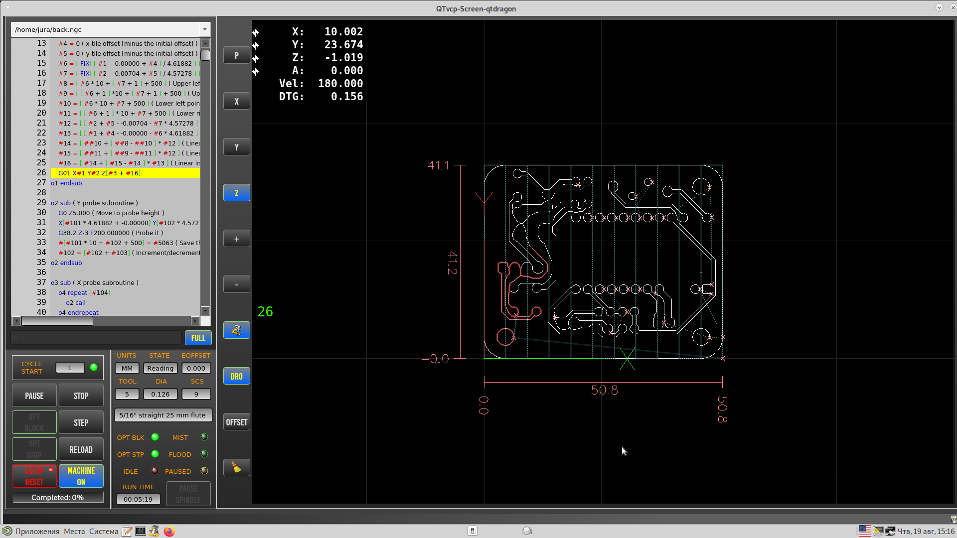

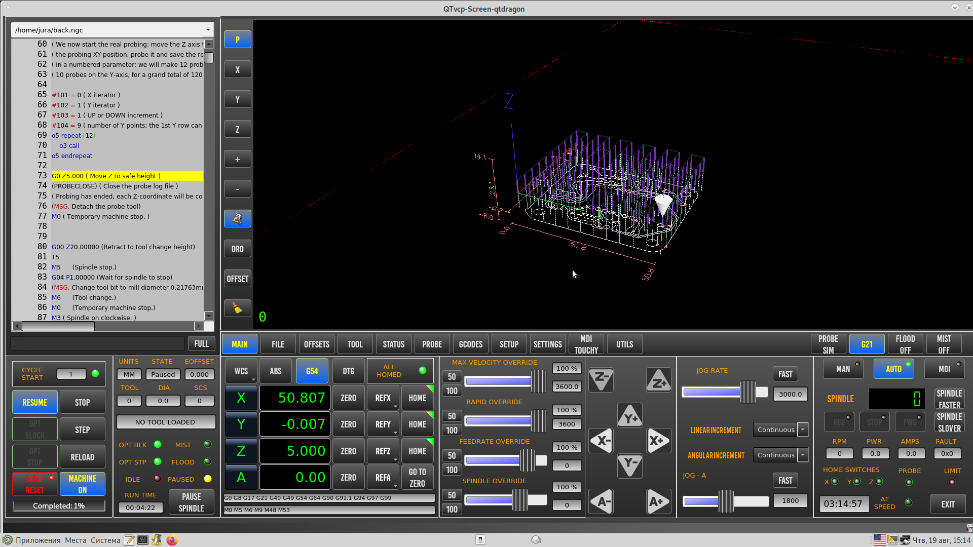

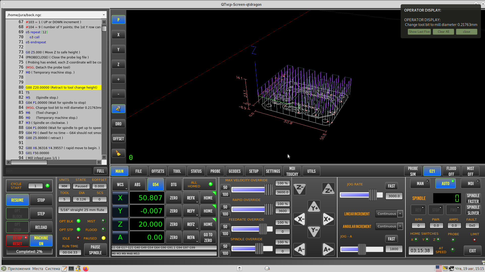

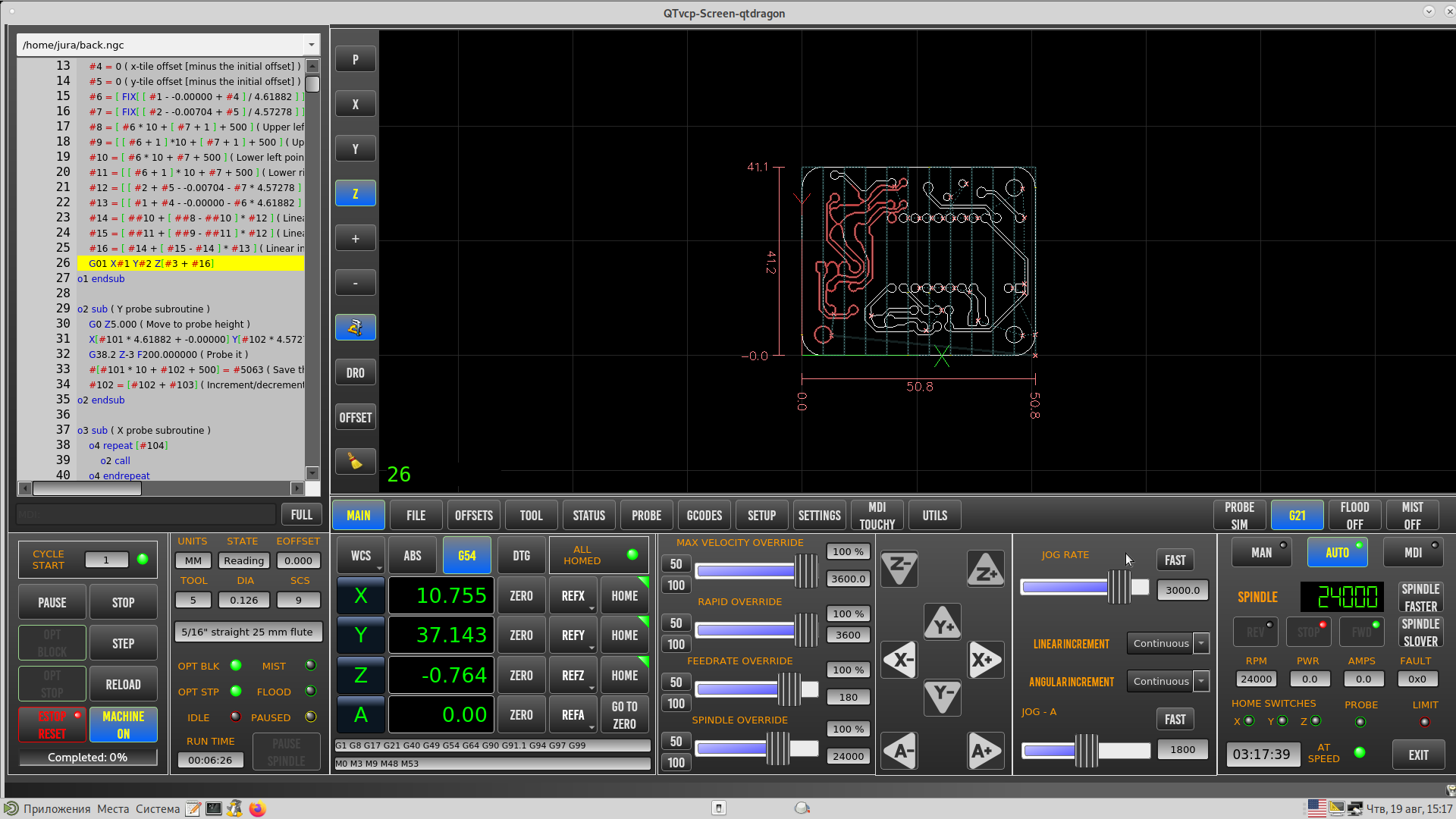

In linuxcnc 2.8.1everything works. Checked in the simulator (through Probe sim). After probing the workpiece, we change the tool and work is in progress.
