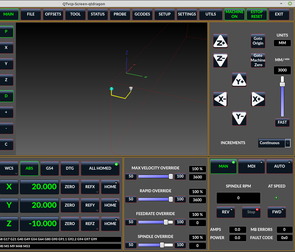

I was wondering weather it would be possible to put in a feature (for QtDragon) request to have two buttons added to the jogging interface.
One to goto machine zero and one to go to WCO zero (G54)
There is a nice place on either side of the z+ & z- buttons where it could go without cluttering up the interface too much & this would seem like the logical place from a work flow point of view.
I see that there are similar buttons in QtDragon_hd & it would be convenient to have them for those of us that sue smaller screens.
Thanks in advance.
Thanks in advance.

22 Aug 2021 05:58 #218403
by frayja2002
Replied by frayja2002 on topic QtDragon feature request go_to_zero
Hi there
I was just having a quick play with the new screen & trying to figure out if it is referencing a macro (ngc) file.
If it is could you tell me where it is getting that from of if it is embedded could I suggest adding...
G53 G0 Z0
at the beginning so that the spindle does not collide with the fixtures on the table.
I have added the file that I use to go work zero just as an illustration. ( it goes to z -5 for traveling)
G53 G0 Z0

- Posts: 7368
- Thank you received: 2181
22 Aug 2021 13:12 #218423
Replied by cmorley on topic QtDragon feature request go_to_zero
The pin will be 'qtdragon.slider_jog_linear'
I should have thought of the Z problem.
I have now pushed a change (to master) so qtdragon uses INI based MDi commands for the buttons.
ADD this to your INI:
[MDI_COMMAND_LIST]
MDI_COMMAND = G0 Z0;X0 Y0
MDI_COMMAND = G53 G0 Z0;G53 G0 X0 Y0
Hope that helps.
[MDI_COMMAND_LIST]
Hope that helps.

22 Aug 2021 18:32 #218449
by frayja2002
Hi there
Just a not to confirm that that all works.
I have uploaded a default ini file (for qtdragon) with some comments added which I thought it might be a good thing so that people will know what is these are for.
I have run this and tested it on a real machine to confirm that everything works as expected & just to confirm you can substitute you own gcode file in the form of...
MDI_COMMAND = O<go_to_zero> call
for those that want to do so (which makes this a really flexable tool)
On a side note I noticed that when I went through the pconf wizard to setup a new machine that the probe screen button was missing, however when I created a sim machine the probe button was there.
Am I missing something that I have to setup?

22 Aug 2021 20:24 #218452
I don't see the uploaded file.
Thanks for the feedback.
I should add something to the docs.
for probing add this to INI
[PROBE]
#USE_PROBE = versaprobe
USE_PROBE = basicprobe
[PROBE]

- Posts: 7368
23 Aug 2021 02:39 #218465
the [MDI_COMAND_LIST] is in there twice
I updated the docs a bit for qtdragon in master.
