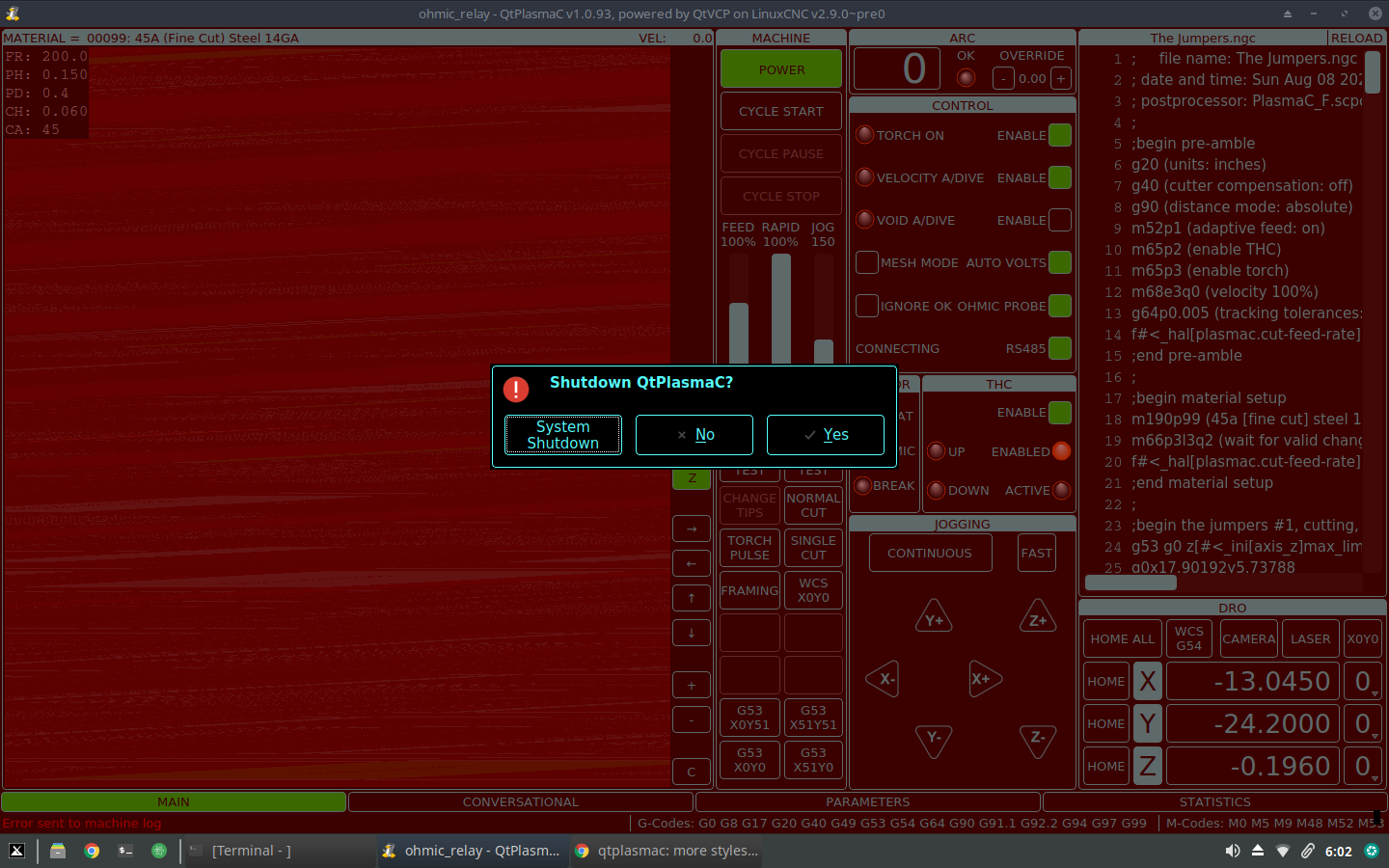

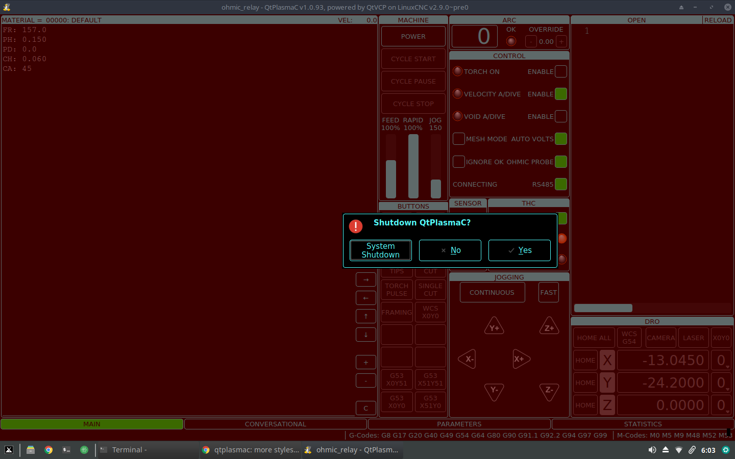

I've been playing around with the qtvcp screen options as a way to remind myself to park the torch near the home point before closing down so I don't have to wait so long for it to home.
At any rate, in the process, I noticed a few things/had a question.
1. Would it be possible to change the color and or transparency of the background?
2. Sometimes it causes the preview panel to go haywire:
3. For reasons I don't understand, the first time the popup appears, it is always low and to the right of being centered. If I click No, and then close the window again, the second (and subsequent) popup is centered.
If nothing else, I thought I'd pass along the feedback. Either way, it still helps me remember to park the torch

Hi Greg.
1) you should be able to but the code was broken -pushed fix
2) 3) yes every different version of qt/opengl/moon phase makes these things work differently.
It's really cool/professional when it works - I wish it was more consistent.
The shutdown message is user changeable in the preference file.
(qtplasmac sets a different message based on your sceen shot so maybe it's programmatically altered - but by default it's set from the preference file.)
I also just added 'shutdown_msg_focus_text' to the preference file.
This allow setting the focus overly text at the close event - it's bigger and hard to miss.
Chris

1) sorry forgot to say how.
either set it in designer -ScreenOptions, property: close_overlay_color
or in the handler file set screenoptions same property directly

A few things I came across while messing with this:
1. If I right click on "screen_options" in designer and click "Set Options", I get this error:
2. I am wondering what "shutdown_msg_detail =" is supposed to do, it currently doesn't appear to do anything when set.
3. I'm a bit confused about setting the color. Designer shows red blue green alpha and lists it as [red, blue, green] (alpha), but I'm not sure how to translate that into the handler.
I tried using self.w.screen_option.setColor(22), and it only allows 1 number value, which basically gets me several shades of grey on guesses. Anything else causes it to crash fairly spectacularly.

1) ok pushed fix - in fact the 'set options' dialog is far behind the widget's options - i didn't fix that .
2) i pushed a fix for this too but maybe it needs a rethink. details msgs will cause a button to be shown that when pressed will show the extra info.
currently it's read and saved to the preference file. but maybe it should not be and be available for the screen builder to add last minute info for a user that is closing the app. I could also force the extra info box open at the same time.
3) you need to use a QColor object to define the colors.
4) Yes (sorry that would have been easier for you..).
# red,green,blue,alpha 0-255
color - QtGuii.QColor(0, 255, 0, 10)
self.w.screen_option.setProperty('close_overlay_color', color)4) Yes (sorry that would have been easier for you..).
ScreenOptions{qproperty-close_overlay_color: rgba(0, 255, 0, 75%);}
