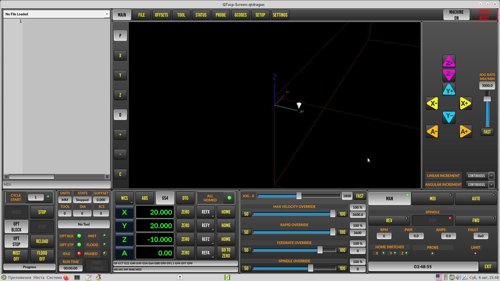

Am I doing something wrong here.
A new install of v2.8.2
Full HD touchscreen, and 1920x1080 resolution
If I select 'qtvcp qtdragon' in the display section, then the GUI loads correctly, but if I choose 'qtvcp qtdragon_hd' then nothing happens and it just drops back to the Desktop screen.

Sorry I missed the linuxcnc 2.8 part.
QtDragon_HD is not included in 2.8

Great. I wished I'd known that before I started this project
How do I acquire QtDragon_HD? Or is it not possible?

Great. I wished I'd known that before I started this project :(How do I acquire QtDragon_HD? Or is it not possible? Add the attached files to the configuration folder.

The original interface is stretched to make full hd.
