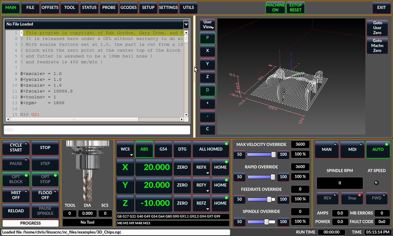

28 Jan 2023 14:33 - 28 Jan 2023 15:04 #263118

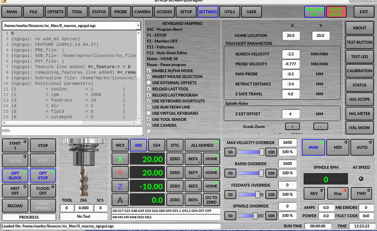

Customized QtDragon Discussion was created by cmorley
Some trial work on a customized Qtdragon with a sliding splitter pane.Also has gcode text zoom buttons in settings
The attachment holds the folders/files needed to be added to the config file inside the qtvcp folder. There should already be a qtvcp folder in your config. This will add a screens folder with qtdragon inside it.

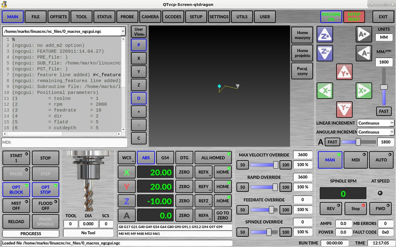

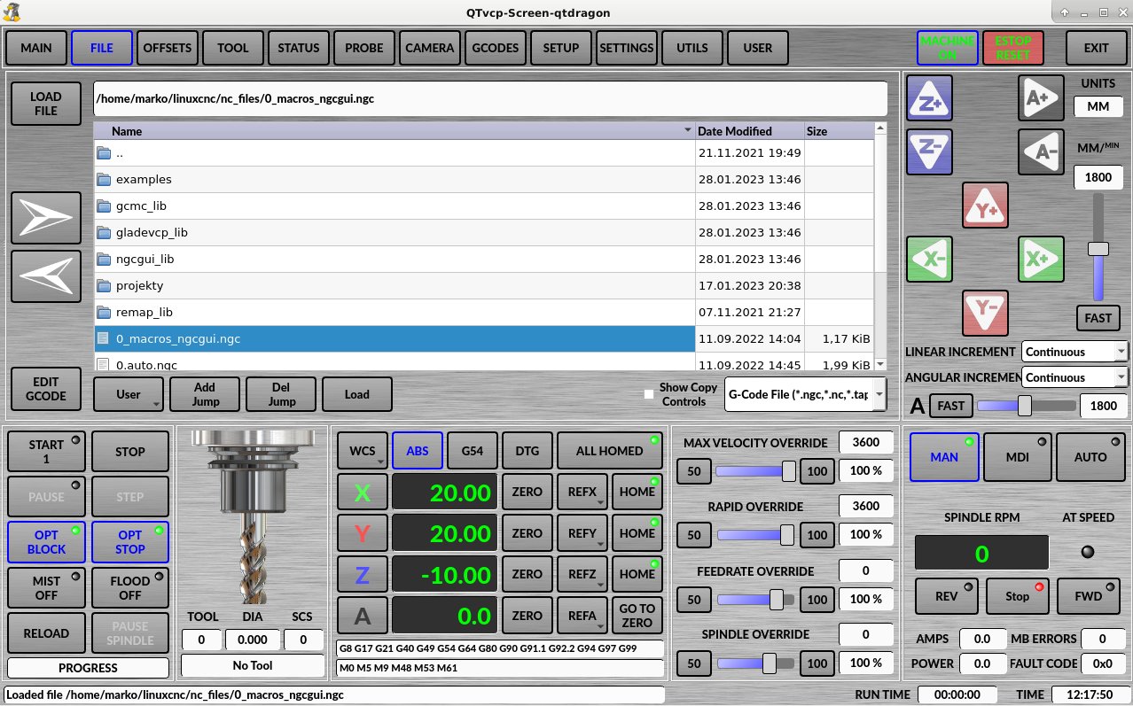

29 Jan 2023 05:27 - 29 Jan 2023 05:27 #263163
by MarkoPolo
Replied by MarkoPolo on topic Customized QtDragon Discussion
I like it, a few details need to be worked out and it can be.
It even remembers after restarting qtdragon how some sections should be set, e.g. file yes, settings no

29 Jan 2023 14:36 #263184
by MarkoPolo
Yes, I think it would be possible to introduce such an arrangement at this stage.
A few things do not fit into the minimum size of the main window, but such small things will be happy to improve.
There is also a static size of the line number space in the gcode field and it does not fit with a larger font.

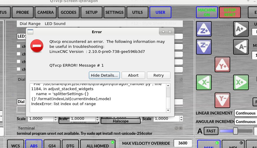

I made some tweaks with better button matching.
There is also some error after pressing the "user" button several times.

31 Jan 2023 01:17 #263304
Replied by cmorley on topic Customized QtDragon Discussion
Thanks. I'll have an update tomorrow night.

01 Feb 2023 07:49 - 01 Feb 2023 20:28 #263441
This will require the latest 2.9/master code.User button fixed.splitter can be set differently in Manual/MDI or auto.

- Posts: 7368
- Thank you received: 2181
01 Feb 2023 20:27 #263485
Sorry I'll try again..

02 Feb 2023 02:57 #263503
by MarkoPolo
Yes, now it works properly, the function of the "user" button is ok.
