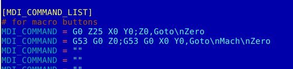

The macro button codes can be changed in the ini file.

Here the .ini
I'm using the QtDragon_HD if it matters.
The Z-Axis allways goes to 0 but I need it at 110;
Here the .ini
Last edit: 22 Oct 2023 04:41 by udoS.

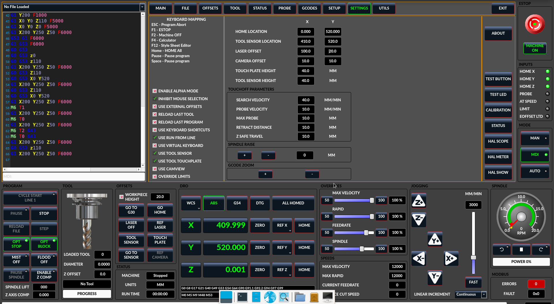

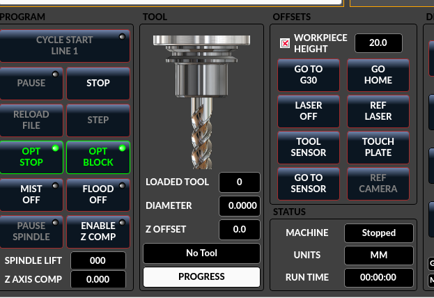

22 Oct 2023 11:34 - 22 Oct 2023 11:40 #283508
by udoS
Replied by udoS on topic QtDragon HD with Z-Comp: Tool Sensor and Touch Plate Function
Sorry, you AGAIN didn't read it correctly !
my HomeAll/Reference Switches are at X0 Y520 Z110;
There are two Buttons in the Offset section in the QtDragon_HD UI ( see picture 2 )
Button 1.) Go Home <This Button acts like MDI: G0 G53 Z0; then: G0 G53 X0 Y520 >
Button 2.) Goto G30. <This Button acts like MDI: G0 G53 X0 Y0 Z0 >
I need:
Button 1.) Go Home < G0 G53 Z110; then: G0 G53 X0 Y520 >
Button 2.) Goto G30. < G0 G53 Z110; then: G0 G53 X0 Y0; then: G0 G53 Z0 >
Where do I find the macros, what are there names or how else do I get there;
Thanks if anyone can help;
Best Regards
udoS
I need:
Best Regards
udoS
Last edit: 22 Oct 2023 11:40 by udoS.
- Posts: 7368
- Thank you received: 2182
22 Oct 2023 12:15 #283515
Replied by cmorley on topic QtDragon HD with Z-Comp: Tool Sensor and Touch Plate Function
Home button final position is defined on the setting page.
The sequence is called from the handlerfile:
G90
G53 G0 Z0
G53 G0 X Y (from the setting page)
The g30 page is just a call of G30 - which it's position can be defined with params/g30.1
linuxcnc.org/docs/2.9/html/gcode/g-code.html#gcode:g30-g30.1
G90
G53 G0 Z0
