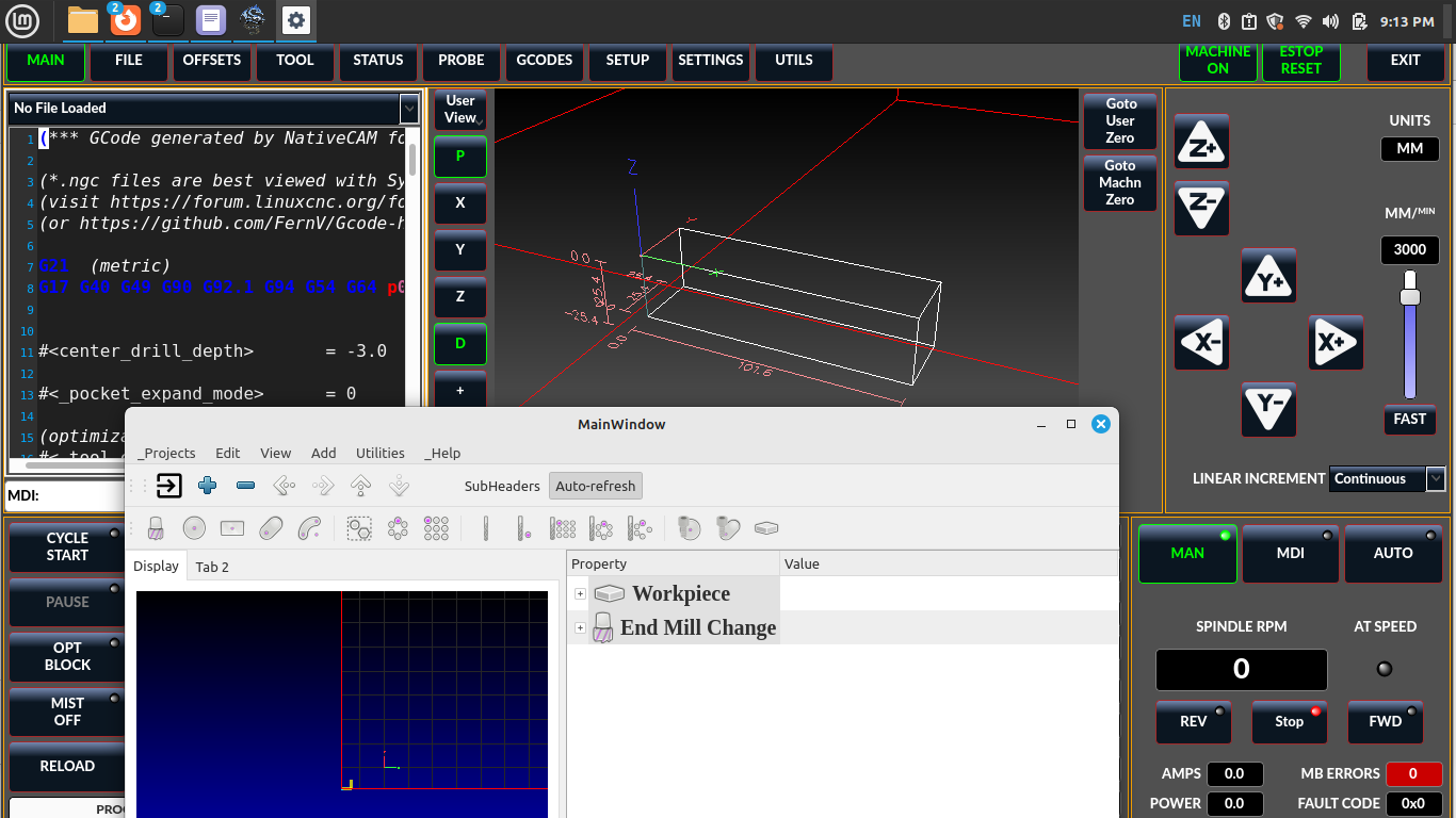

Replied by andypugh on topic development of a qt version of ncam
While you are at it... Do you see a more elegant way to display the stock than a set of rapids that are in an optional block? That was an ingenious hack, but runs the risk of actually being run. (Unless I am misunderstanding something)

Replied by cmorley on topic development of a qt version of ncam
I'm sure we could add magic comments to do it.
Little more updates...

Replied by Roguish on topic development of a qt version of ncam
the previous version of NCAM would pop a warning at you if ya tried to run with the 'stock' lines on. and would not run, until ya turned them off.
No clue how it was handled inside, but it worked.
Caught and saved me a number of times......
Currently not available -it's just on my system- I think it's still to rough for anyone to use.
It will install with linuxcnc - it will be part of it.
I'll push it pretty soon - I don't want to lose the work if my machine crashes
