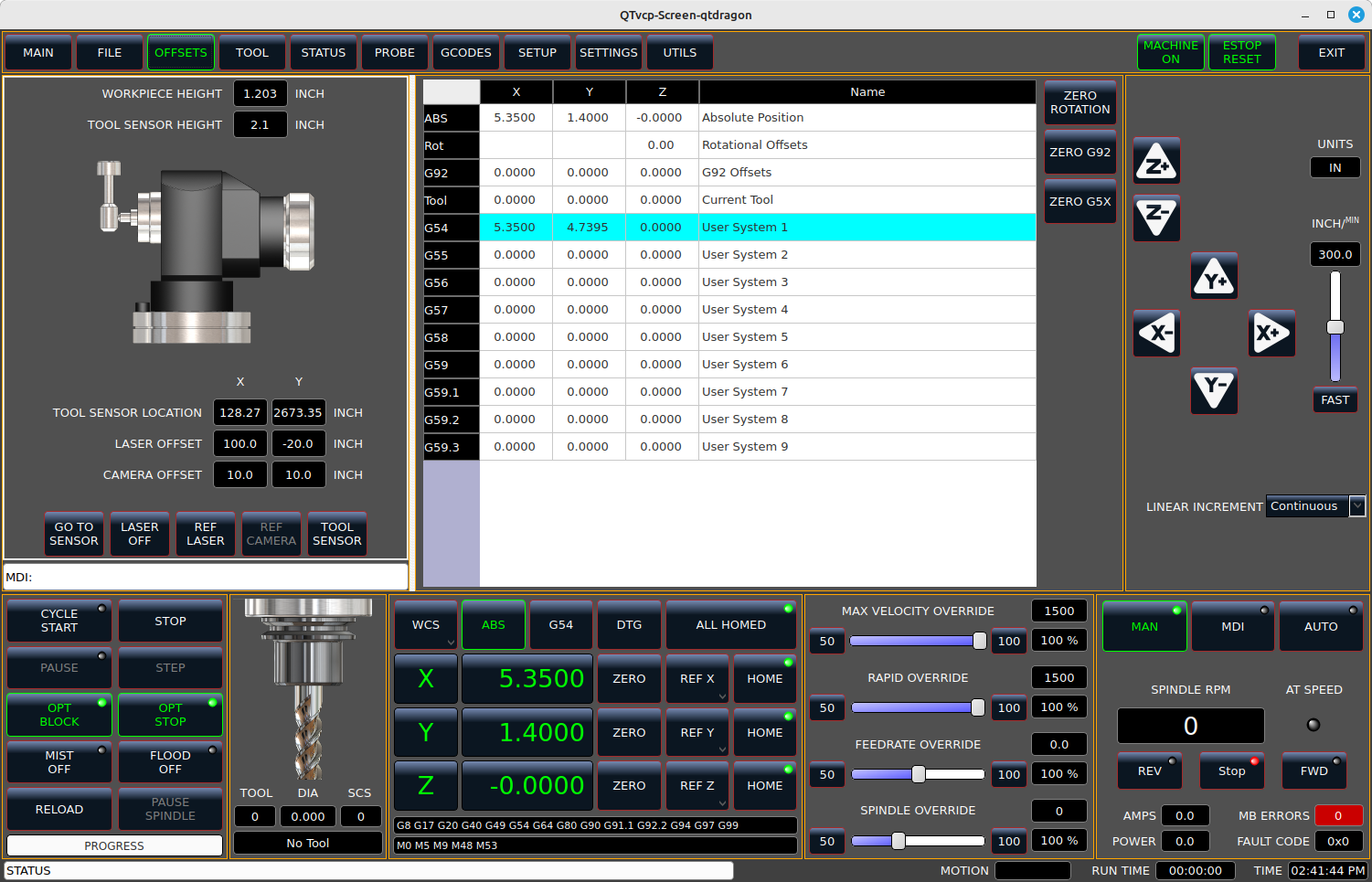

The location of the tool setter uses metric coordinates even though the machine is in inches
## Here are the steps I follow to reproduce the issue:
1. Start Linux Cnc
2. Enable the machine
3. Home the machine
4. Click on the "Offsets" tab
5. Click on "Go to Sensor"
## This is what I expected to happen:
The machine should move to Tool Sensor at X=5.05, Y=105.25
## This is what happened instead:
The machine moves to coordinates (approximate) X =0.196, Y=4.144
## Observations and corrective actions:
Manually changing the values on the screen to X=5.05 x 25.4 and Y = 105.25 *25.4 and the machine moved to the correct position

- faeluke
- Posts: 24
- Thank you received: 5
05 Mar 2024 19:11 #295248
by faeluke
Replied by faeluke on topic QtDragon bug?
Sorry to be confusing, but the machine is using my values that are in inches as if they are metric values.
I provided 5 inches, the machine moved (5/ 25.4) = .198"
I provided 105 inches and the machine moved (105/254) = 4.144"
I had to type rather large values in the dialog box to get the machine to move to the correct position.

- faeluke
- Posts: 24
05 Mar 2024 20:00 #295253
by faeluke
Thanks for your interest in this issue!
The INI file has the correct coordinates so that the M6 remap works
The picture shows the values that had to be edited on the screen to position the tool head over the sensor.
The QT dragon preferences file shows the location that agrees with the screen.
In an attempt to be clear, the OFFSETS screen will not work if I put the correct units in inches.
It works with the values that have been converted to mm.
The M6 remap goes to the correct position given the values in the INI file.
My point is that the screen clearly indicates inches as the unit of measure, but requires the units to be in mm.
Do you agree?
If you spot any other errors, help would be greatly appreciated.
I am about to start on auto tool change.
Do you agree?
- Posts: 12085
- Thank you received: 4127
05 Mar 2024 23:09 #295267
Replied by rodw on topic QtDragon bug?
Seems odd. The docs say it uses machine units (inches in your case) Can you check your gcode and remap files don't issue a G21?
I will leave this one for Chris M
- Posts: 7353
- Thank you received: 2169
06 Mar 2024 04:29 #295290
Replied by cmorley on topic QtDragon bug?
I can confirm, it is a bug. I'll look at a fix soon.
Chris
Chris
The following user(s) said Thank You: faeluke
- Posts: 7353
07 Mar 2024 04:33 #295376
Could you try this fix?
add this file (rename it qtdragon_handler.py) in your config file, in the folder qtvcp/screens/qtdragon
If anything goes wrong just remove that file and the original will be used again.
