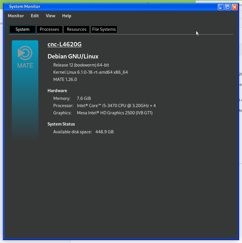

How did you download linuxcnc?
- frayja2002
- Posts: 159
- Thank you received: 13
29 Mar 2024 10:44 - 29 Mar 2024 11:18 #297090
by frayja2002
Replied by frayja2002 on topic Raise tool on pause net working in V2.9
Downloaded debian 12 from their web site & installed Linuxcnc from the repositories.
Currently on LINUXCNC - 2.9.0~pre1+git20230208.f1270d6ed7
Alex
Alex
Last edit: 29 Mar 2024 11:18 by frayja2002.
- Posts: 7361
- Thank you received: 2173
29 Mar 2024 20:20 #297138
Replied by cmorley on topic Raise tool on pause net working in V2.9
Ok. Debian's official version is way behind and I don't think it will be updated.
buildbot version would have all the latest updates.
for bookworm a deb from here should work:
buildbot2.highlab.com/debian/dists/bookw...uspace/binary-amd64/
this would give you the latest bug fixes to date.
I'm sure there is and ISO version from linuxcnc's website too.
That would give you the latest released version 2.9.2
Hopefully someone else can advise you the best way if that is how you wish to go.

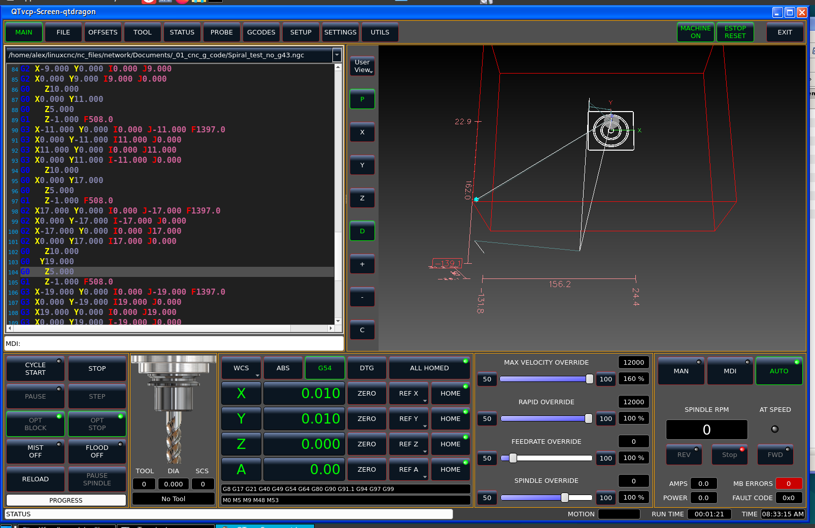

06 Apr 2024 10:13 #297675
by frayja2002
Perhaps some-one can advise me on this.
I have uninstalled the dist LinuxCNC (from deb 12) & installed the deb files from the link above (LINUXCNC - 2.9.2-168-ge7cd5217d9)
However now every time I go to run my gcode I get the following errors (always line 105)
Sat06 20:58: Started program from line 1
Sat06 20:58: Linear move on line 105 would exceed Y's negative limit
Sat06 20:58: Linear move on line 105 would exceed joint 1's negative limit
Sat06 20:58: invalid params in linear command
Sat06 20:58: error parameter is [3.000000]

Please note I have tried several different files & these have been run previously & worked.
I am in the middle of the table & nowhere near the y limit.
I have included a copy of one of the gcodes.
Alex

- frayja2002
- Posts: 159

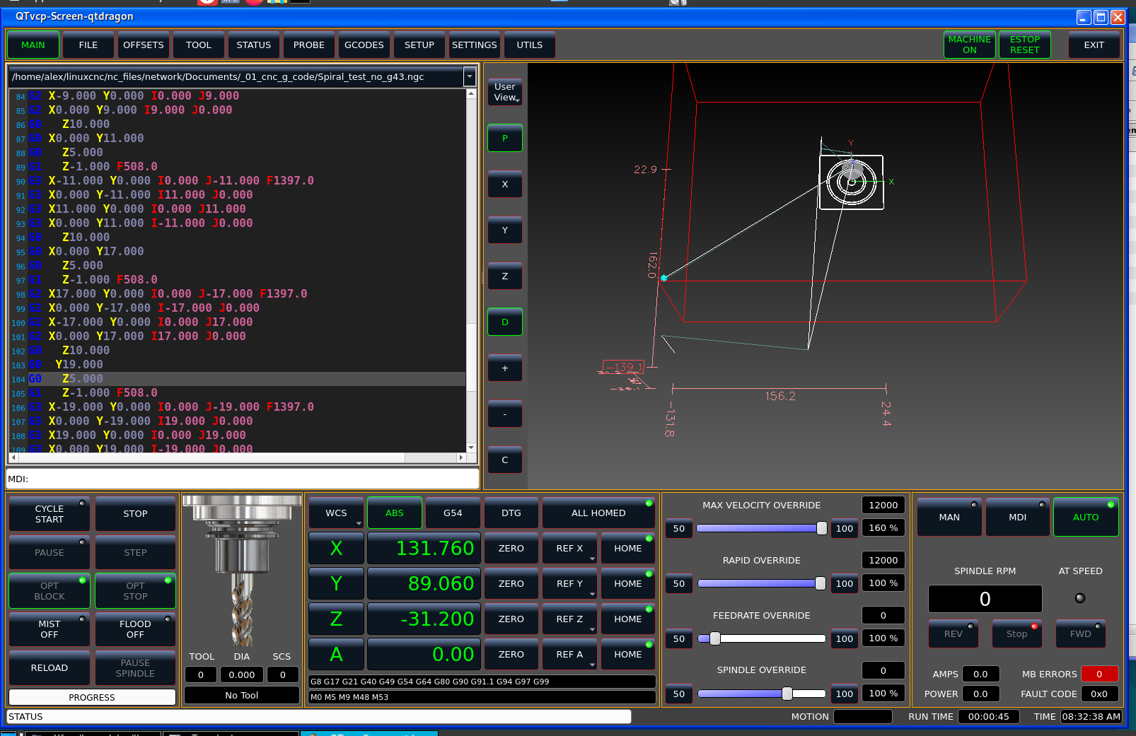

06 Apr 2024 22:37 - 06 Apr 2024 22:51 #297719
by frayja2002
I'm not quite sure what you mean with that.
I have included some further screenshots.
The offsets are set to the middle of the table & you can see by pics that the job is well within the bounds of the machine
Is there some other way to set them?
Please note also I believe there is no Y axis movement in line 105.
Alex

- Posts: 7361
06 Apr 2024 23:35 #297723
The lines outside the box are surely the problem.
- frayja2002
- Posts: 159
07 Apr 2024 00:13 #297725
by frayja2002
oops..
That's the line for the remapped M6 routine. I had pinched the computer of another machine with the touch off button in a different location.
The error doesn't say which file the error is in although it should have been obvious.
Thanks for pointing this out.
I have changed the parameters in M6 and now everything is working as it should including the pause button.
Again thanks for persevering with me to solve this.

Do you want it to always automatically raise the spindle on pause? Right now you must press the 'spindle pause' button. That button currently does not have a pin associated with it.
Most people use HALUI for conecting with an operator panel, but it is not going to intergrate well with the spindle pause without some work.
HALUI pause will work fine but the HALUI resume function will not wait for qtdragon to lower the spindle before resuming the program.
This is a bit of a weak spot for qtdragon/linuxcnc.
We could probably find a work around.
