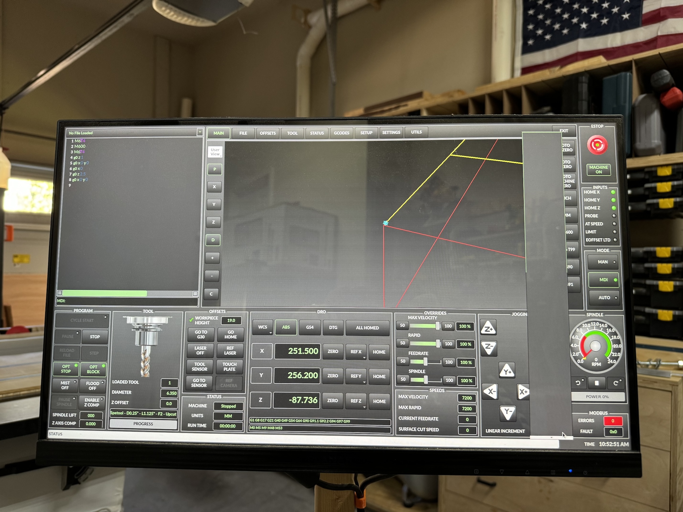

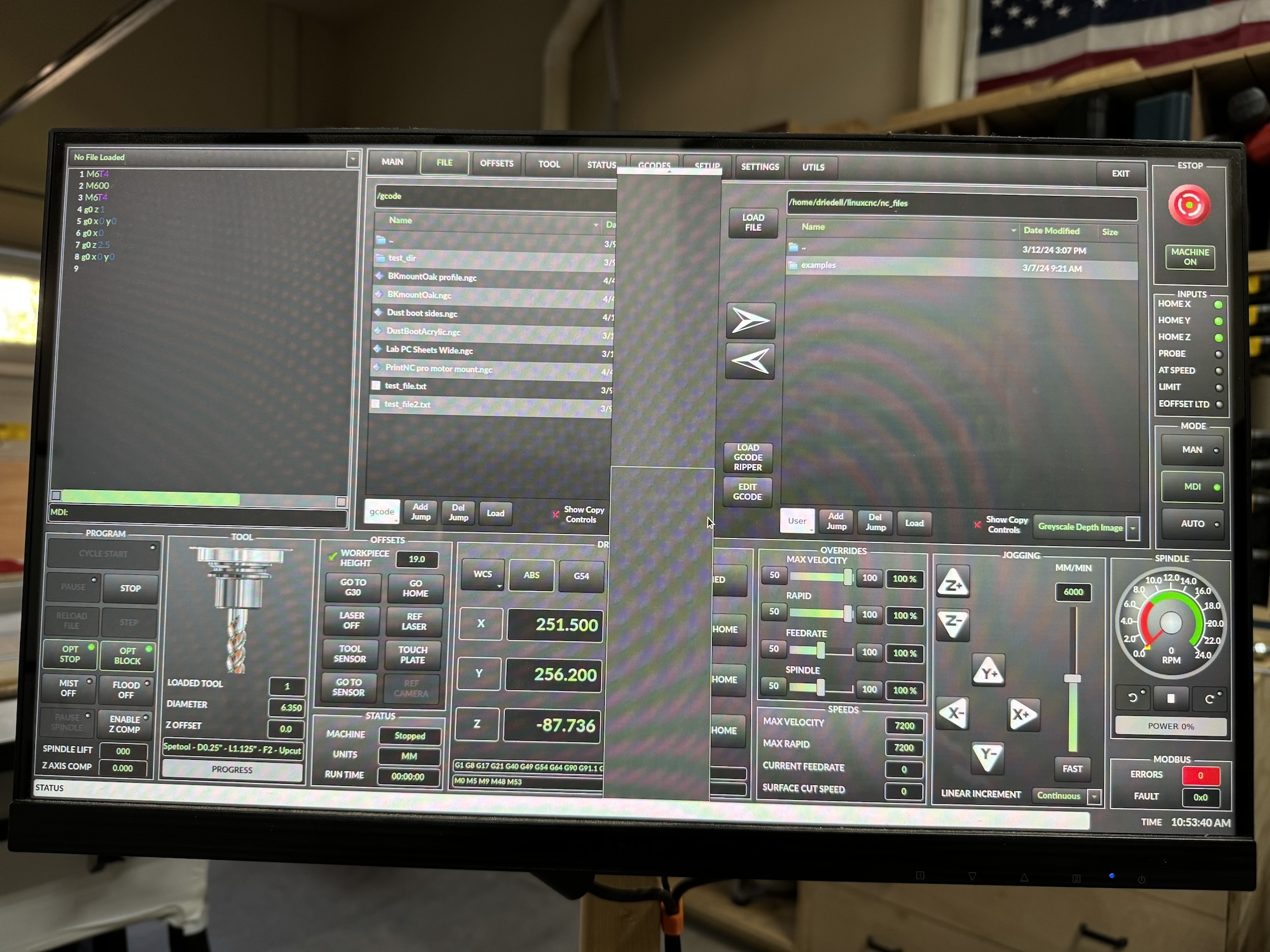

I'm working on a new installation of QTDragon_HD and for some reason the formatting on some of the dropdown menus are all out of whack. When I try to select a different option for the jog increment, the dropdown menu takes up the entire vertical height of the screen. Same for selecting the file types on the "Files" tab.
Not all dropdowns are affected; as you can see in IMG_0333.jpeg the REF X dropdown menu seems to be functioning properly.
The dropdown menu items appear to actually be there. I can select different increments by blindly jabbing at different parts of the open dropdown menu, but I can't see any text and clearly the formatting is wrong.
Has anyone else run into this? If so how did you fix it?

please post your INI file. Can you run linuxcnc from a terminal and post the output.

ini and terminal output attached.

hmm no smoking gun...
Can you try a different stylesheet? (F12 for the editor/selector)

It looks like it was a stylesheet issue, I swapped to a different one and the problem disappeared. No idea how the initial one got messed up.
