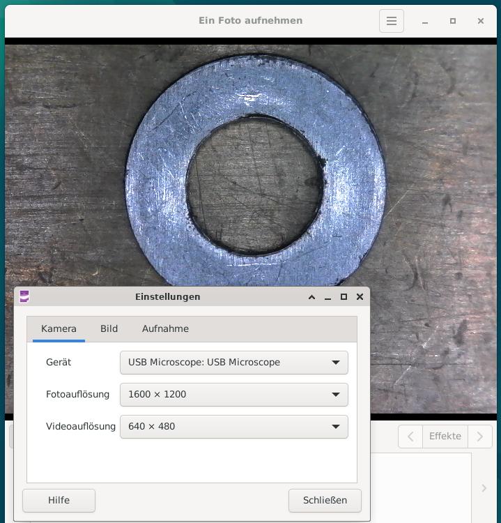

camera resolution doesn' fit was created by partec
- partec
- Posts: 173
- Thank you received: 27
06 Dec 2024 10:59 #316118
by partec
Replied by partec on topic camera resolution doesn' fit
It shouldn't be necessary to use Multimedia CHEESE for AXIS data logging, right?

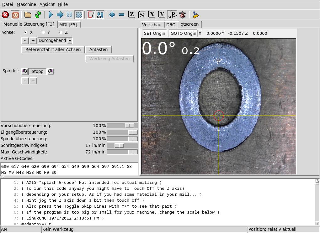

Do you mean the image is not the full tab width in Axis?
The following user(s) said Thank You: partec
- partec
- Posts: 173
06 Dec 2024 13:34 #316127
by partec
thanks Chris, it is none proportionality of the figure at all, there is no idea at the moment.
- Posts: 7368
- Thank you received: 2181
06 Dec 2024 14:24 #316132
Replied by cmorley on topic camera resolution doesn' fit
x or y scaling needs adjustmenf -meaning a distorted shape (that's what it looks like)
You can set the scaling of x and y in 2.9.3 with the INI embedding line by adding something like this:
-o xscale=1.0 -o yscale=1.5

strangely, the variation of the parameter is not relevant effective on the proportionality of the image
- Posts: 7368
07 Dec 2024 14:02 #316211
Yes I can see there is a bug in the code. I'll fix it soon.

I just pushed the fix to 2.9 and master branch.
If you are using a released version, it wont come out till 2.9.4, but we could work around that if you need.
