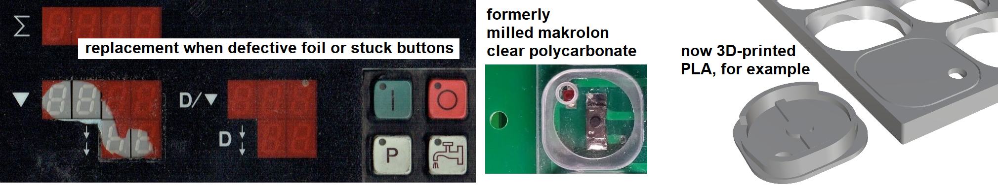

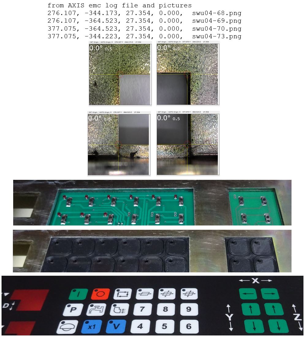

Are you building a custom control panel there?
