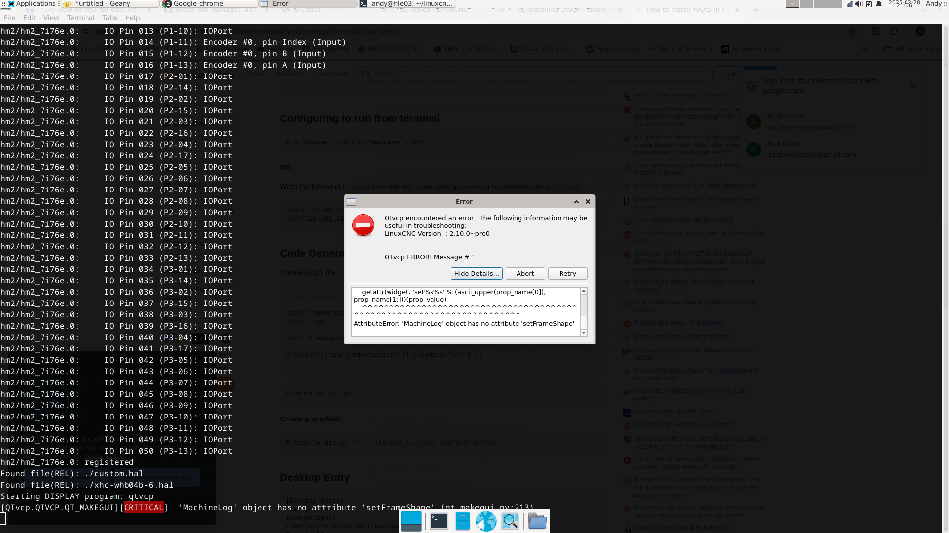

AttributeError: 'MachineLog' object has no attribute 'setFrameShape'
- gardenweazel
- Topic Author
1 year 8 months ago #322899
by gardenweazel
From code just released today: AttributeError: 'MachineLog' object has no attribute 'setFrameShape'

1 year 8 months ago #322906
Replied by cmorley on topic AttributeError: 'MachineLog' object has no attribute 'setFrameShape'
If you are using a custom .ui file then load it in designer and save it again.
If you are using a default .ui, then pull again, the fix has been pushed.
The following user(s) said Thank You: gardenweazel

1 year 8 months ago #322939
by gardenweazel
Replied by gardenweazel on topic AttributeError: 'MachineLog' object has no attribute 'setFrameShape'
Thanks Chris, this issue has been corrected.
1 year 8 months ago #322940
Sorry about the problem, unfortunately sometimes we have to break the code to move forward. Thanks for the report back.
