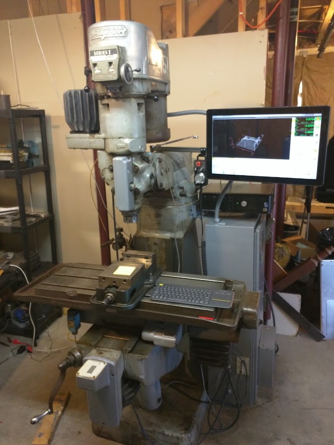

Here is my Boss 5 Linux cnc Conversion. The machine is running the original steppers driven with gecko drives and a power supply made from the original transformer a caps from the machine. The spindle is run via vfd and the interfacing is done with a Mesa 5i25/7i76 combo. I am running gmccapy with a touch screen on the machine. Below is a link to an album with pictures of the machine being moved and during various stages of the retrofit.

I was looking at doing a G0704 and then found this mill near by. In the end it cost less money and I think it will be a more capable machine. I plan to remove the vari drive and run it with a set of fixed pullies with hi and lo range with t he vfd. I also want to add an spindle encoder for tapping., maybe some AC servos in the future..... never done

The Boss is a lot beefier machine. The only down side is the limited quill travel vs the G0704. looks good. I have a friend who has a Boss that I keep wondering about getting. Did yours come with Universal Quick Switch or Kennametal style tooling?

It has the Kennametal Quick Change 30 spindle. I have started collecting tool holder for it. Having the quill for the z rather than a column is a draw back but is made up for by haveing the knee adjustment and quite a bit more travel in the Y.
