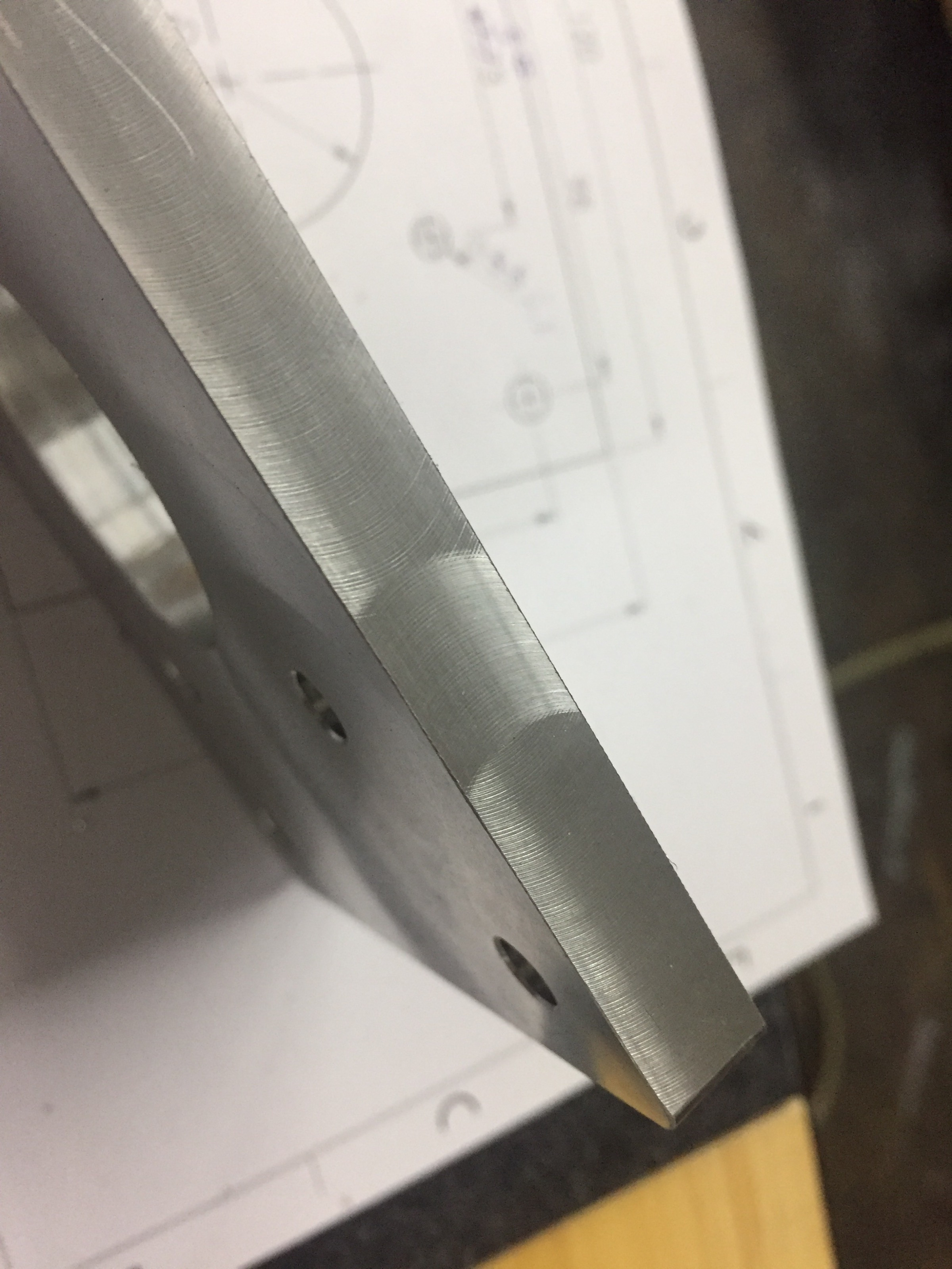

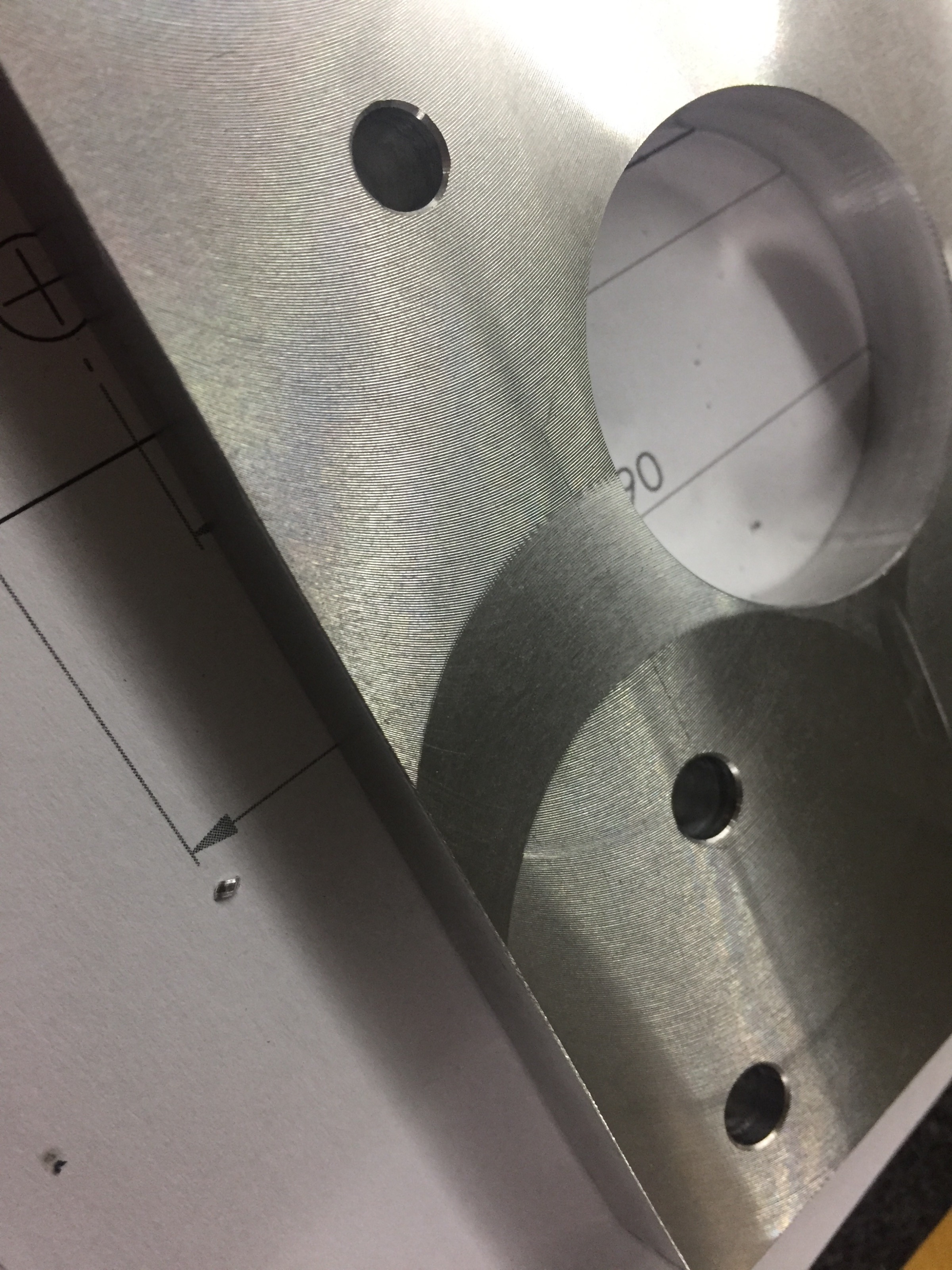

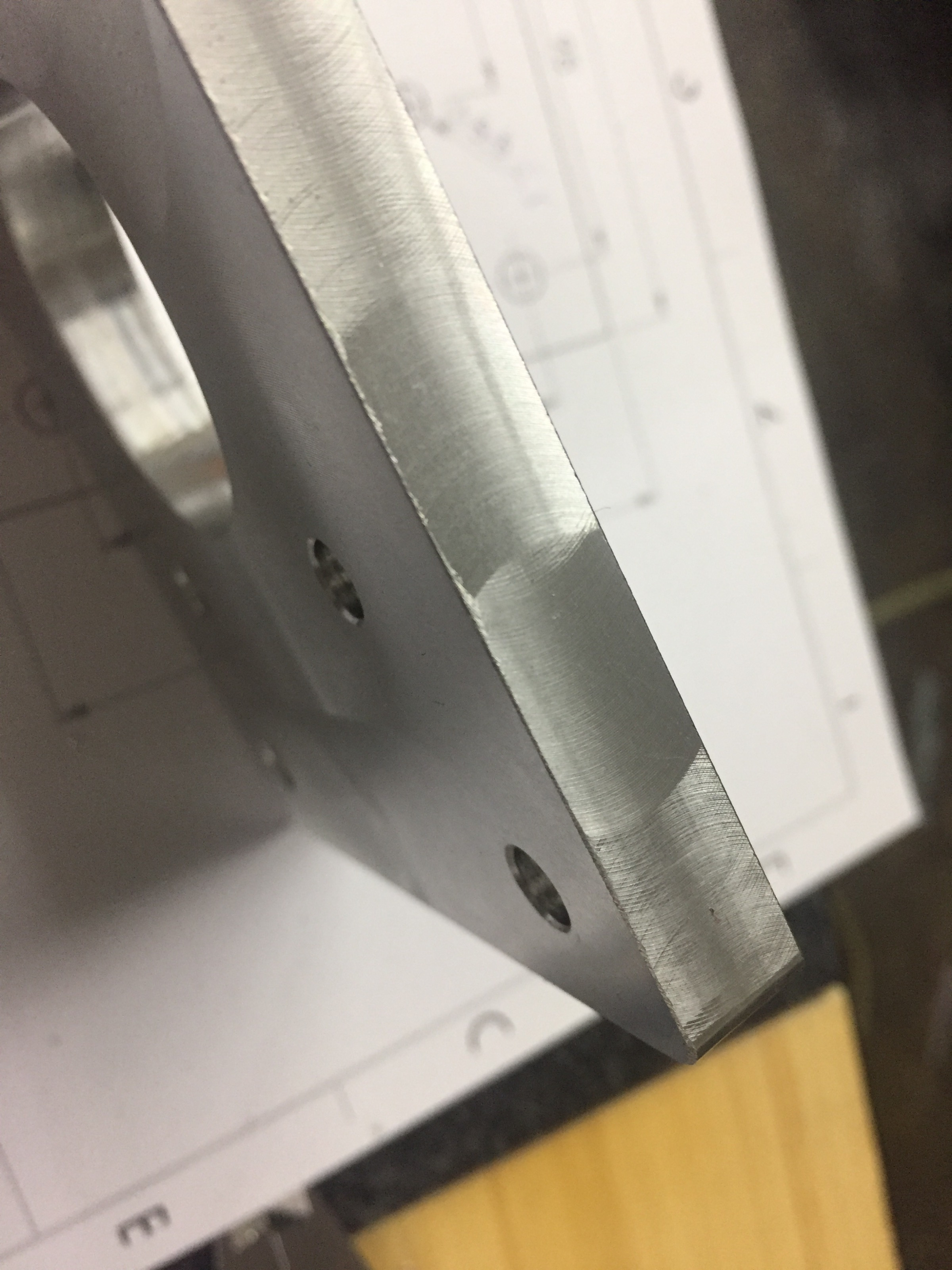

Hello guys,
I have this issue that every time I use a face mill (50mm) I get some flat spots in the surface. They are always at the same location, but I can‘t figure out where they are coming from. If I run a dial indicator over the surface they are about -0.05mm lower than the rest of the surface. My machine is a CNC’ed Optimum BF20 clone.
I recently had the machine completely rebuild and trammed in using a precision square.
My setup was using a 4“ vise, workpiece on parallels. I even get these spots when using an endmill.
What could be the reason?
Thanks in advance.
Thanks in advance.

I guess your guide tilt over at this point. Try to adjust little closer. And measure with load on table.

Blue the Z axis gib and run the machine. Pull it back out and look at the contact. You should have full contact not just top or bottom. The pattern that you are displaying looks like head rock.

I have just blued the gip and ran the Z axis up and down. I was surprised because there was good end even contact through out the whole travel!
Then I checked the table movement up and down at the end of the x axis travel. There is movement there, I would say at least 0.1mm, haven‘t put an indicator there.
Another thing I did was to move the vise around the table. When it was around 150mm to the right (where it was when I did the milling on the photos), I get a near perfect face mill finish! The vise sits now close to the right edge of the table. Maybe there is a high spot in the table?
