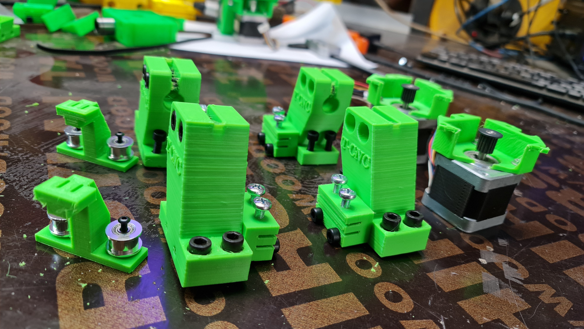

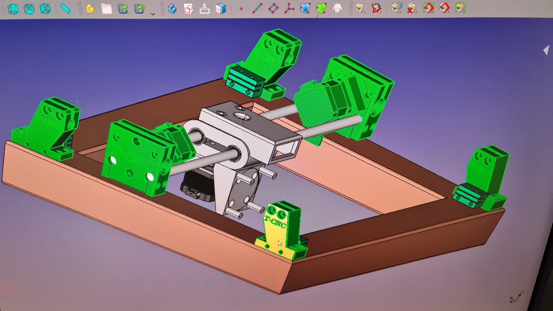

New design for a CNC engraver/etcher/scratcher ... ??? was created by tommylight
What the tiiiiiit is this thing supposed to be named?
I am going with "scratcher" from now on, all it does is scratch the surface of granite or stone or glass or wood or...

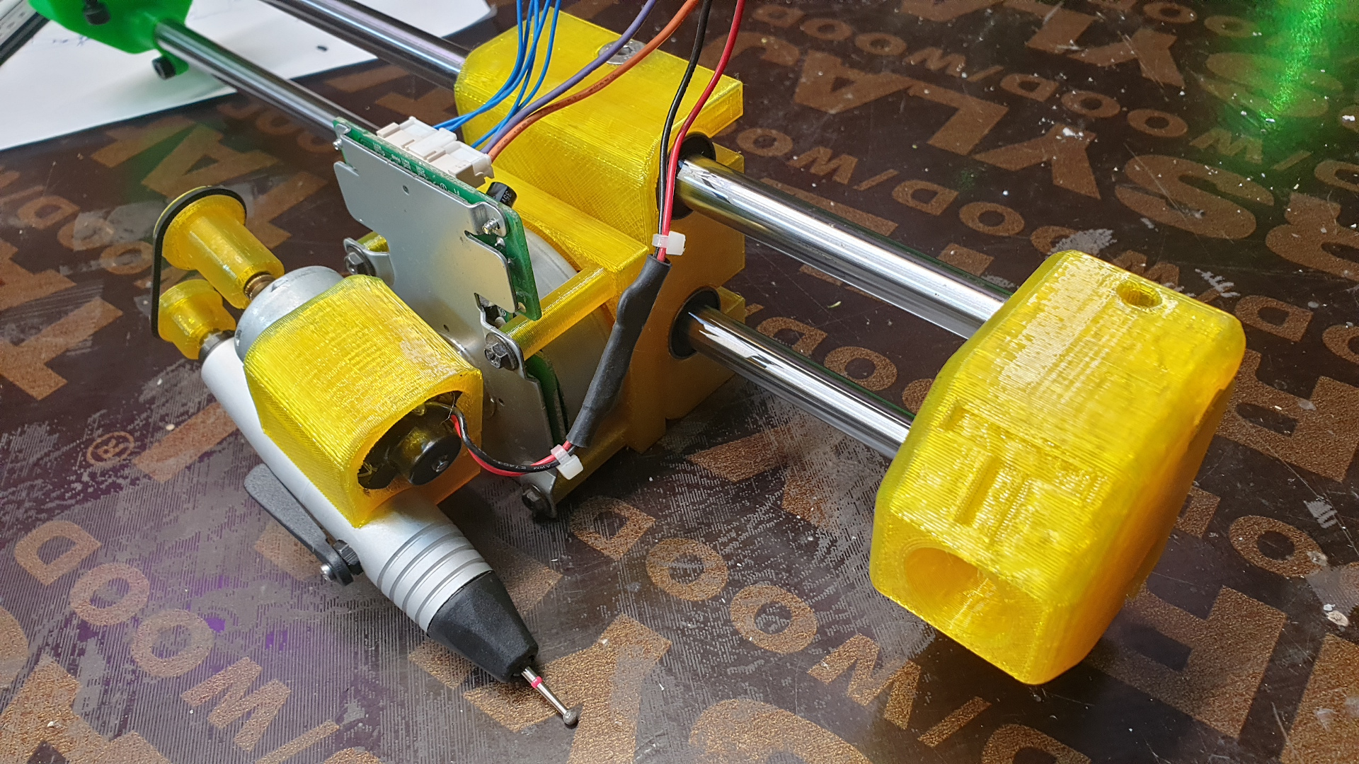

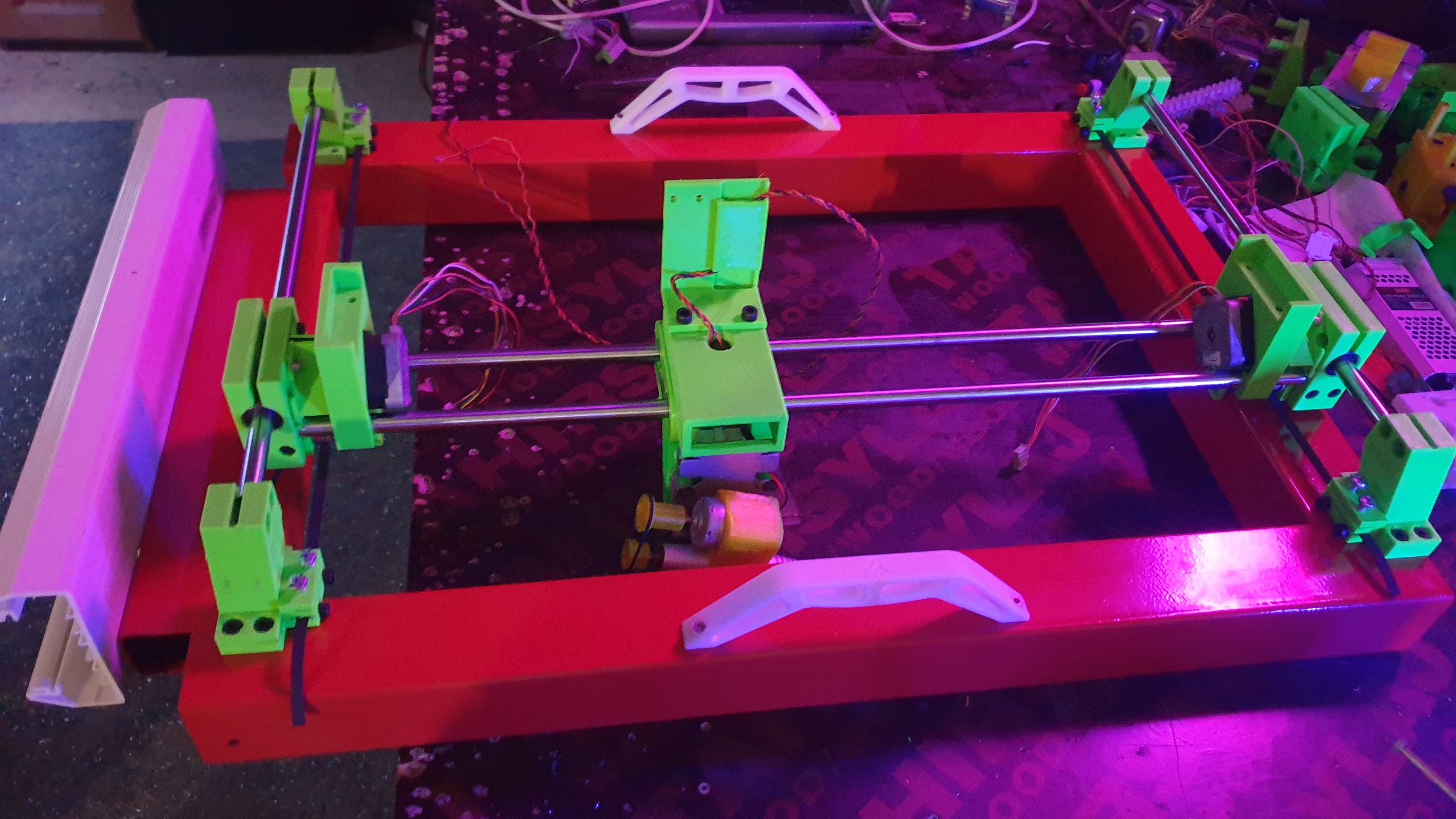

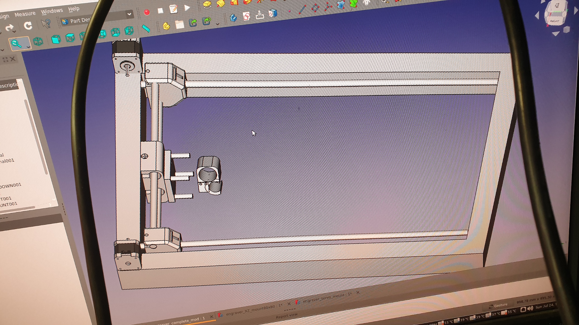

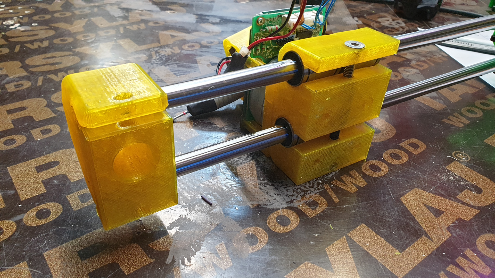

So, i thought it would be nice to do a new design for these machines i keep making from time to time and since i had to learn FreeCAD again, i gave it a go, so here are the results of the Version 1 :
and Version 2 :
and Version 2 :

27 Aug 2022 21:05 - 06 Jun 2024 20:31 #250596

Attached is the full set of STL files in case anyone wants to build one, one part is compressed using 7Z and renamed to be able to upload, so remove ".txt" before unzipping it.

Pressure motor info:
The "pressure" motor is :
-a 3 phase BLDC motors with it's own electronic controller taken out of the old photocopiers,
-there are many versions and sizes of them,
-form 5 to 10 pins,
-all signaling is sinking type or "active low", meaning connect to ground to activate
-all have the pinout printed on the board,
-older ones are pure PWM while new ones require also a clock signal,
-some are single direction while some are bidirectional,
-and most of them can be easily used for this purpose/machine,
--The PWM ones require 5V, 12-24V and an inverted PWM signal
--The ones requiring clock signal have a self check feature, so mostly work with only 12-24V supply and one of the pins tied to ground, this pin will spin the motor for about 2 second and stop, and has to be disconnected and reconnected to spin again. This pin is used as inverted PWM but scaling must be set to about max 85-95% PWM to keep the controller from tripping and stopping the motor after 2 seconds.
--for inverting the PWM pin i use a single 220 OHm resistor and a single transistor, any NPN transistor works, resistor connected between base of transistor and PWM output from PC or Mesa board.

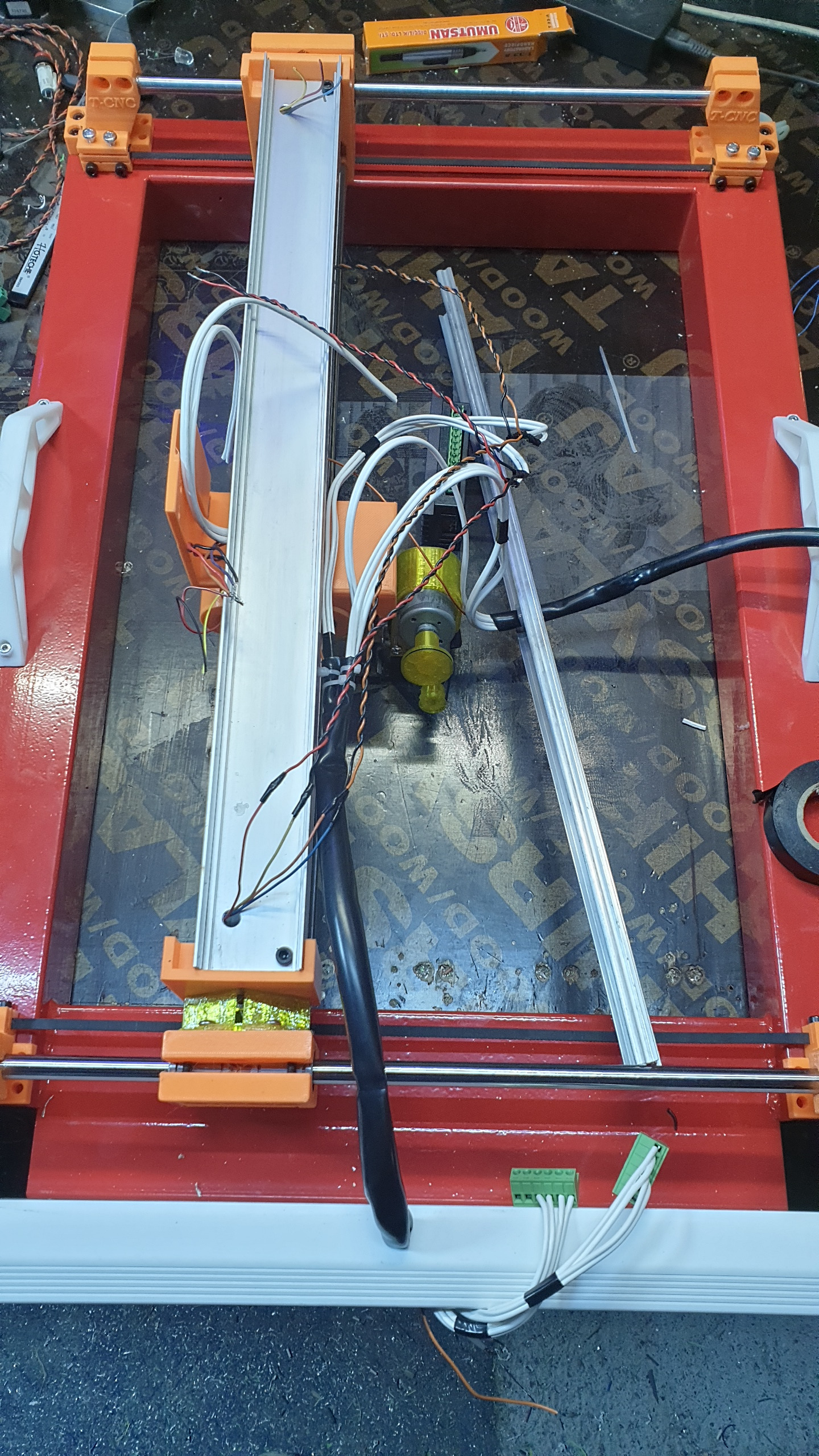

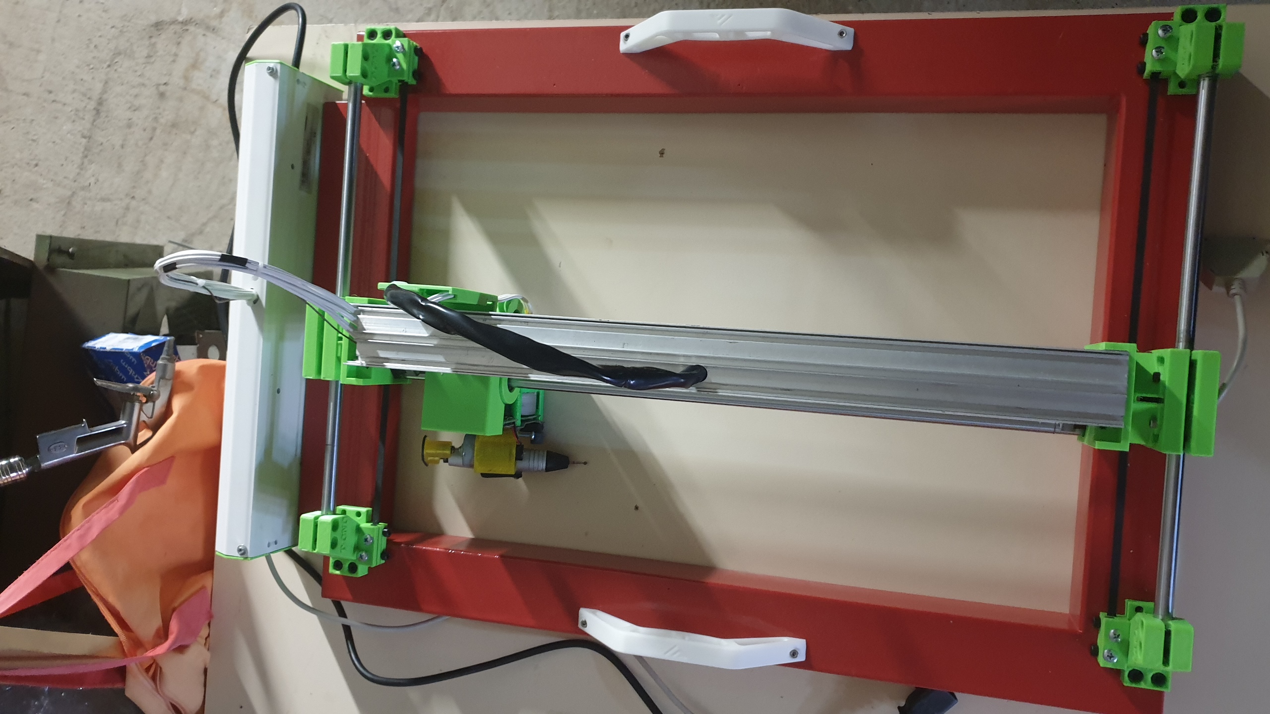

20 Sep 2022 00:20 #252372
Also finished this working occasionally on it
It has 4 motors on the Z axis so it probes 4 corners and adjusts each corner to make the table flat.
