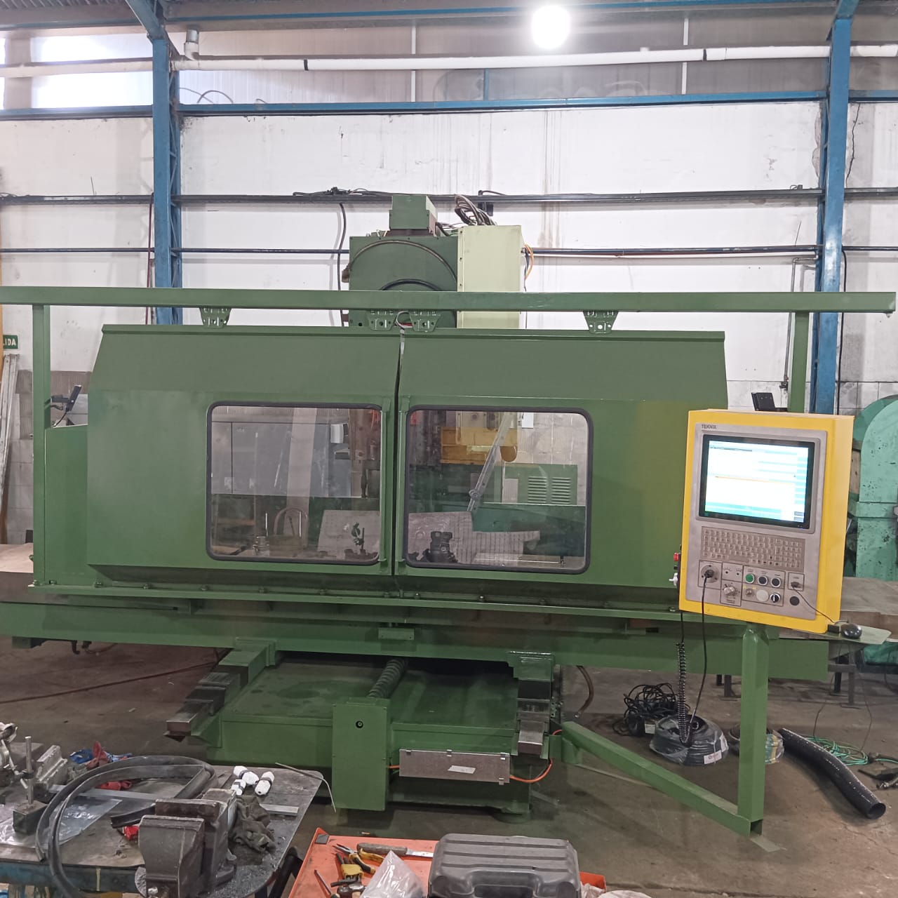

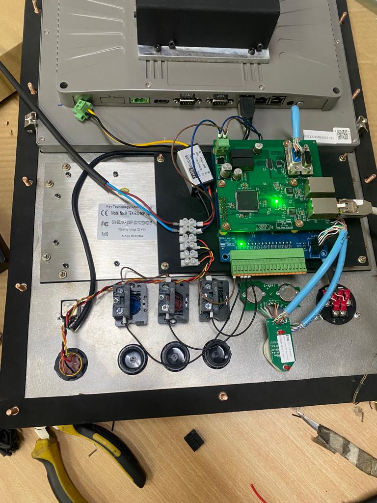

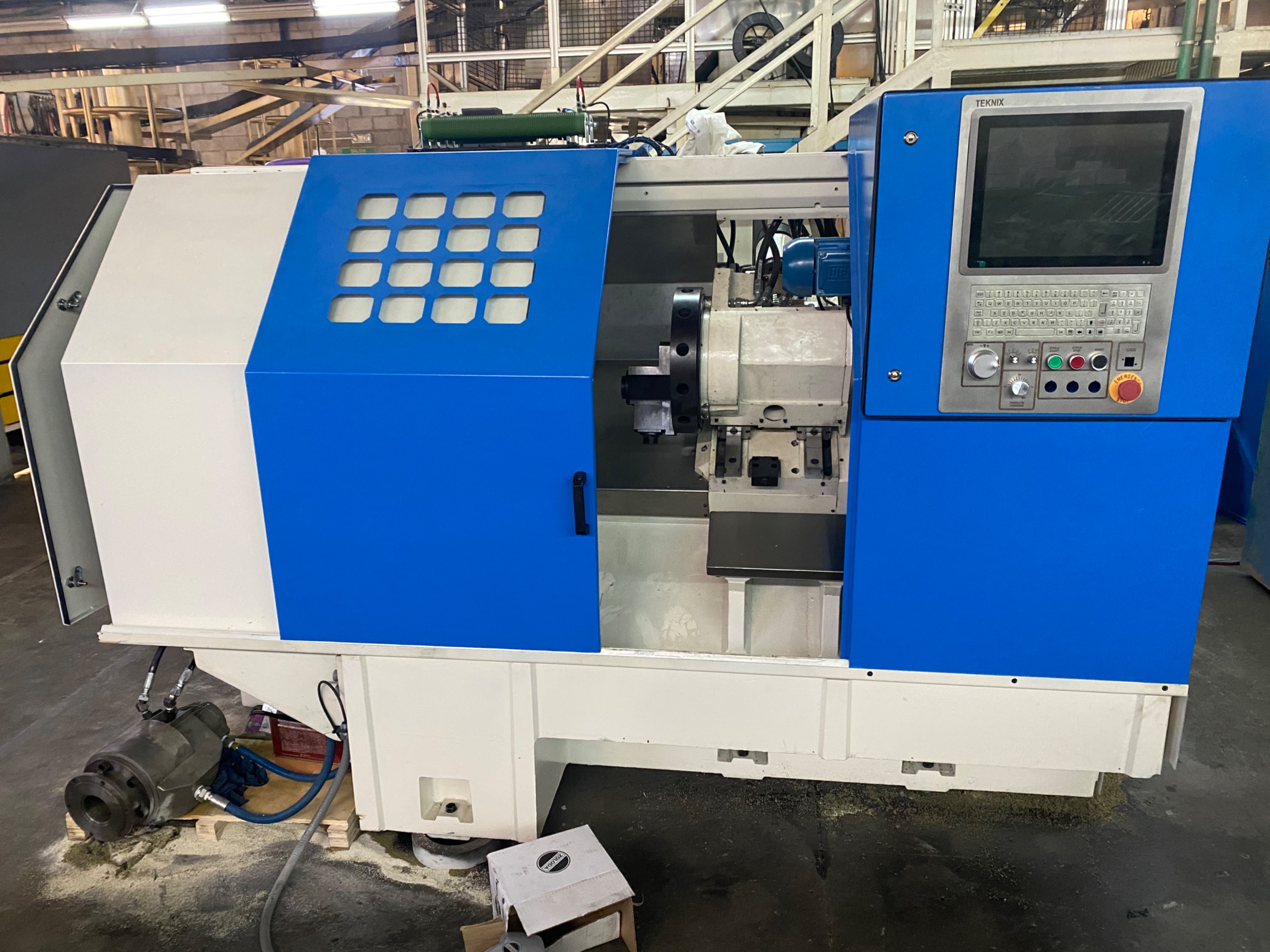

Hi Everyone,
just finished two more retrofitting, Burgmaster milling machine and Promecor lathe
hope you like them
regards
Franco
hope you like them
regards
Franco

Exactly!Check this out! I have developed a ñam Ethercat card that goes behind the screen made for override reading, mpg handwheel, start stop reset , and any button you want (feedhold for example)

Very nice.
My plan is similar, but based on existing hardware due to my nonexistant board-development skills...
7i73 with a matrix keypad. All buttons except cycle start/stop, and feed hold will be run though the 7i73. Single-block, block skip, axis homing, ATC rotation, etc. all on direct I/O. MPG will be to the 7i73, as will the usual selector switches for axis & increment.
Cycle start/stop & FH will be direct to a 7i76.
Hoping to incorporate a HAAS-style MPG where the axis selector will also have two additional detents to control FRO & SRO - so the MPG is both a jog wheel and override encoder. The 100-count MPG should make for good fine-tuning of the feedrate and cut down on operator panel overload.
Replied by spumco on topic Two retrofitted machines ready for doing some work
Very nice.

16 Oct 2022 09:08 #254223
by fsabbatini
Replied by fsabbatini on topic Two retrofitted machines ready for doing some work
Perfect, that’s exactly what my board does. And it is waaaay simpler than using mesa as wiring is just easy enough for everyone to do.
New version support 1 mpg, axis selector up to 5 axis, increment selector x1,x10,x100. 8 24v pnp inputs for user pushbuttons, 8 24vdc outputs for driving leds of those buttons, feedrate override knob up to 21 positions.
I decided to go this way because I don’t use mesa cards, all Ethercat based si you just go with one wire from pc to board and then to drives and finally to io board. Easy, not a wire mess.
Anyway this board can be expanded for as many io needed. I had a model before with 55 physical buttons but nowadays manufacturer are reducing button count just for motion control and specific always used functions like coolant on/off, chip conveyor on off, etc
I can make a board and send it to you if you like
Cheers,
Franco
Cheers,
Franco
