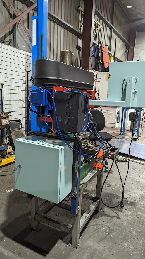

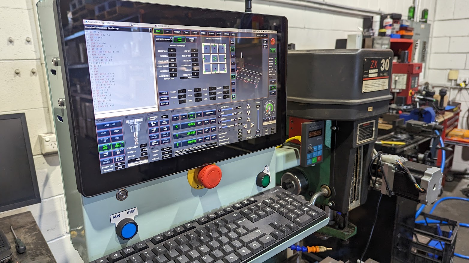

I did this mill 12 months ago as an experiment with ethercat drives (which are awesome by the way).
But I only had a1536 x 768 monitor so could not run any if the cool new GUI's
I settled on qtdragon-hd and cmorely has done a lot of fixes bsed on my feedback. Thanks Chris!

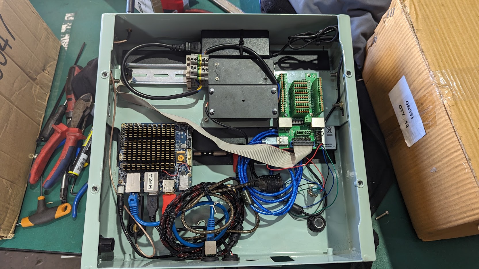

Today my industrial paenl mount monitor arrived. I had to do a bit of hacking to make it fit becasue it has a bezel around it.
Inside there is a Odroid HM2+ running Bullseye on the left and a custom breakout board originally foe an Odroid and a Mesa 7i73.
It breaks out a few Odroid signals to get an extra USB port

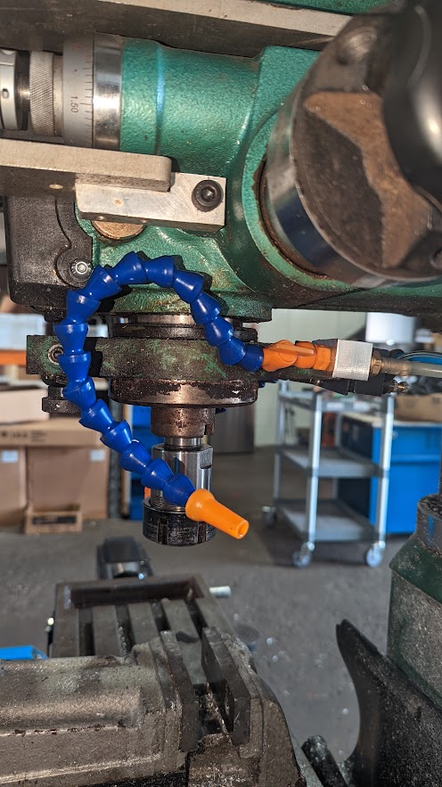

Thanks, rounded up a few more photos

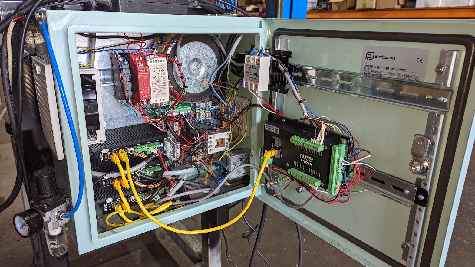

Ethercat Control box
We have coolant and mist

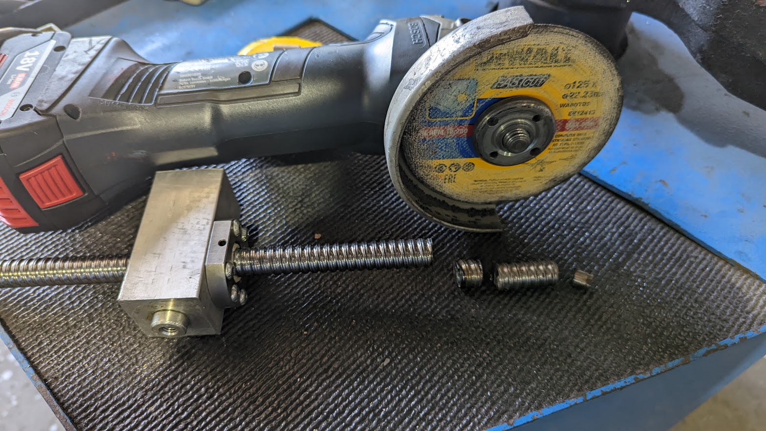

Y Axis ball screw including some adjustments to length

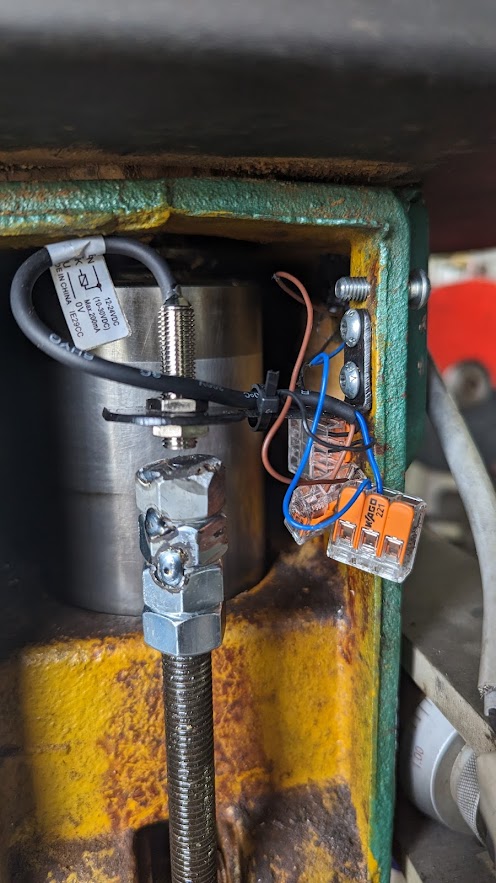

Z axis home switch. The prox sensor failed so I used the Wago connectors when replacing it. This was a cool idea Because when I wired in a probe, I had one spare wire up on thee head so picked the power up here.

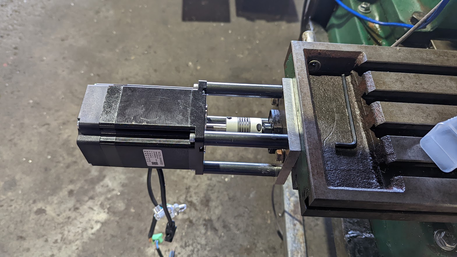

The ball screws were pretty easy to mount. Just replaced the lead screw mount.
I added a MAsso encoder which uses a paper target mounted on a plasma cut disc.

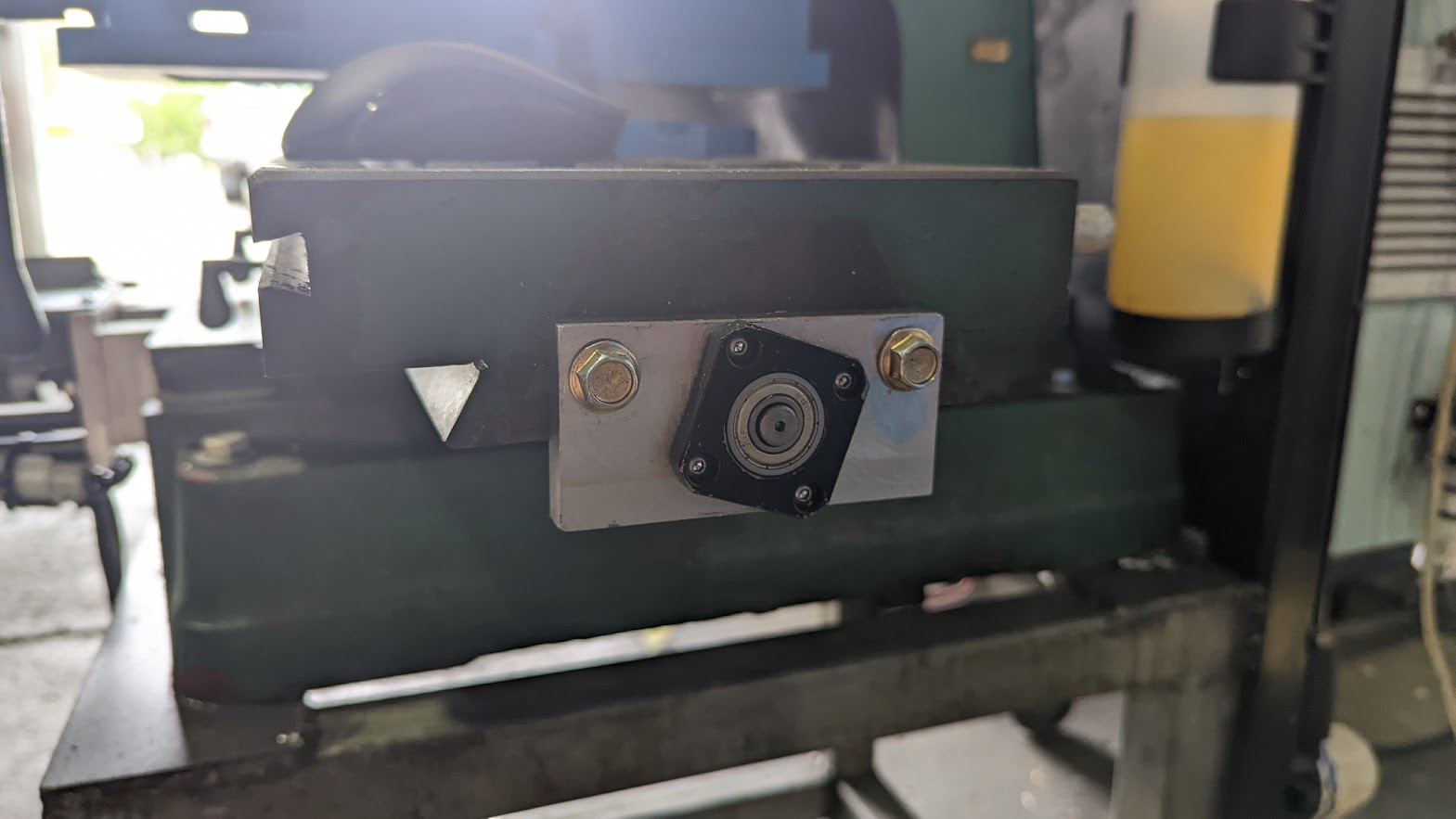

X axis motor on 16mm dia standoffs.This is my preferred method to mount motors even if it's not pretty! It easy to do with a M6 male thread at one end and a M6 female thread at the motors end. It gives plenty of access to the coupling etc and you can adjust the alignment by winding legs in and out...

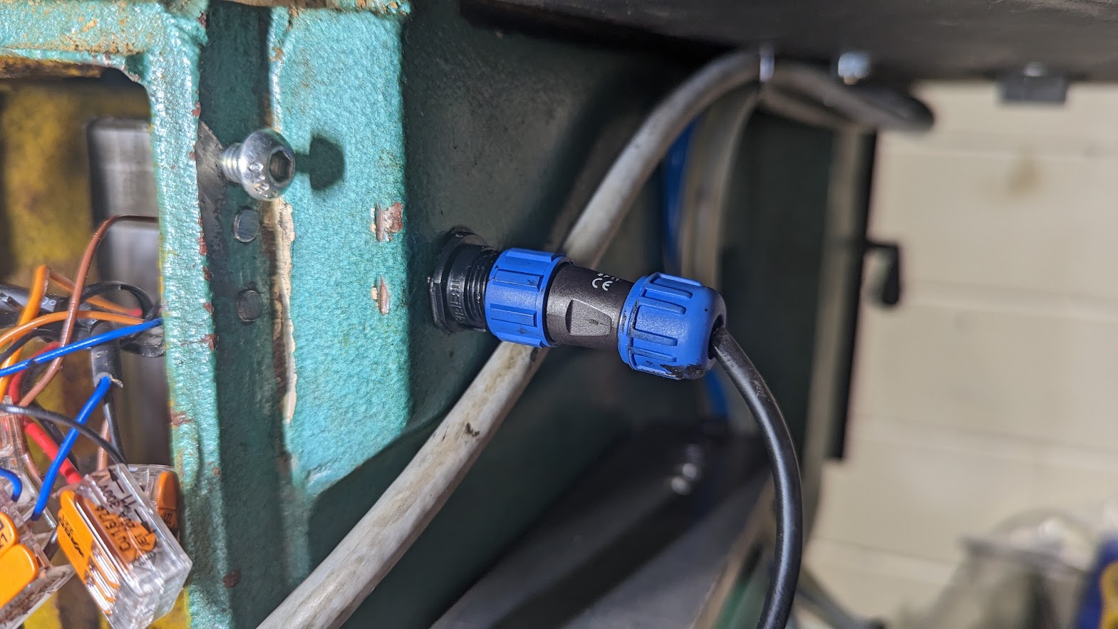

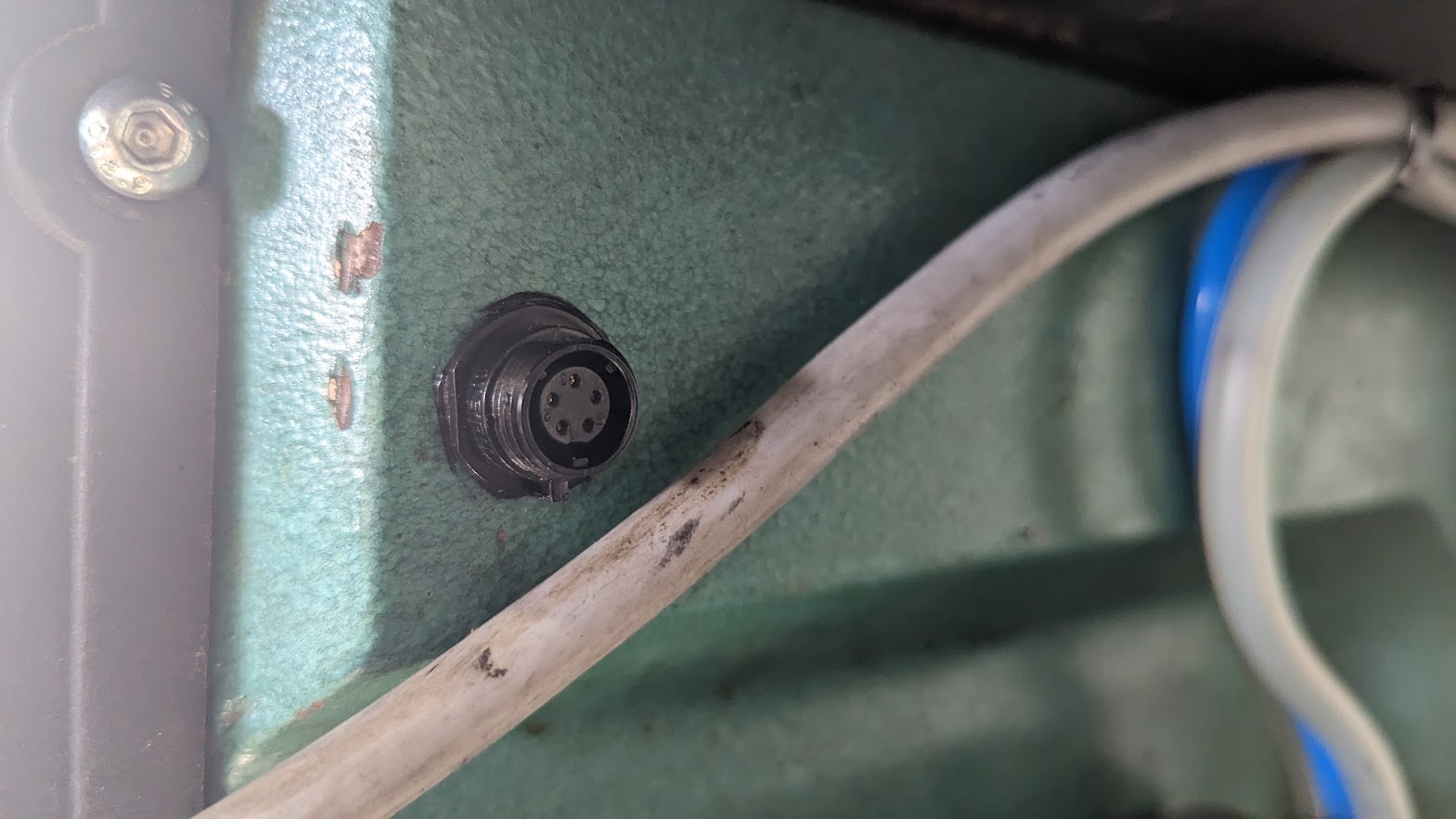

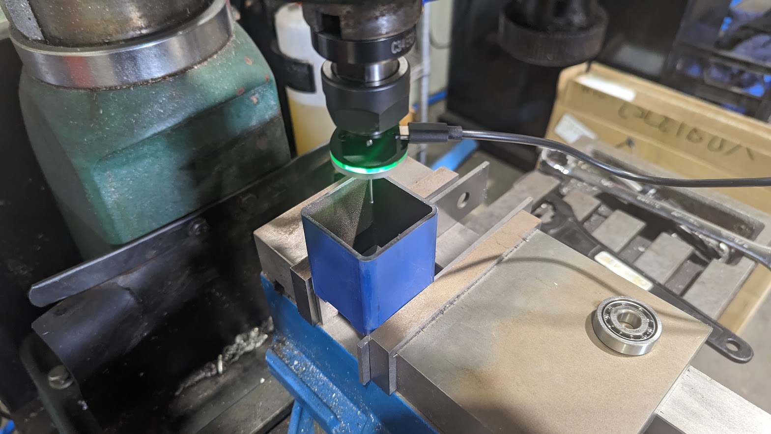

Probe socket wired in. I was a bit annoyed because the Weipu connector uses a M11 thread (who does that?)so it's glued in with sikaflex.
Probe plugged in

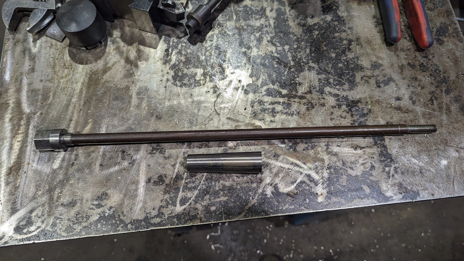

New MT3 drawbar I made. (bloody imperial threads!
Genuine Tormach Mt3 collet from Little Machine Shop in the US.
You can't use an ordinary collet. It's too long and if you cut it down, there is not enough room in the collet to hold the TTD Holders.
Ask me how I know this!
One of the many probing tests I've done for cmorley as he cleans up the probing routines in QTdragon_hd.
They are now pretty good. I've only busted one probe so far because I forgot to plug the probe in!

All ethercat hardware is from Rtelligent. The toroid power supply is 60 volts AC so there is plenty of grunt (must be up around 90v DC at the motor.
