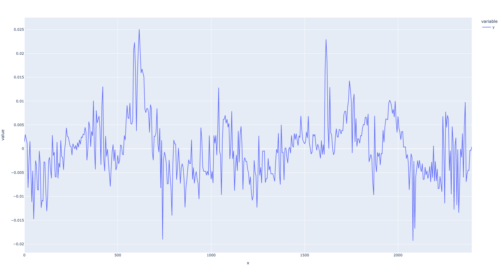

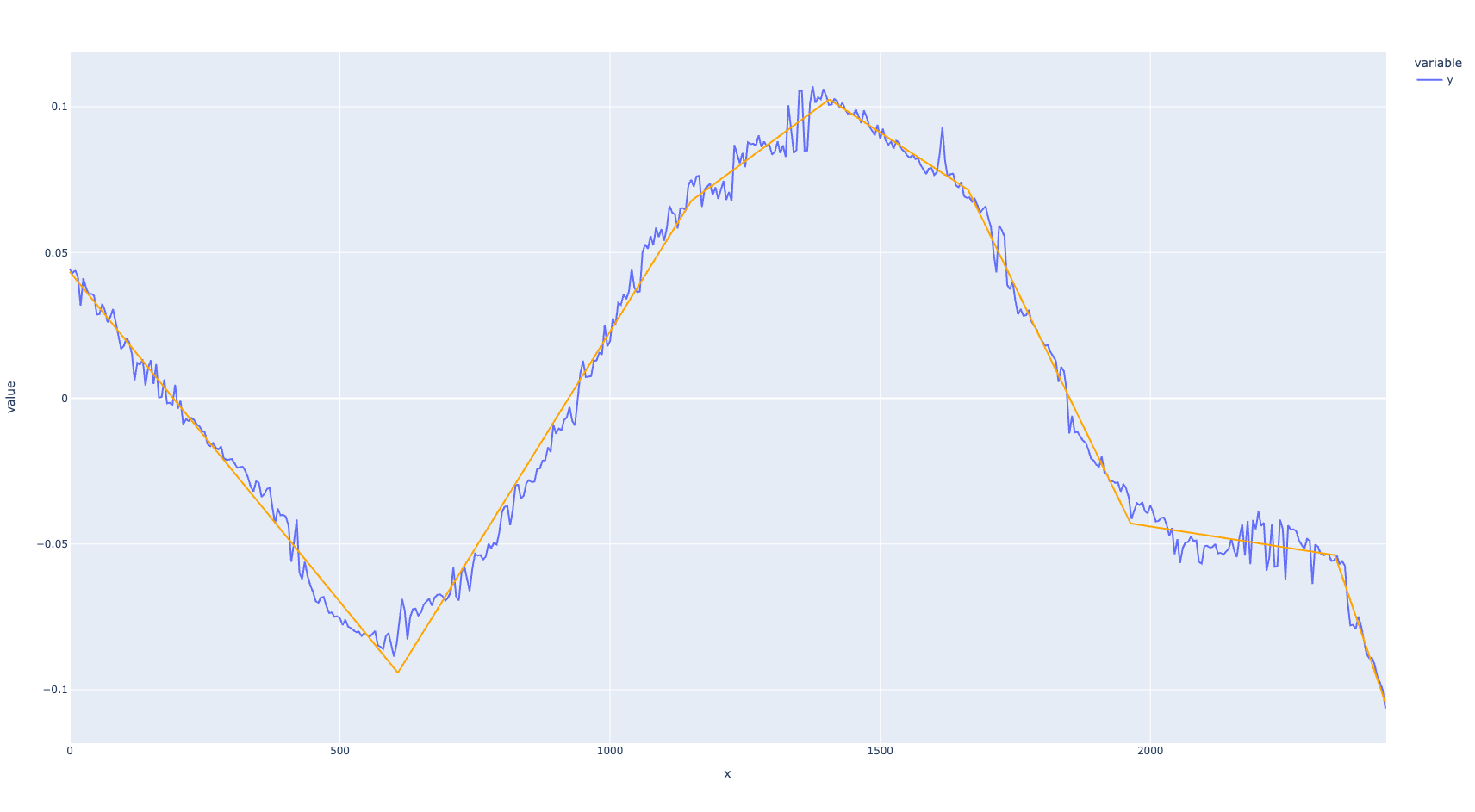

I built my own CNC router with the long axis (I called it X for various reasons) at about 2.7m. It's all on 8020 profile and no matter how I tweaked it, I could never get the gantry to move in a straight line. It would shift reliably +/- 0.1mm (or about 0.005in), so I had an accuracy problem that was too large for my liking.
I got this same plot over and over at multiple Y locations, so lincurve would be a good solution here together with offset .
Essentially, lincurve lets you define an equation of sorts, then lets you map the x value to the y value. In this case, I would map the input of my X of where the spindle is to the output offset I want to move my Y axis. The reverse of the error you see in the graph above. Then I use that offset and implement it in the controller using HAL offset.
The "equation" that you give lincurve however is not your usual y=f(x), but multiple points (up to 16) on the x,y graph. The lincurve link above explains it better than I would.
Here is a snippet from my HAL:
And voila:

And voila:

lincurve requires multiple linear regressions (up to 16-1=15) that have the constraint that all regression lines meet at their ends. For this minimization problem I used the python
piecewise linear fitting library
Broken down, you give it the x,y data, and in this case tell it how many breakpoints you want (for lincurve we can go up to 15), and if you have enough datapoints you usually get a globally minimum solution.
Here's the python code:
Just pip install the dependencies at the top. All my python is for 3, I haven't tested it on 2.
The datafile is generated from an ngc probing routine I wrote, and needs to look like a CSV (cut short for visibility) for the program above to read it correctly:
