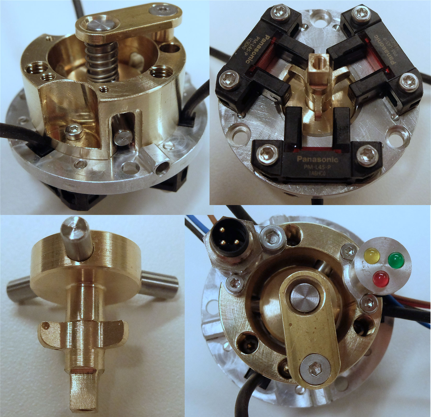

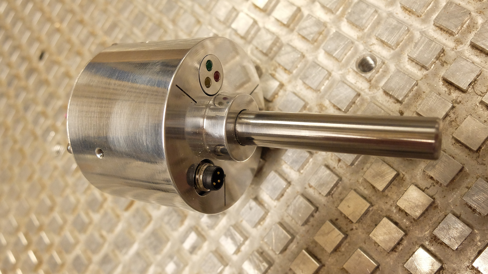

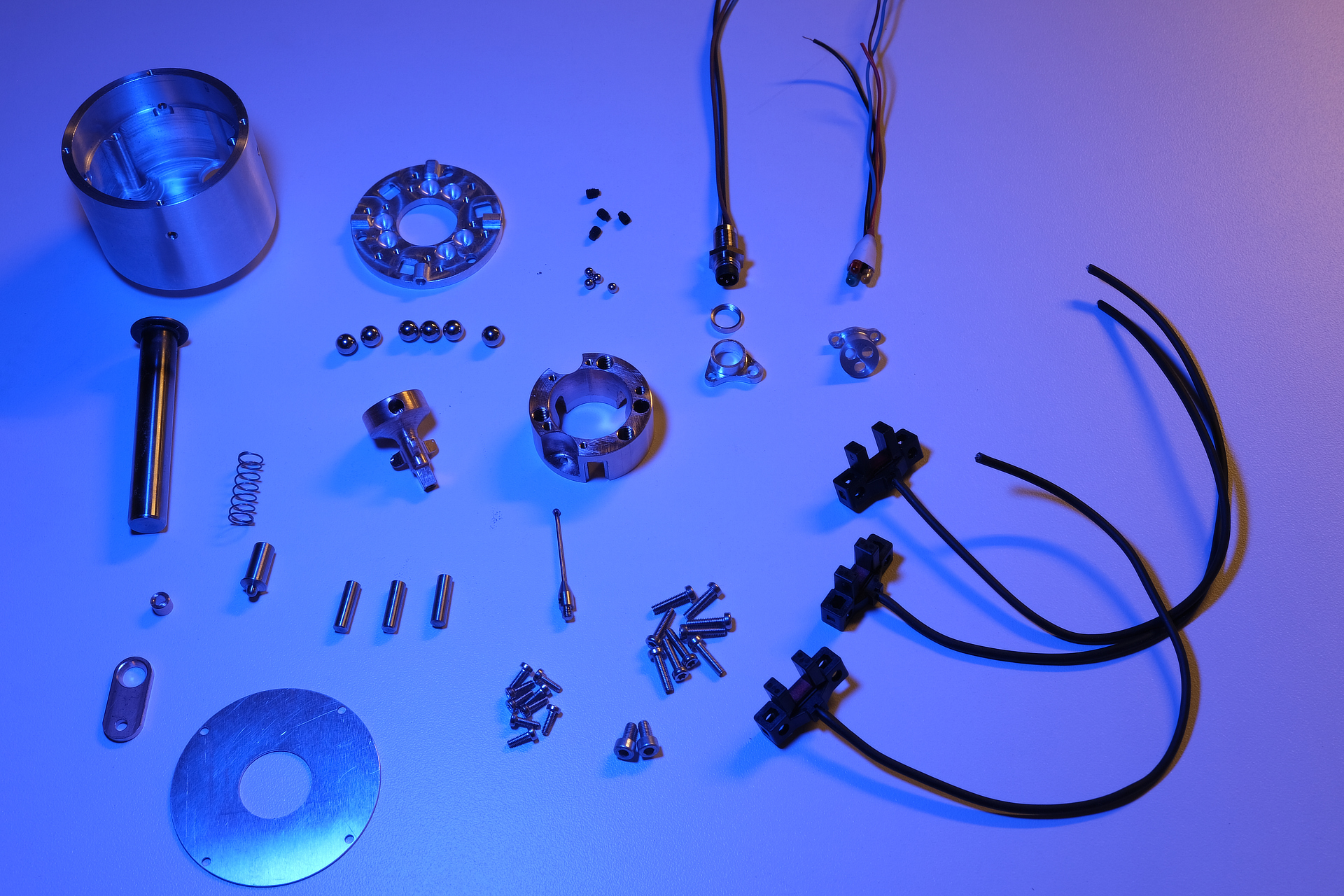

01 May 2024 18:50 #299498
by MaHa
Probe was created by MaHa
The following user(s) said Thank You: tommylight, Clive S, rodw, Unlogic

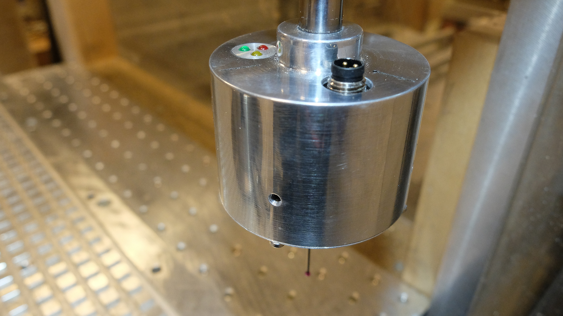

10 May 2024 04:32 #300287
by DEVILHUNTER
Replied by DEVILHUNTER on topic Probe
Really cool. Do you read the photodiodes directly? The amplification circuit with a precise comparator to activate the probe with the slightiest change in light is key. Have you measured lobule error? This optical probes have better performance on that that pure kinematic ones, a must for machines without spindle orient.

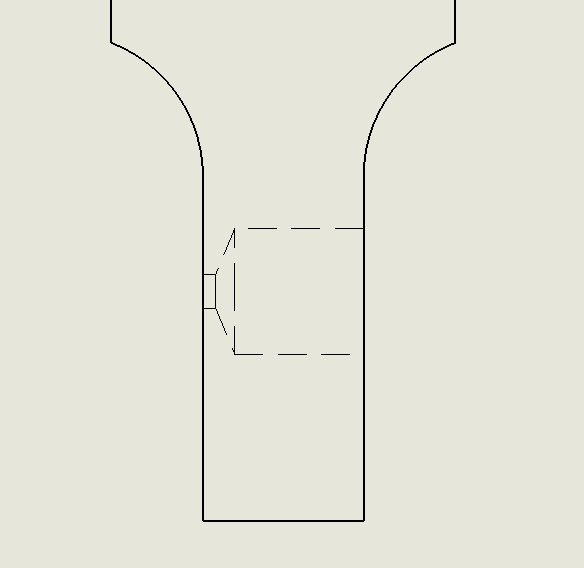

10 May 2024 11:02 #300303
by MaHa
Replied by MaHa on topic Probe
There are 2 PNP output, light-on (used for the led's) and also dark-on, which trigger probe input. The object to control the lightbeam looks like this, the small diameter is machined 0.25 - 0.3mm. Years ago i did some testing about this, and this design worked well for me.
I clamp the probe in oriented position, but it needs compensation. My probing routines can handle multiple probes 4, quadrants error compensated. I use the toolnumber for the compensation file, eg T999, to call the compensation parameter, 'o#5400 call' does read 999.ngc and loads global variables for this probe. Then the results are repeated within 0.02mm
