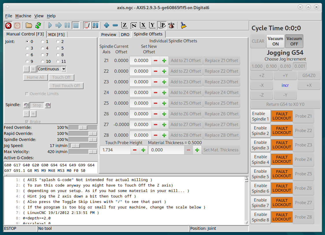

This 8 spindle gang router with 8 independent Z axis (using closed loop stepper motors), tandem servos for the Y axis gantry, and a servo on they X axis.

Then I'm attaching a copy of my config directory so others can see how I implemented the individual Z axis joints.  The Z axis is set up as a dummy master joint that automatically homes.  Each spindle joint is set up as an "extra" joint.  There is a GladeVCP panel that lets the operator enable and disable each of the spindles.  When a spindle is enabled, that spindle's Z-joint is connected to the dummy master's position plus a tool offset.  When it is disabled the spindle's joint is moved back up to it's home position.  This way only the spindles actually being used are ever moved with the Z axis.
There are also buttons on the Glade panel for tool probing routines for each of the spindle Z-axis.  These disable all of the other spindle Z-axis and enable the one being probed, then sets the tool offset for that spindle according to the probe results.
Then I created a GladeVCP tab window for displaying and manipulating the tool offsets for each of the spindles.
