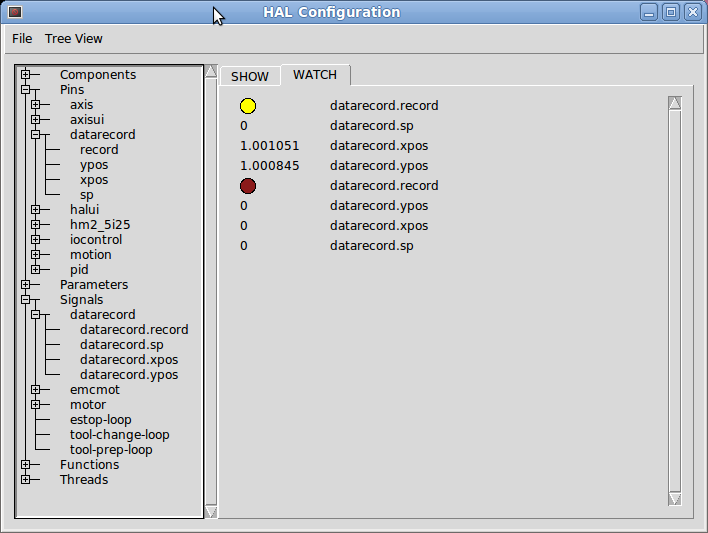

14 Aug 2012 16:56 #23172 by mcenter
Replied by mcenter on topic Re:Collecting data with Arduino and Python
I only need to read the spindle power in around 1 second intervals. I really don't care when I record a reading, as long as I know when a reading has been taken within .1 second, or so.
Sometimes, I will use a screwdriver for a pry-bar. I always keep a Crescent wrench handy, although I have SAE and metric wrenches from very small to quite large with extra copies. The trick is realizing when you really should use a pry-bar, a box end wrench, or a gas hatchet and sledge hammer.
This is the HAL I used:
loadusr -Wn datarecord data_recorder.py
net record-flag datarecord.record <= motion.digital-out-00
net spindle-speed datarecord.sp <= motion.spindle-speed-out
net x-rel-position datarecord.xpos <= halui.axis.0.pos-relative
net y-rel-position datarecord.ypos <= halui.axis.1.pos-relative
A waitusr command would be superfluous.
Using M62 P00 followed by G1 X1 Y1 MDI commands (M62 doesn't take action until motion command), the signals change in the watch window, but datarecord pin values do not. (As seen in the attached watch window.
My Python script only writes the .csv header for the file, apparently h is never set to TRUE.
Thanks for all the input. I am still very much in the learning phase regarding linuxCNC, HAL, Python and C. I do plan to implement this as a comp later for a learning exercise. But, my summer is almost over, and I am behind schedule on my research. If I can't resolve these issues, I'll be out there with a clipboard and a stopwatch (think gas hatchet and sledge hammer).
