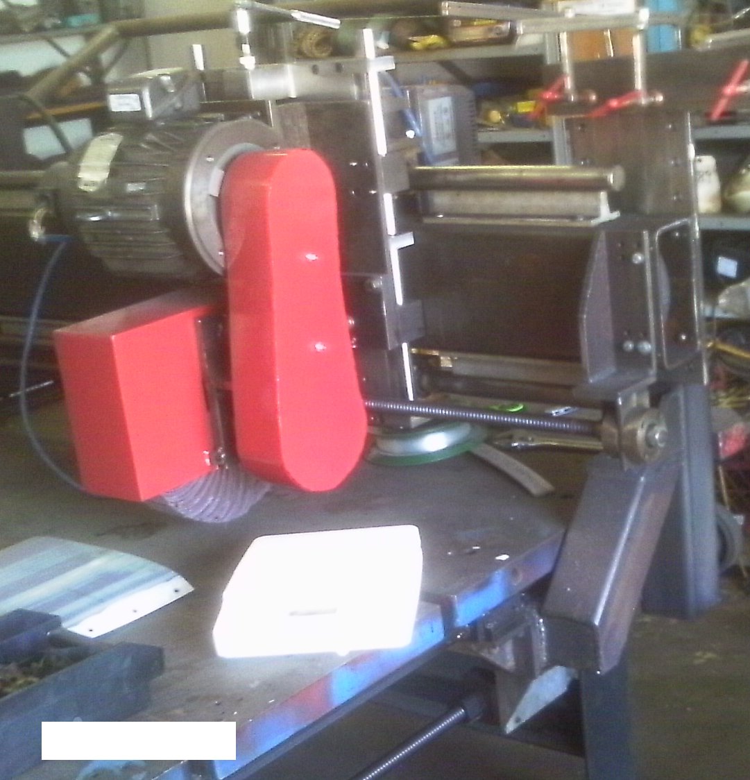

My HAL file.
I don't know how to place multiple files in one post.
Now, I just need to connect my spindle.

Holy Moly! what is it?
