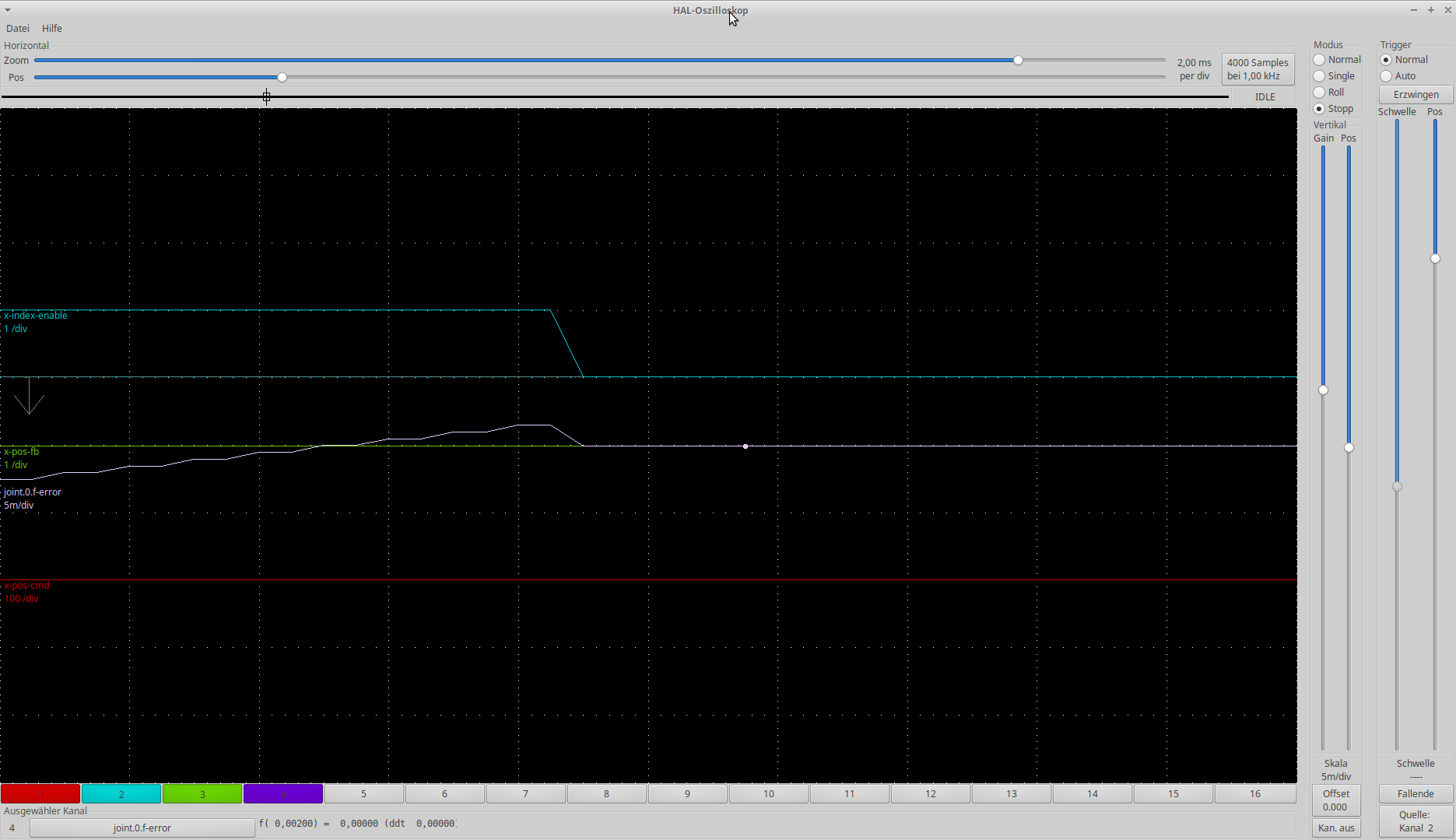

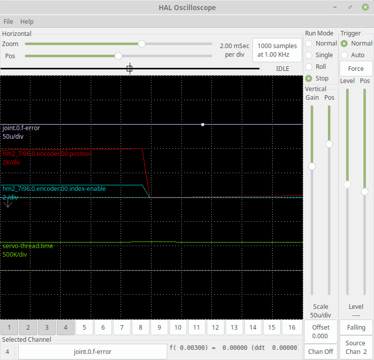

This is a Heisenbug. As soon as i attach the HalScope, those axis/joints I watch do work as supposed.
- rmu
- Posts: 279
- Thank you received: 101
22 Apr 2020 07:56 - 22 Apr 2020 08:04 #165055
by rmu
Replied by rmu on topic Following Error When Homing
Got it. Don't know what to make of it. Following error explodes one servo period after index-enable is 0. Second screenshot is from second attempt, when it works. x-pos-cmd when zoomed in looks exactly like f-error.
Last edit: 22 Apr 2020 08:04 by rmu. Reason: Add second screenshot.

22 Apr 2020 12:03 #165082
Replied by tommylight on topic Following Error When Homing
Those screenshots point to axis not being tuned properly.

22 Apr 2020 12:28 - 22 Apr 2020 12:30 #165092
by rmu
I'm pretty sure the tuning can't be much improved at this (low) speed (without changing to a higher res encoder).
You mean the following error increasing? It always stays below one encoder count. I think the stairsteps you see are an artifact of some kind of interpolation based on velocity and interval. One encoder count amounts to 8µm.Those screenshots point to axis not being tuned properly.
Last edit: 22 Apr 2020 12:30 by rmu.

22 Apr 2020 15:16 #165118
by rmu
Maybe that has to do with pid.x.error-previous-target true. I will try again setting this to false.
- Posts: 18026
- Thank you received: 5295
22 Apr 2020 15:34 #165122
Replied by PCW on topic Following Error When Homing
Well it _should_ not (index-enable should be an input only to the PID component)
