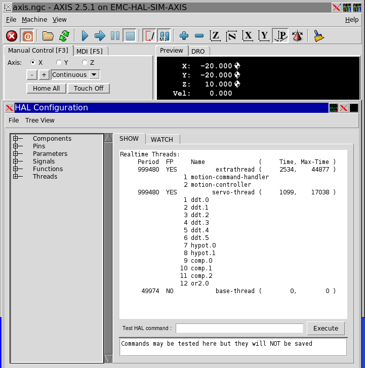

I could not see why it would not work, so I amended a sim config (axis_mm.ini and core_sim.hal) as below.
[EMCMOT]
EMCMOT =              motmod
COMM_TIMEOUT =          1.0
COMM_WAIT =             0.010
# BASE_PERIOD is unused in this configuration but specified in core_sim.hal
BASE_PERIOD  =               50000
SERVO_PERIOD =               1000000
loadrt [EMCMOT]EMCMOT base_period_nsec=[EMCMOT]BASE_PERIOD servo_period_nsec=[EMCMOT]SERVO_PERIOD num_joints=[TRAJ]AXES
# load 6 differentiators (for velocity and accel signals
loadrt ddt count=6
# load additional blocks
loadrt hypot count=2
loadrt comp count=3
loadrt or2 count=1
loadrt threads name1=extrathread period1=1000000
addf motion-command-handler extrathread
addf motion-controller extrathread
and the result, thread created and motion.command and motion.controller running on that thread
So not sure what to suggest, perhaps space loading away from EMCMOT or maybe you have a typo?

I reduced the extrathread period by half and got this error in the kernel log
HAL_LIB: ERROR: new thread period 500000 is less than existing thread period 999480
THREADS: ERROR: could not create thread 'extrathread'
I did check in case EMC_MOT leaves threads.ko loaded, but that is not the case. (I suspect it does not use it)
