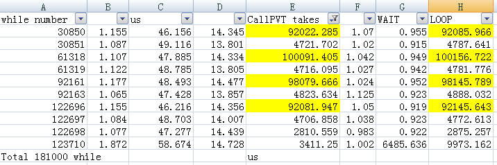

I am using Turbo PMAC2A PC/104 to control a robot,the PMAC connect the upper computer by ISA bus. The O.S of the computer is ubuntu10.04 kernel 2.6.32-122-rtai.
The upper computer is responsible for generat the position velocity and send them to the rotary buffer in PMAC. Because the robot require a quick response to the environment, thus a long delay are not permitted. Actually, we send the position every 10ms, and we want to guarantee that the rotary buffer should not hungry and also not too much comand lines remaining in the buffer, therefore, I initial two command lines in the rotary buffer.
I test it two times, and each were taken half an hour. and repeated 181000 times and also call the following functions to send command to PMAC, in the most of time, the send PVT time are small ,however in the 44390 while loop it takes more than 100ms , and also several times exceed several ms, which will cause the hungry of rotary buffer and are not permitted in my system.
What's wrong with it? Whether there have some special fuction in RTAI to replace them? Can you help me?

//This file shows the function add position and velocity to Rotary buffer, and the function for sending command to PMAC.
void PMAC::RotaryBufferAddPositionVelocityLine(int* pos_m,int* vel_m)
char cmd[256];
char value[15];
string answ;
strcpy(cmd,"OPEN ROT");//NOTE:Should change to coordinate system.
SendCmd(cmd);
strcpy(cmd,"X");//From strcat change to strcpy
sprintf(value, " %d", pos_m[0]);
strcat(cmd,value);
strcat(cmd,":");
sprintf(value, " %d", vel_m[0]);
strcat(cmd,value);
strcat(cmd," Y");
sprintf(value, " %d", pos_m[1]);
strcat(cmd,value);
strcat(cmd,":");
sprintf(value, " %d", vel_m[1]);
strcat(cmd,value);
SendCmd(cmd);
strcpy(cmd,"CLOSE");
SendCmd(cmd);

Thanks for your information, I have download the ubuntu10.04 kernel 2.6.32-rtai from this website, I ask question in other formus,but no one answer me, so I came here and your are very nice and patient to help me.
I am new for this O.S even new to linux. I am not clear whether I am using Linuxcnc? I can only find the liblinuxcnchal.so.0(Not liblinuxcnchal.so) in filesystem, However, I can not find the rtapi.h in it.
since I have change the code to ( sprintf(cmd, "X %d: %d Y %d: %d",pos_m[0], vel_m[0], pos_m[1], vel_m[1]); Test it again , the result were not improved , and about every five minutes in the begining, it wil cost long time to finish the calling of the function. You can see the exactly result in the attachments. I am not sure whether it was related to use the sprintf.
The table shows the 10 largest terms of calling the PVT function in total 181000 cycles.
Actually, I have already use the rt_printk() to show the time.
By the way, can I use the rtapi_snprintf() for test, and how?
Thank you very much!.
