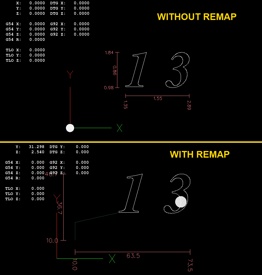

When remap toolchange is activated, the displayed working area includes the tool change path (see attached image).
Is there any way to limit this display to real cutting area, as it is done when remap is not activated ?

You mean the little dog leg rapid path?
If the remap uses Oword subroutines for tool change try these commands:
www.linuxcnc.org/docs/2.5/html/gui/axis....axis_preview_control
I haven't tested them but the they should work.

Thank you, it works now !
I use a pair of (AXIS,hide) (AXIS,show) in my subroutine.
The most annoying issue was the program extents display, now it is ok.
Tested successfully under Gmoccapy.
Frederic.
