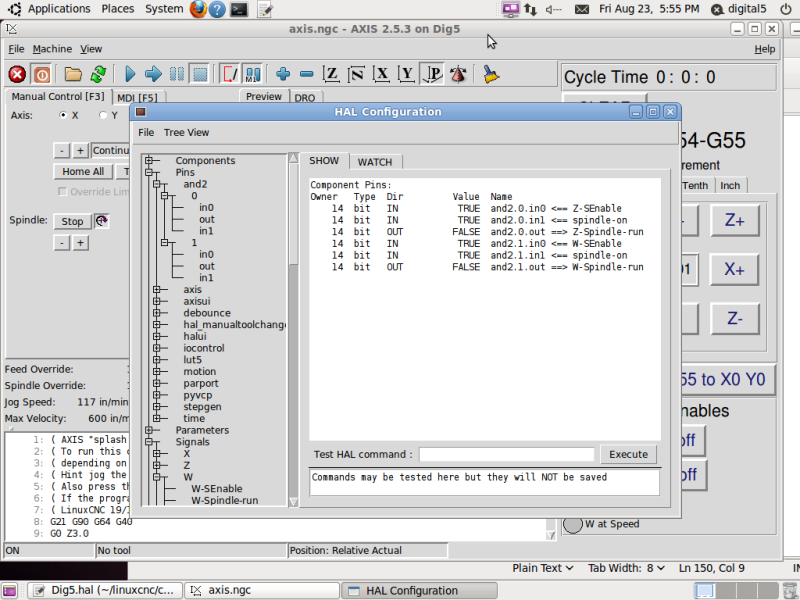

What am I doing wrong. Both inputs to the and2 are reading true (according to HAL Configuration), but the ouput is false.

Duh, I forgot to put in the addf and2.N servo-thread lines.
