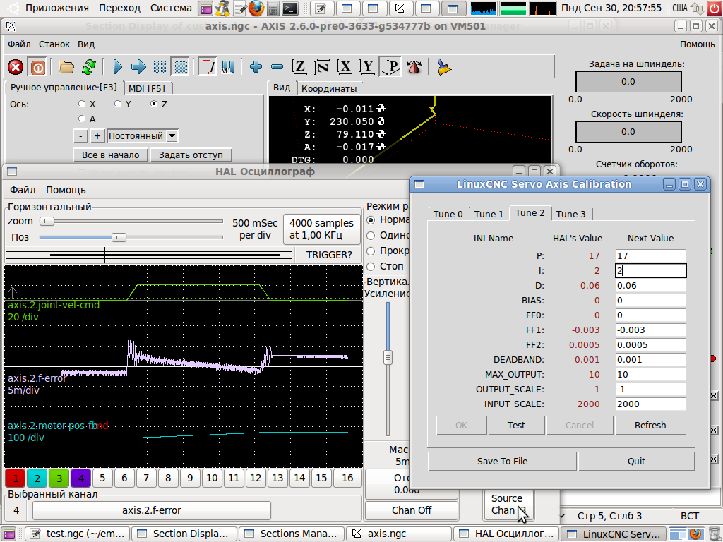

I'm trying to tune PID for my servos (mill 1.5 tones).
And I have noticed that following error on graph is near zero only then it's mooving, after that it became ±0.1mm of desired position.
For example, when i perform in MDI-mode: G0 Y215, when it stops, i will have real value 215.075.
Maybe it's ok, when axis is not in use??
But! I always have FOLLOWING ERROR when jogging, if MIN_FERROR in my .ini file is less 0.5mm!
I have encoders with 2000 impulses on 1mm, so i expected to have teoretical accuracy ~0.005mm or less on my servos....
What am I doing wrong?

- machete
- Posts: 64

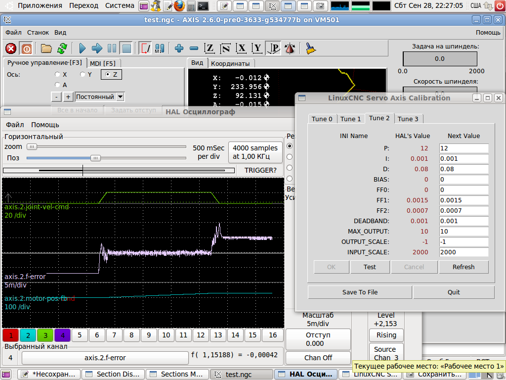

29 Sep 2013 06:21 #39338
by machete
Replied by machete on topic Can't set MIN_FERROR less than 0.5mm..
- Posts: 19151
- Thank you received: 5291
29 Sep 2013 10:02 #39339
Replied by PCW on topic Can't set MIN_FERROR less than 0.5mm..
If you have oscillations you may need to decrease P/D a bit
I would increase the I term until you can see it pull in the
static error in a small fraction of a second
You seen to be within about +-10 U which is not bad
but more integral term should help with the static error
Consider that your static error (~5u) is about 1/200 of full output scale.
This error is multiplied by your I term of .001 and summed every servo thread
(asumming 1 KHz) If the error did not change, it would take 200 seconds
for the 5u error to add up to full output drive. So you need quite a bit more
I term for the integral term to be more responsive.

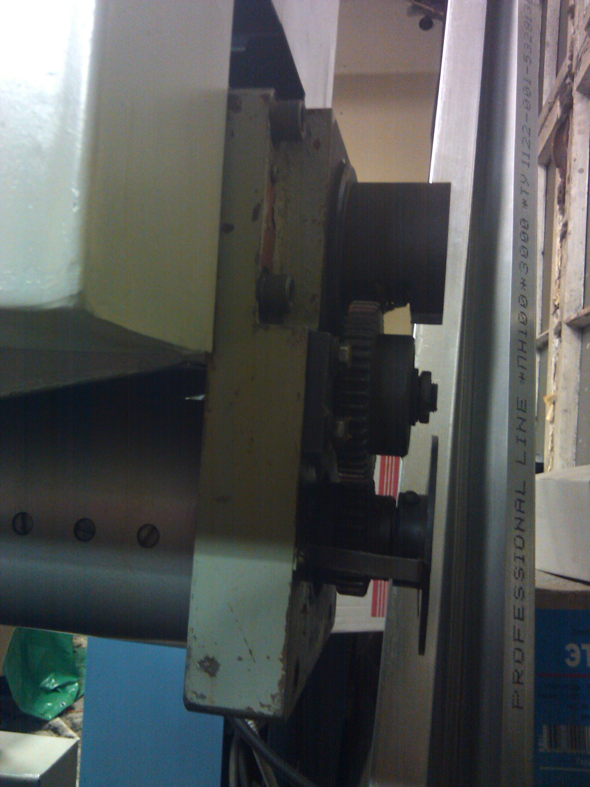

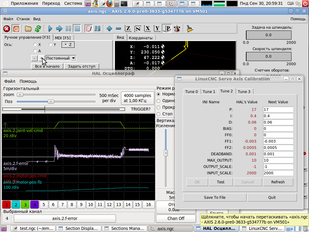

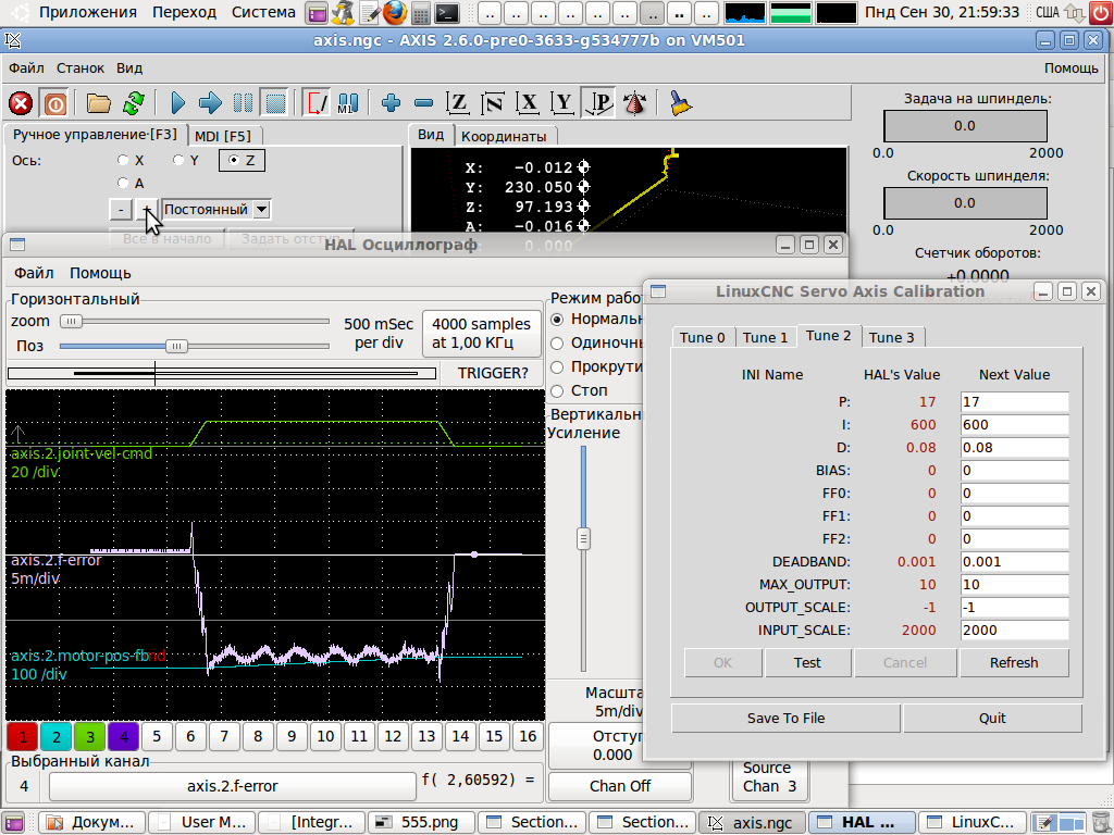

I have tested different I terms - from 0.4 up to 600(!):
But any way one of 3-5 moves i have oscilation: sound and small vibration of motor body.
And.. sorry: i should tell you that my motor is connected through a gear (but the encoder is attached directly to the motor shaft!):
I was thinking it is only important to the final axis accuracy (not for motor).
I'm stuck...
I'm stuck...
Last edit: 01 Oct 2013 02:29 by machete.
- Posts: 19151
01 Oct 2013 02:49 #39420
OK Notice how the I term of 600 has eliminated the static error?
thats mainly what its for... (even 600 may be too low, too much will result is large slow oscillations)
When any significant I term is used, you may have to set the
pid.N.error-previous-target bit true on the PID loop to avoid
getting the velocity dependent error that you see in the last plot
If you cannot reduce your following error any further with tuning, you might
try speeding up the servo thread a bit (to 2 KHZ or even 4 KHz if your system can manage it)
If your gears have any significant backlash this may cause some tuning difficulties
(Since motors intertial load may change suddenly)

01 Oct 2013 05:41 #39424
by machete
Actually i almost satisfied with my following error, even from first picture (sure, i'll try to make it even lower).
Thing that i don't know how to deal with, is oscillation in static. Do you mean, I term higher than 600 can help me with that?
I don't think so, especially when axis in static.
