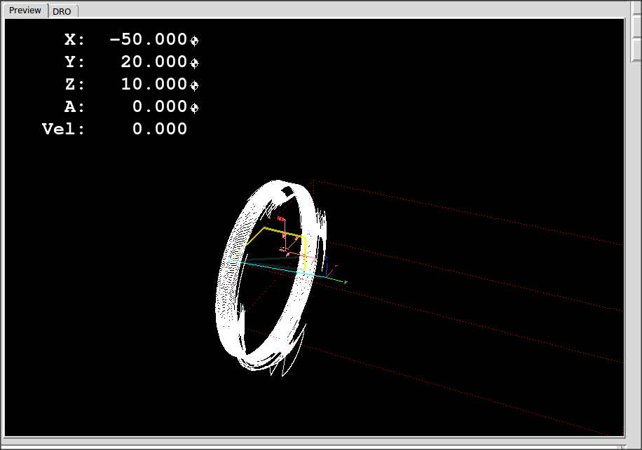

Is it possible to make AXIS to draw 4th axis toolpaths around offset coordinates rather than around absolute YZ zero?
At the moment I have the following in .ini:
[DISPLAY]
GEOMETRY = AXYZ
[TRAJ]
AXES = 4
COORDINATES = A X Y Z
When I jog A axis it always moves around the absolute Y and Z zero coordinates rather then around Y and Z zero coordinates set with touchoff or G92.
My rotary axis is not fixed to the machine so whenever I install it on the machine the absolute Y position is different so unless I change absolute Y zero in .ini every time the toolpaths are not displayed correctly. Toolpaths look like this:

The problem is that there is no way for Axis to know where you want the centre of rotation to be.
If you want to preview machine movement then you could consider setting up a Vismach model of your specific machine. But that is a fair bit of work.

Not necessarily. Consider the situation where the centre of rotation is at the machine zero, but the touch-off is to the surface of the work (engraving on the surface of a cylinder, for example).
The centre of rotation will always be machine zero on some machines, it may be relative zero on some others, and an many it will be neither.

As far as I know there is no solution.
It isn't a huge problem in some ways, you can still use the preview to see what is going on, it just won't necessarily be scaled correctly.
