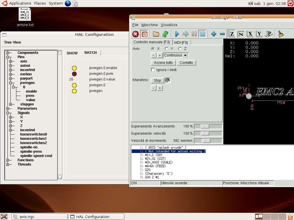

Hello I hope that now is running wheel. In the picture enc you can see the module running and after i go to post the hal file.

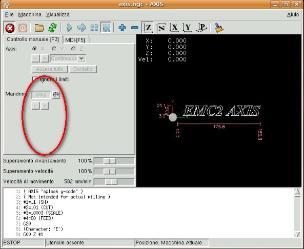

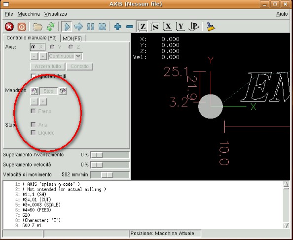

On the other picture you can see on the startup the configuration change for the loading (emc2) to the end of load (emc1) why ??
And last one question is possible control the spindle speed with a bar like the velocity? I try to do my best but I new so you need to be patient

[quote="sandro_cnc" post=39927On the other picture you can see on the startup the configuration change for the loading (emc2) to the end of load (emc1) why ??[/quote]
I am not sure what you are asking, but if it is why the spindle controls are greyed-out, it is because the machine is turned off.
You can only control something with one thing at a time in LinuxCNC. SO you can control the spindle _either_ with a slider, or with the spindle speed controls.
If you _really_ want to, you can set up a pyvcp or gladevcp panel with a slider and a checkbox to enable the slider, then use a mux2 in HAL to choose between the two methods on the basis of the checkbox.

1)Now with the HAL configuration post before the EMC is running. when the program is loading is visible in the red circle on the picture emc2.jpg other choice like Aria , Liquido in light grey and when the program is load in the emc1.jpg don't appear, i have wrong something in the configuration or is normal?
2) In the picture emc.jpg i have try to test the pwm and something is running i hope well if i use the the button + or - the value that in the picture is 26 increase or decease i have try the oscilloscope but I'm not so expert so maybe i have wrong some setting.
It is normal. Axis hides any controls that don't do anything. If your hal file contained (for example) "net coolant-flood iocontrol.0.coolant-flood" then the controls would stay there.
If you are using the Halscope oscilloscope then you would need to look at the pwmgen.0.pwm pin, and the Halscope would need to be sampling in the base thread.
If you are using a real oscilloscope, then you need to have the pwmgen.0.pwm pin connected to a parallel port pin (if the oscilloscope is connected to a parallal port pin).
