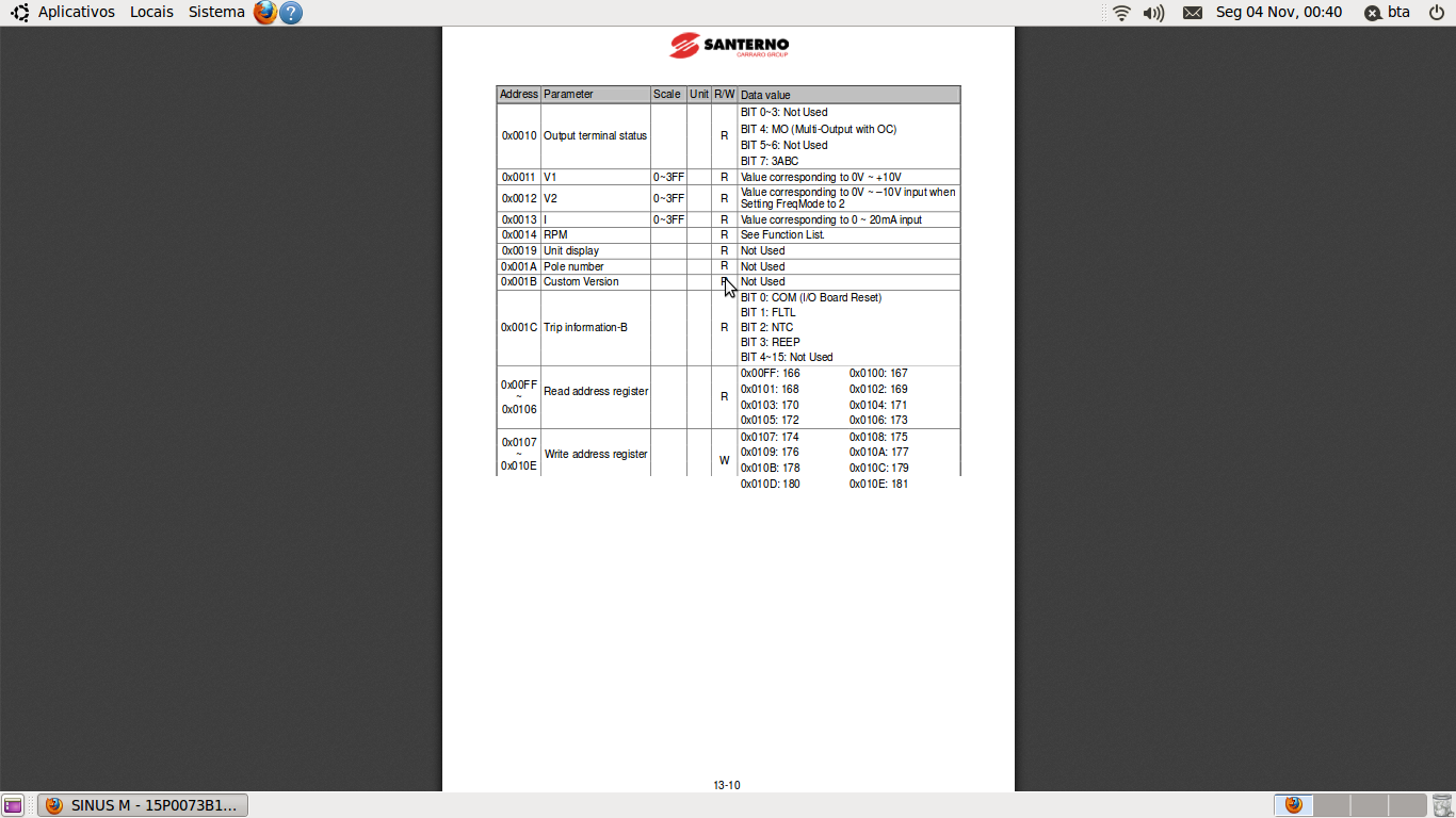

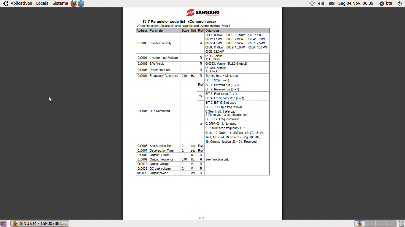

- Posts: 23496
- Thank you received: 4995
04 Nov 2013 19:59 #40536
Replied by andypugh on topic modbus
That's quite a machine.
Looking at the data sheet, I don't see a Write address for output frequency.
None of the existing Modbus VFD drivers seem to have the same register mapping, so you will either need to modify and recompile an existing component, or use the mb2hal component
I think using mb2hal is the easier approach, but you would need to move to the development (master) version of LinuxCNC.
The mb2hal code isn't particularly clearly documented at the moment. This seems to be it:
git.linuxcnc.org/gitweb?p=linuxcnc.git;a...d00fdeffbd48;hb=HEAD
And here in the Wiki: wiki.linuxcnc.org/cgi-bin/wiki.pl?ModbusToHal
The Wiki page says that you need to compile LinuxCNC from source to run Master, but that isn't true, you can get it as a pre-compiled vesion by following the instructions at buildbot.linuxcnc.org
Be aware that you will be using the unreleased development version of LinuxCNC in this case, and bugs may exist.

- btaindustrial
- Posts: 6
04 Nov 2013 23:53 #40539
by btaindustrial
Replied by btaindustrial on topic modbus
Adress is 0x0004 frequency reference
ok?
- Posts: 23496
06 Nov 2013 00:54 #40555
It says that that is a Read address.
Adress is 0x0004 frequency referenceLooking at the data sheet, I don't see a Write address for output frequency.
The following user(s) said Thank You: btaindustrial

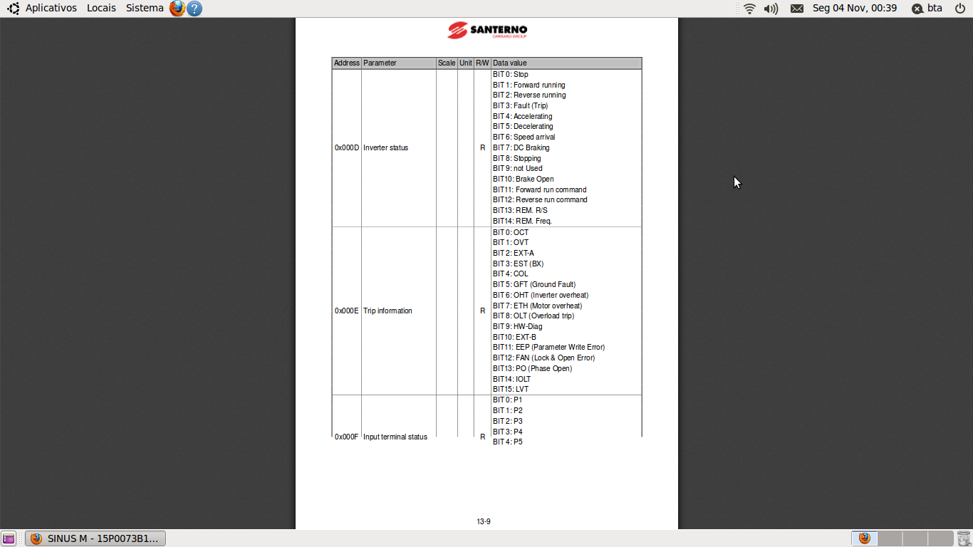

- btaindustrial
- Posts: 6
21 Nov 2013 20:16 - 22 Nov 2013 00:52 #41079
by btaindustrial
hello
I did a serial communication with python, it works!
but i dont know how to make it interact with the linuxcnc
how do I get it to work with linuxcnc
example:
to enter the MDI "m3 sxxx"
take the value of "s" should be passed to the python
python and make communication with the VFD
#! /usr/bin/python
import linuxcnc
import minimalmodbus
vfd_sinus = minimalmodbus.Instrument('/dev/ttyS0', 1)
s = linuxcnc.stat()
s.poll()
#spindle speed
if s.spindle_speed < 0:
set_rpm = ((s.spindle_speed**-1)/0.30)
else :
set_rpm = (s.spindle_speed/0.30)
vfd_sinus.write_register(4, set_rpm, 0)
# on/off spindle
onoff = vfd_sinus.read_register(5, 0)
bin_onoff = bin(onoff)
spindle_cmd = s.mcodes[2]
if spindle_cmd == 3 :
set_onoff = int(bin_onoff[2:12] + '0' + '1'+ '0', 2)
if spindle_cmd == 4 :
set_onoff = int(bin_onoff[2:12] + '1' + '0'+ '0', 2)
if spindle_cmd == 5 :
set_onoff = int(bin_onoff[2:12] + '0' + '0'+ '1', 2)
vfd_sinus.write_register(5, set_onoff, 0)
