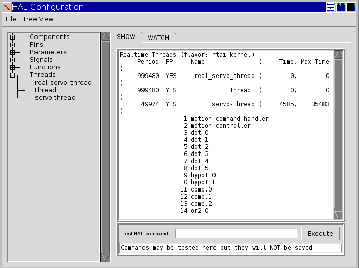

05 Nov 2013 23:25 - 05 Nov 2013 23:28 #40554 by ArcEye
Hi
You can create multiple threads, the restriction is that they have to be created in order from fastest to slowest.
www.linuxcnc.org/docs/devel/html/man/man9/threads.9.html
If you keep your hal and ini files as they are, you may have to play games by specifying the servo thread rate as the 100K you want and then create a third real_servo_thread and substitute this for all the original references to servo_thread.
This is because motmod has already created 2 threads at the start of the hal file and the names are hard coded, so you can't add to the EMCMOT line
ini file
BASE_PERIOD = 50000
# Servo task period, in nano-seconds
SERVO_PERIOD = 70000
hal file
loadrt [EMCMOT]EMCMOT base_period_nsec=[EMCMOT]BASE_PERIOD servo_period_nsec=[EMCMOT]SERVO_PERIOD num_joints=[TRAJ]AXES
loadrt threads name3=real_servo_thread period3=1000000 fp3=1
results
This was done in a sim, so the only thread that actually gets created is the servo-thread, but you get the picture.
regards
Last edit: 05 Nov 2013 23:28 by ArcEye.
