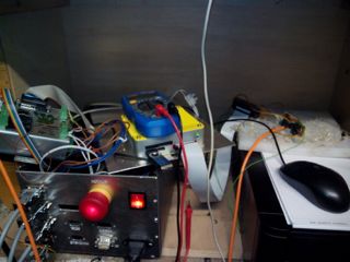

i spent now several Days to get Spindle Orientation running on an NCBox with Andys image (linuxcnc 8.04)
i compiled an 2.6pre and everything is normal but N19 doesn't work.
So i read all the stuff i could find and the configs simply did not start the motor
Question 1 ) is it the case that i need an Encoder on the spindle with A,B and Index ???
I only (see picture ) have one Hall sensor which works.
So i then found mr haberler style and used his ngc files as starting point.
Then i tried to REMAP M19 so it gave me an unknown m code ,..
i moved then to M419 and it used the file ,..
And i finally got an Version working using Remap on an NGC file and use of several M66 E xx functions Video is like
So i could be happy and proceed with Toolchanger on the carousel but my question
How to do it right ? Are there several Paths to it ?
like orient module
motion pins and the ngc style ?
So if anyone has an hint please
i also ad the fotos to see my test situation
enjoy
thomas
There you see my test environment with
NCBOX Triple Beast my enclosure the cabling the PCB i build driving the NPN Switch
This is the inside of the head where you can see the Metal part for index and the switch (which is from an Bridgeport 412

M19 is a working M-code in 2.6. You shouldn't need to remap it.
www.linuxcnc.org/docs/devel/html/gcode/m-code.html#sec:M19
All that it does is output an orient request and angle on HAL pins, and wait for a "complete" status.
You would need to use these HAL pins to make your spindle rotate. I think that you can probably do this fairly simply with a "mux2" hal component and an and2.
The and2 is set up so that it is true if motion.spindle-orient is true and the position switch is false. Then that output switches the mux2 between passing the spindle speed request to the spindle drive or a fixed value that is just enough to rotate the spindle slowly.
I could write some HAL code, but I have no way to test it, and there may be quirks I have missed.
There is a dedicated spindle-orient HAL function, but I don't think it is much help to you. www.linuxcnc.org/docs/devel/html/man/man9/orient.9.html

Thank you for the fast answer that is so cool
i can develop but i have never used mux2 and and2 i ´ll read that up and give it a try
if it works i am happy to write down an how to
Do you have in your files some example i can use as an start
(i thought the reason of my M error is because M19 is already known
I used an S100 M3 to rotate that worked verry accurate (because of the heavy spindle)
and the bridgeport 412 has a brake as well so
thx
thomas
